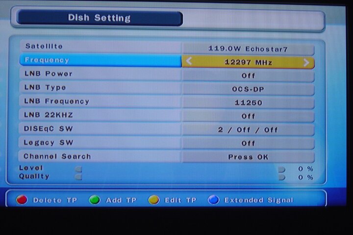

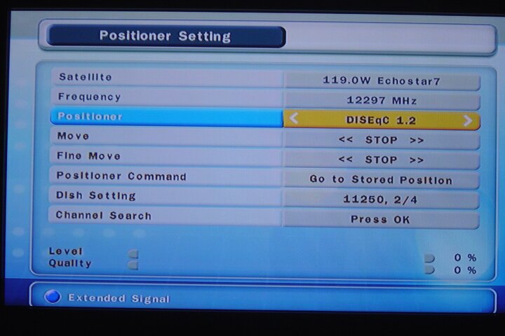

The setting i'm trying to use is not working.
The equipment i'm using is Coolsat 7000, Coolsat Diseqc sw 4x1, Pansat PM900 Motor, Invacom QPH-31 LNB (dual LNB) and 30" Dish.
My dish is already set on Satellite 119 w Echostar, When I disconnect the Diseqc sw 4x1 and the motor and connect straight to one side of the LNB I received Sat. 119w Channels. Can you please help me with correct receiver setting.
Also I attached pictures of my settings.
I have the lnb turn off when I turn it on the Coolsat 7000 turns off.

Also, your coax should run from the receiver to the motor, and from the motor to the Diseqc Switch, and from the Diseqc Switch to the LNBF.
Don't know why your Coolsat would turn off when you have the "LNB Power" switched "On"?

LNB Type is wrong...should be single
what channels are you getting on 119? Not much free stuff there. Nasa, Angel One and a couple preview channels
I have tried using single lnb type, when I turn the lnb power on the receiver powers down.
