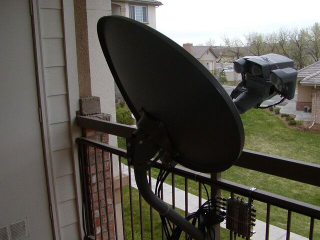

(1) A little after Team Summit ended, I believe Scott posted a thread from another site, or something, which showed how someone obtained the LNBF assembly for the 500+/1000+, possibly by buying the whole dish. He then modified the arm, or some other bracket by drilling holes in different locations which changes the focal of the LNBF cluster, when attaching it to the SuperDish 121. This provided him with the 110/118.7/119/129 orbital locations, and using the largest of the Dish dishes.
(2) Or you can go even easier than than. Well before Team Summit, I knew there was going to be a 4 orbital location dish coming out, but did not know which birds. While waiting to find out what new toys would be available, I bought a DP Dual LNBF and I-Bracket and duct taped it to the side of my SuperDish 121. Just before taping, I held it against the side of the shroud (121 side) and moved it to find the best signal. I then taped it.
---I could use spaces for a slightly better signal, but not worth the time.
---The duct tape may need tightening every 6 weeks.
If the Repoint Kit is not available soon, I will either buy a Dish 500+ and use my extra DP Dual LNBF to make it a 1000+, or cut me a couple of pieces of rectangle pipe (arm from a Dish or DirecTV) and make a permanent bracket.
Here's the picture.
