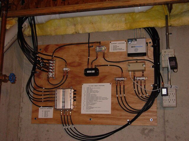

I installed four coax each to three primary locations that have DVRs. One coax for tuner 1 & 2, one for OTA antenna, one for agile modulated in, and one for agile modulated out. This way all three primary locations can receive and transmit to all other positions in my home. This is a little over kill but I didn't want to have to use diplexers. Also, all three positions have CAT 5E installed with three Cisco switches for SlingBox and connecting the DVRs to the Internet. Also, telephone wire is at each location for on screen caller ID. To the satellites I ran six (3 duals) coax. But, I am pointing at six birds. Doesn't hurt to have extra for future addition of satellites. Here is a pic of my head-end. It is a nightmare but I couldn't install a cabinet because older coax weren't long enough. They went to the 2nd floor in a two story house and didn't want to deal with replacing them. Be sure and think of all these things you may have for your primary locations.

Charlesrshell....
you're headend is awesome! I'm jealous as sh*t of your set-up; I'm getting ready to move into a new house and all it has is one run of RG6 to each room. I wish I had your set-up; I'm afraid that adding that on to a brand new house would cost a boatload of cash.
you're head-end is awesome! I'm jealous as sh*t of your set-up; I'm getting ready to move into a new house and all it has is one run of RG6 to each room. I wish I had your set-up; I'm afraid that adding that on to a brand new house would cost a boatload of cash.
Well, sullivbt maybe you can install more cable before you move in. If you haven't closed yet maybe the funds to do it all can be added into closing cost. Keep in mine too that the living room, master bedroom, and some other areas may need two connecting locations. Just offering some ideas to help. If I was building a new home I would do what Vegassatellite and AllieVi have suggested. Run with structured cable and conduit to all TV/telephone/network areas. I would have in all conduit four coax and fiber cable for telephone and network. At the head-in I would have two huge enclosure cabinets. One for coax and one for the fiber cable and all the required switches, connecting blocks, etc. The house would be ready for the future. And I will never ever live in a two story home again.

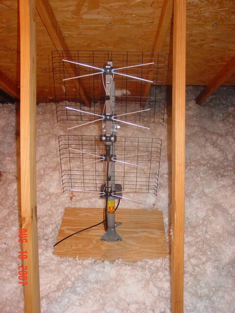

Also, Vegassatellite has an excellent idea running conduit to the attic and install a #10 AWG ground wire to the intended dish location. My wife and I played hell snaking a coax to the attic for the OTA antenna. A conduit would have been awesome. Also, I sure wish I had that ground wire to the satellite antenna location. My dishes are on the opposite side of the house from the ground rod.
