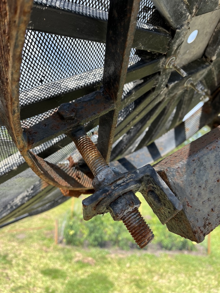

Alright, I've set the pole and letting the concrete cure. I've started taking a harder look at the polar mount on this dish, and I'm a little concerned. The "top" pivot attachment point is a bent plate (I should have looked harder before we took the dish down...), the "bottom" pivot point doesn't attach to anything... I've attached pictures. The actuator was attached to the dish, I took it off before I loaded into the truck. It kinda looks like it was just the top pivot point and the actuator holding the dish there. I don't believe I've broken anything (well actually the actuator "eye" bolt broke off but I'll get to that later).
This dish also doesn't appear to have a clear declination adjustment. Thankfully, I only moved it 1/2 mile but any ideas here? I was going to start out with it as a fixed dish anyway, but the bottom L bracket with the bolt (that looks broke off, and is on the right side of the pics) has me a little worried. My (limited) understanding with polar mounts is that there's two points of support for rotation, and a third to stabilize (actuator). Also, I don't see any markings on the dish but the LNB says Channelmaster. Any ideas?
Yes, the bent plate should normally not be bent. :-(
The bottom L bracket would be part of the declination adjustment, and is connected to the bottom of the pivot/axis; but the part that connects the (adjustable) declination offset bolt to the dish I cannot easily see on your pictures.
The fact that it seems to be missing, looks like the cause of the bent plate.
You are right about the three points.
Repairing would be a challenge. Alas, my expertise doesn't lie there. I hope others jump in.

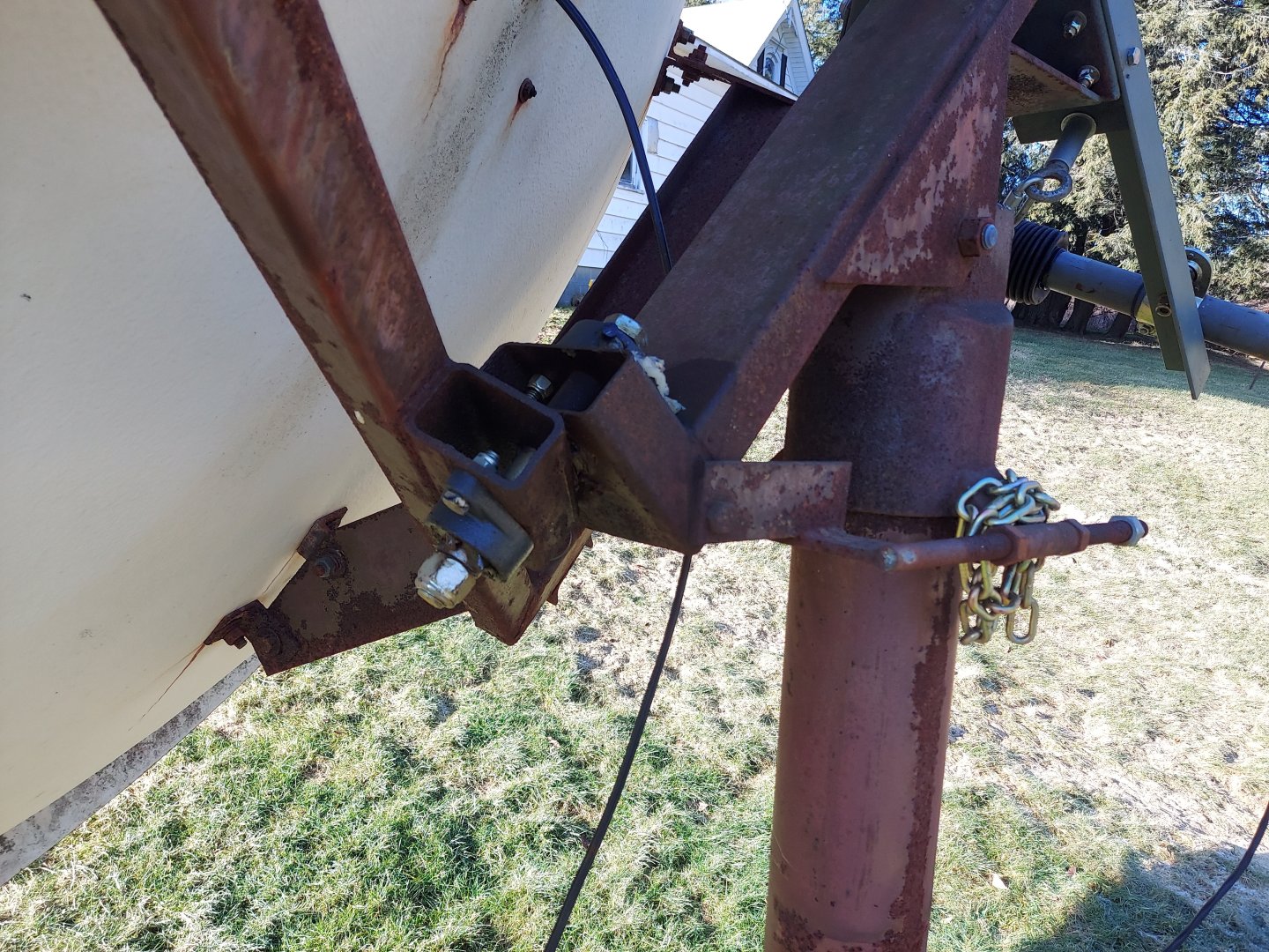

You can see example L-bracket declination constructions in these posts:
1. fixed to the dish ring:
2.with a "pivot" to the dish ring:
On some dishes the adjustable L-bracket is at the bottom, on some it is at the top. Makes no difference.
Does this help?
Greetz,
A33
Reactions: FTA4PA and arlo
Does this help?
Greetz,
A33
This helps tremendously actually. I've got some work to do with it then, I'll take the pole mount off, straighten the plate, and figure out the bottom bracket situation. Thanks

.... and figure out the bottom bracket situation.
Good plan! :cool:
Remember that the declination offset angle for 36.35North (Johnson city) would be between 5.2 (modified motor angles) and 5.8 (traditional angles) degrees; dish leaning forward.

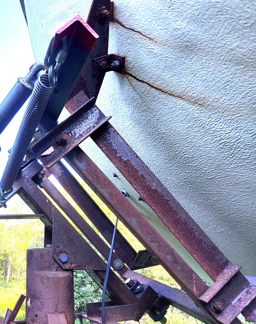

Location of the dec. adjustment doesn't really matter. As long as there is one and you're able to get the polar angle (latiude angle) and face of the dish parrallel and pivots vertically level.
For an example here is my locally fabricated polar mount.
The twin elevation adjustment rods allows for slight adjustment if the pole and pivots aren't perfectly level, or straight up and down in relation to the ground and sky.
Declination setting is provided by the slots seen in the frame by the spring.
Same, but different. Old photos. Rust is gone and killed and all painted now. Probably time to give the pillow blocks and actuator tube a squirt of grease.
