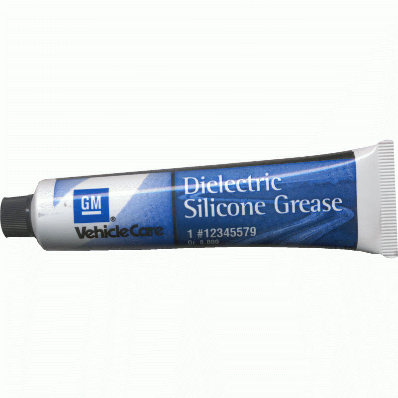

I use silicone dielectric grease for my outdoor connections (available at your friendly GM dealer):

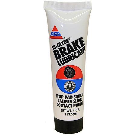

And when that little expensive tube runs out, I'll switch over to this big tube (any auto parts store should have it):
