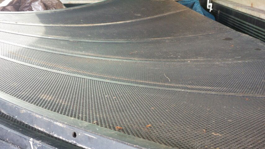

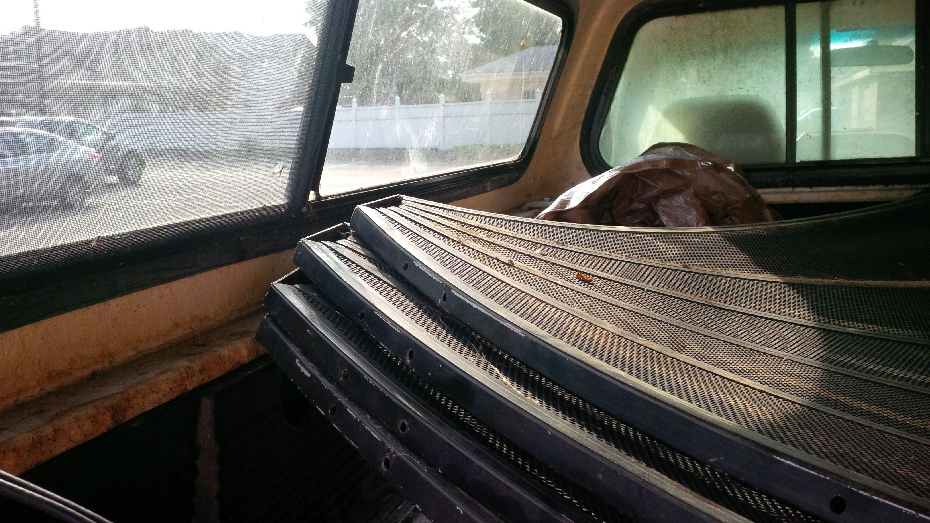

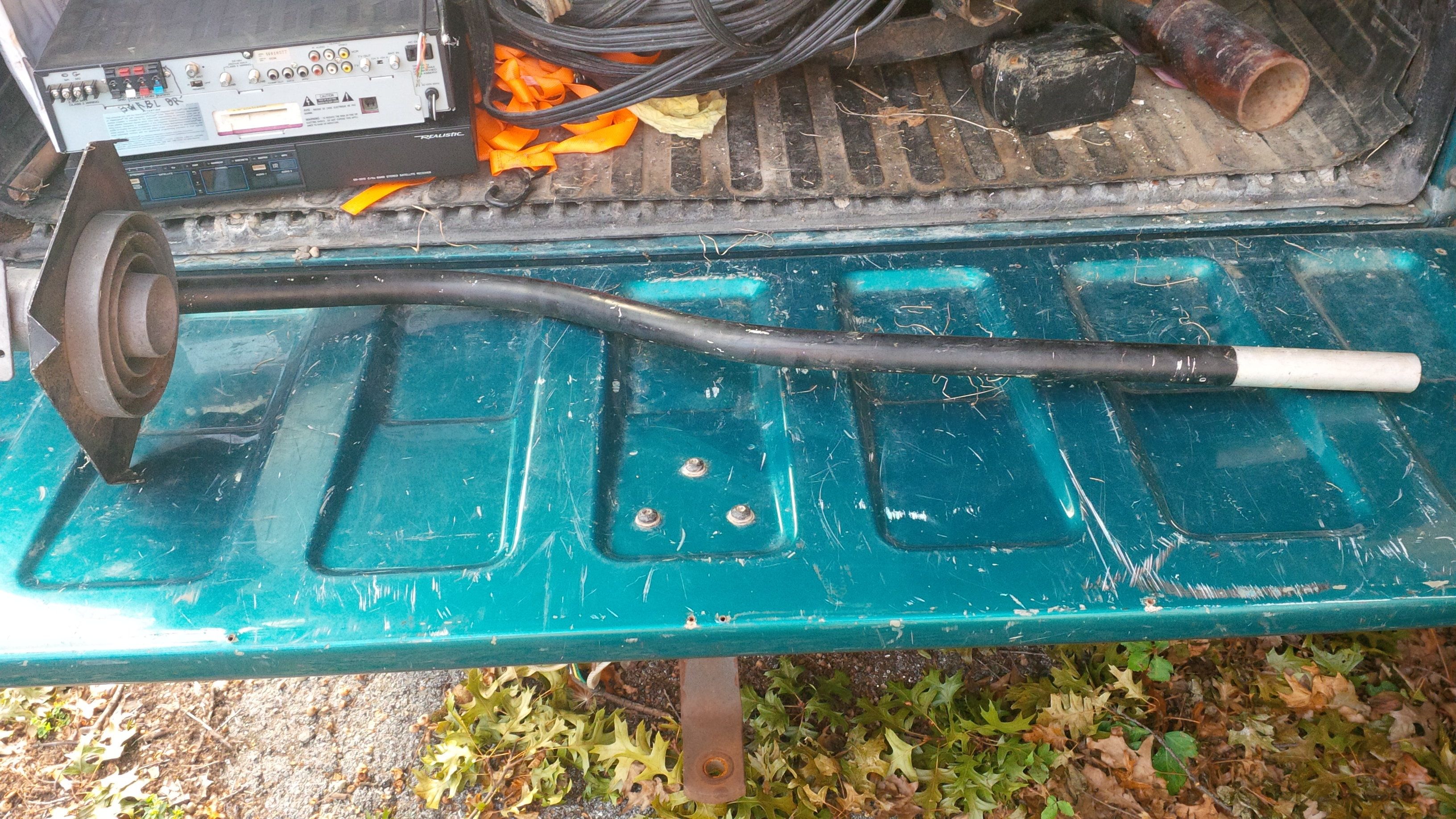

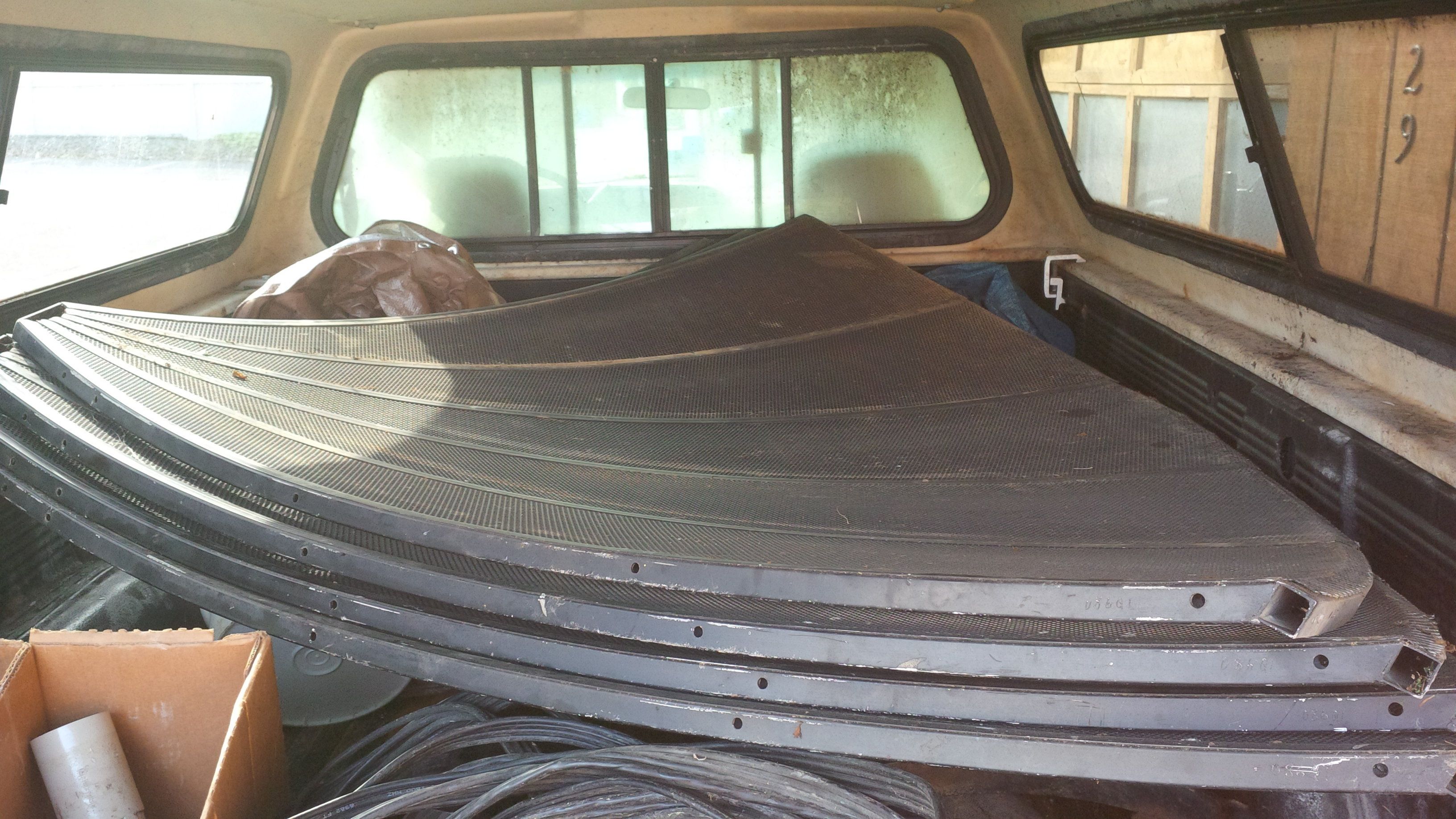

Does anyone know where I might be able to pickup a mounting plate (not sure what they are called) for a button hook on a 10' mesh dish? I realize there are likely a large variety of possibilities. Would it be easier to have on fabricated than to locate one? I can post some pictures of the dish if necessary. It isn't installed yet and I was thinking I could have my father in law fabricate a mount or I would just use some EMT to convert the dish. Not sure which method would yield better results.
Dish Identification and options for mounting the LNB:
IMG_20140918_091935.jpg IMG_20140918_091945.jpg IMG_20140918_091930.jpg IMG_20140918_091923.jpg
These are from shortly after pickup. I was going to plant the pole last weekend but it rained on Saturday.

A tube, that is a slip fit over the buttonhook tube, welded to a plate* that's bolted to the center of the dish. 2 holes with nuts welded onto it(the tube) to hold the buttonhook tube but allow focal length adjustment. *3 or 4 gussets for stiffness. (Exact measurements you'll have to determine)

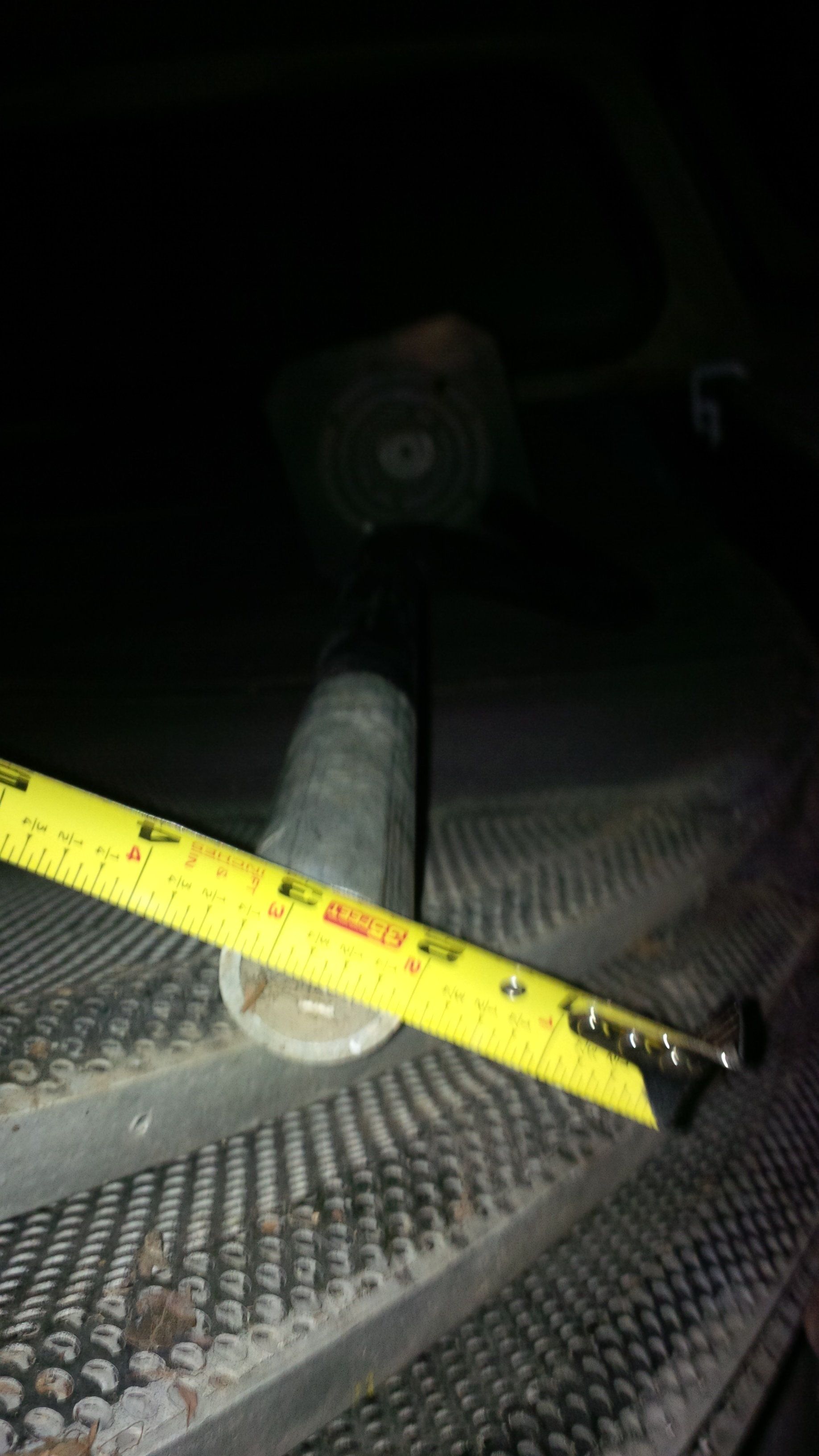

That is a definite plan. The OD of the tube is 1 3/8". That is with a tape measure. I'll look for my micrometer to get a better read in case fabrication is in order.

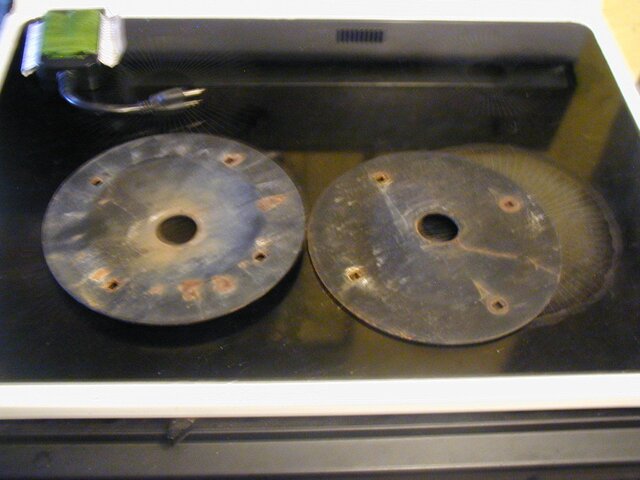

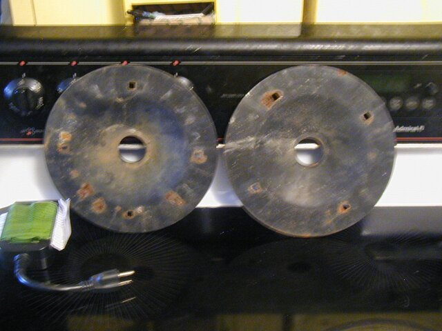

these are the plates that I have. The pictures are a bit fuzzy, but should be good enough. The O.D. of the plates is nine and a half inches and the hole in the middle looks to be an inch and a half. It shouldn't be more than a few bucks for me to ship them to you I'd think, if they might be something that would work.
I think that will work. I will take a look when i get home tonight on the measurements and let you know. Thank you for checking.

I have the plates for the buttonhook (Thanks A Raine) but the center hole is a bit larger in diameter than the diameter of my buttonhook pole. I was planning to just use a sleeve to beef up the post to the proper diameter. I started out looking at aluminum but couldn't find the 1.5 OD, 1 3/8 ID that I needed readily available. I did see that there is polycarbonate tubing that meets those exact requirements. I've seen the stress tests on that stuff and it looks really impressive. It is just to support the buttonhook and LNB so I don't know how much force I am really concerned about here. Does anyone know of an alternative solution? I'm out $10 if it fails to produce the results I want but if there is a better option I'm willing to go with it.

How about this? It's 1.5"OD x 1.370" ID (only .005" smaller than 1 3/8" ID) and available cut to exact length you need): http://www.speedymetals.com/pc-4575-8371-1-12-od-x-065-wall-tube-6061-t6-aluminum.aspx
I saw that. I was worried that the ID wouldn't allow me to slide it over the current pole. They have a warning on the site about making sure the diameter is is a little larger if you plan to telescope the pipe. I ordered stuff from them for my CNC machine. I might give it a try. It isn't too expensive.
