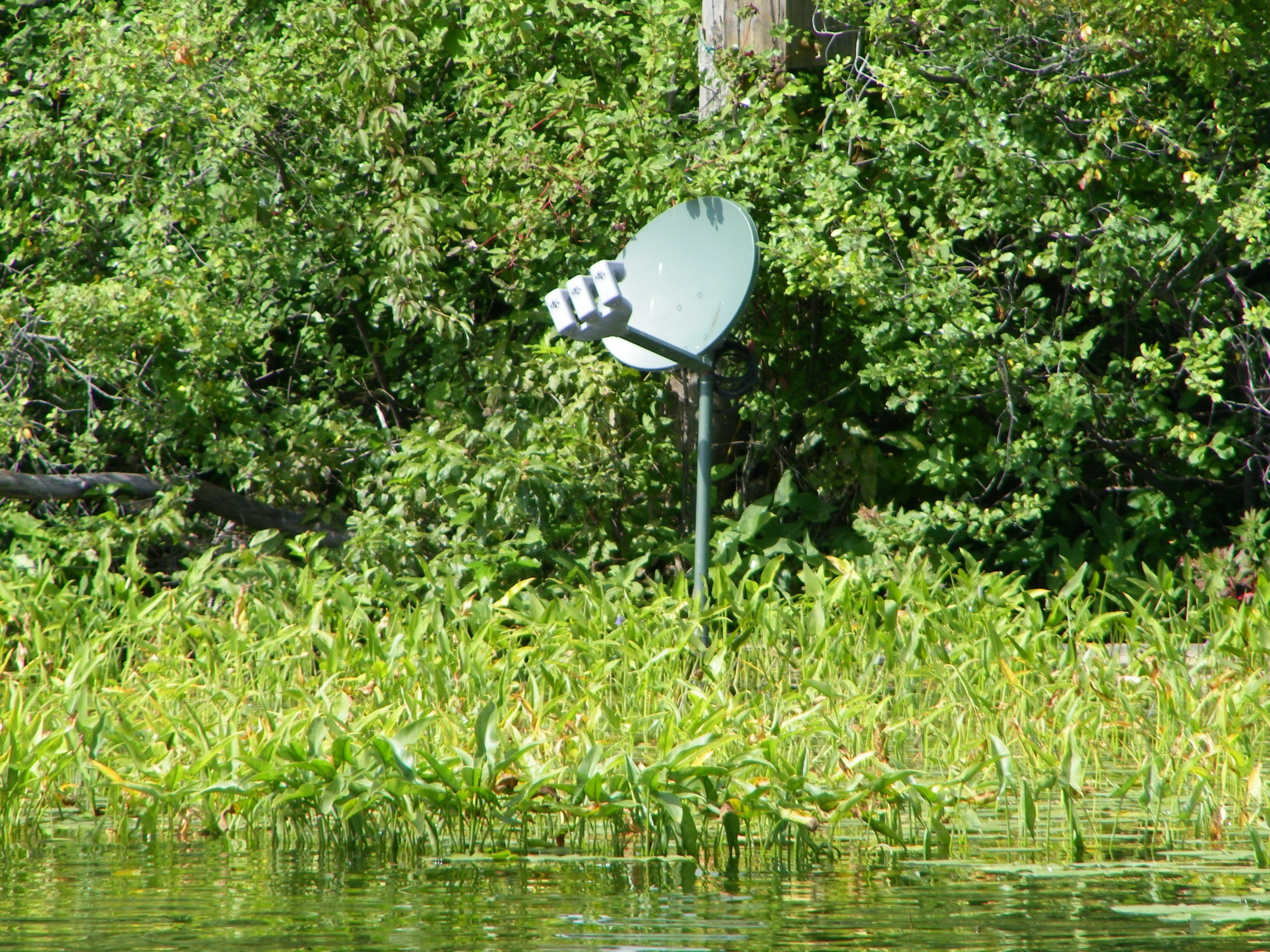

102_0023.JPGmy cottage install has a 450' run of rg6 copper clad coax connected to a dish 1000.2 with 3 single dp lnbs and a dpp44 mounted at the dish. the dish is installed on the island across from mine with the flooded cable on the bottom of the lake.....did not think the distance was that far, but the foot markings on the cable confirmed that.....
not a ideal installation I know, but it has been working fine for the last 2 years connected to my 722k.....signal levels are about 10 points lower at receiver then they are at the dish......
point being that long cable runs do indeed work as I have had no issues with this set-up..,..GL
originally I used the lnb that came with the dish 1000.2 but my receiver seemed to be running a little hotter then usual (maybe not though) and I did not want to take a chance of burning out the receivers power supply, so I switched to the dpp44 set up......
