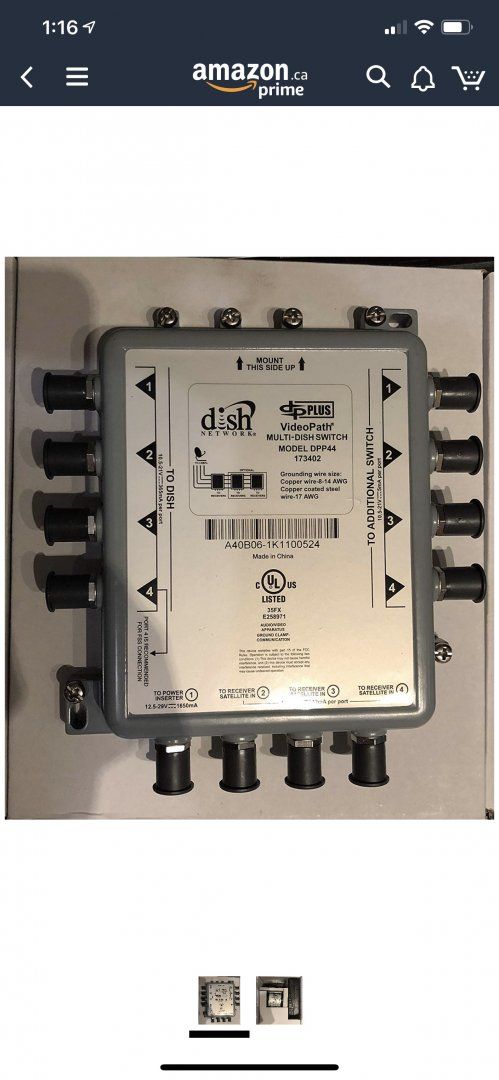

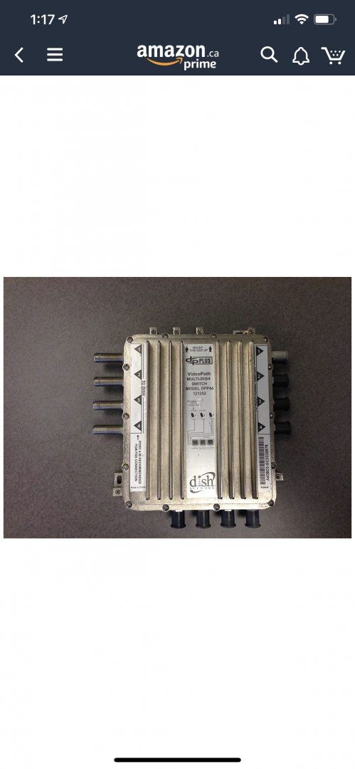

I've purchased two Bell 9500's which should be delivered to my Canadian address by Friday. I'm going to be using them here in ND and want to buy the right switches. I'm already running a DPP44 but I will need another one. I see two listed on amazon that are the same yet different. Does anyone know what the difference is?
Cooling fins, dimensions and the bulkhead connectors (extended length) on the inputs. The one with fins is almost certainly used and probably doesn't include a power inserter.
The PI was a common failure point in the older DPP44 units.
