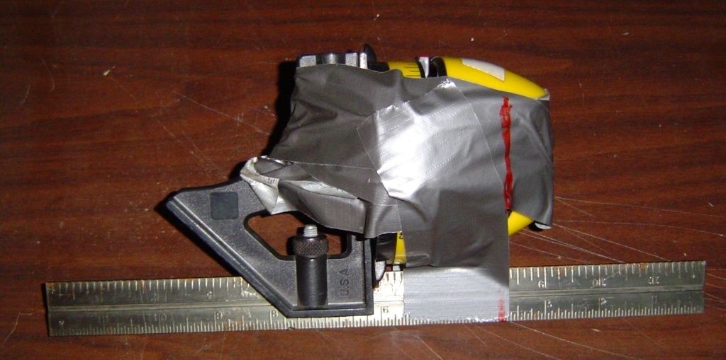

Also here is a pic of the tool I made to line up the wave-guide. It ain't pretty, but it works great.
You can see the white tape over the hole in the front. That is there to give me a pin-point beam. The red marker line is to tell me where to line it up in the center of the wave-guide.
On the geosat, I put a little mark in the center of the cap to line up the red line with. With a co-rotor, I just use the probe with the cap off.
When the pin light passes through the center of the dish plate from N/S and E/W, you can rest assured that your are pretty darn close to the center.
