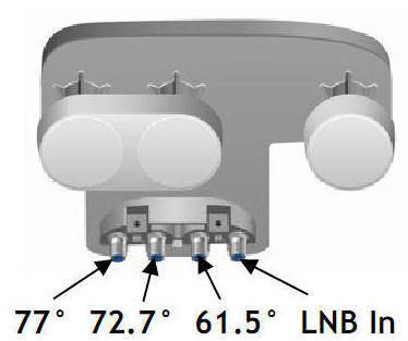

1000.4 Eastern Arc dishes have 2 LNB's close to each other, and 1 away
Here's the 1000.4 EA LNB

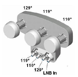

All google images of "Turbo HD" show the 2+1 eyes. The LNB eyes I have are evenly spaced and are supposed to look at 110, 119, 129. The reflector is slightly larger than my older Dish 1000.
