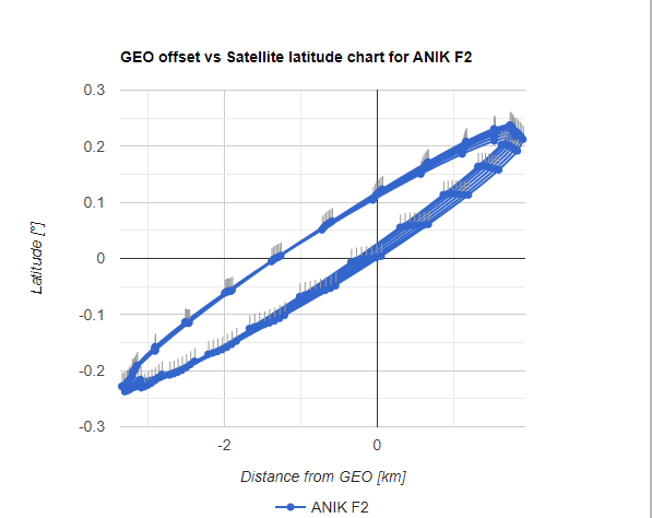

Anik F2 is definitely operating in an inclined orbit.
Source: satellite-calculations.com

From the graphs you provided, it looks like the current cuboid is +/- 0.25 degrees in latitude. Am I reading this wrong?
East/West does not increase much so it becomes more of north/south ellipsoid.
Been reading up on inclined and the North/ South deviation can get quite large as in multiple degrees, if the operator chooses to not control it..
The article says uncontrolled latitude increases 0.8 degree per year.

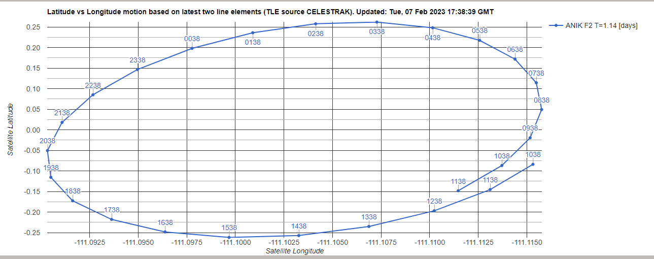

Watching the data for a few days and it looks like ~0.003 degree increase in latitude offset per day. This is consistent with the earlier article post link which estimated 0.8 degree per year
0.023 degrees today.

This graph illustrates the current motion with the offset shown for each hour in a 24 hour period.
If the offset increases so as degrade service in the far northern or southern regions, it would begin with decayed reception twice a day for an hour or two.
