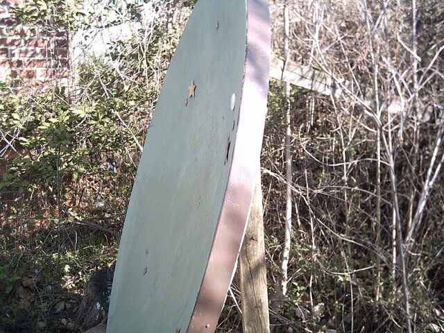

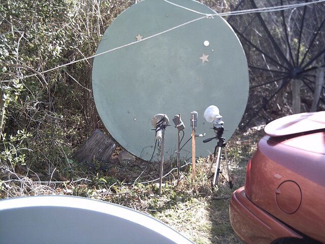

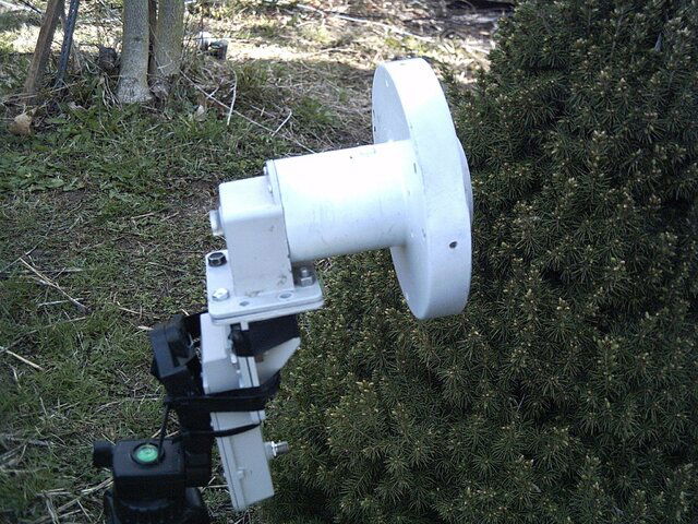

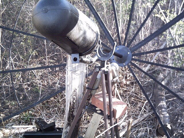

Just got a free Dish Pro dish with 3 lnbfs, one was a Band Stacked FSS unit that I plan to use for PBS on 125 W Ku using 3/4 of a 10 foot center focus mesh -- one panel missing. I get G 18 Equity channels with this setup, though for how long, who knows? Here are pictures of dishes, etc.
Looking at pic #4 I see you have taken the servo motor off and the plastic probe coupler has backed out of the feed housing a bit. I would push it back in and put a piece of tape over it to keep it in place. When tweaking my 1.2 meter AMC 8 dish I did the same thing since I needed only one polarity. Mine backed out like that and when I pushed it back in it brought the quality up 2 or 3 Q's...made a difference.

Iceberg: damn...that 2nd pic is pretty "ghetto"... :D
I agree with Iceberg that is GREAT! Just when you saw it all man! Great job on the rigging! Nice Pictures! Just thought I would buzz in off subject for a sec to say :welcome to The Satellite Guys!
