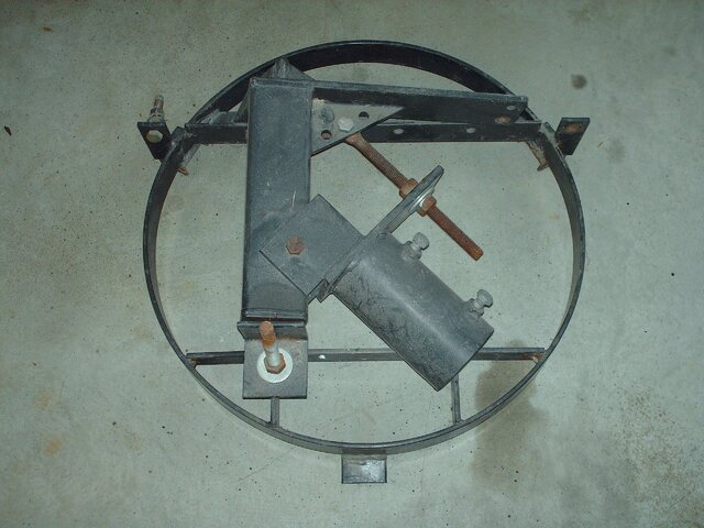

I got him to send me some pictures which are attached. He said the panels measure 4' x 79". Can anyone tell me if it looks like all of the parts are there and if things like the LNB and actuator should still be usable?

Welcome to the site!!!
Yes as far a I can tell from the photos everything is there. Also that LNBF would be usable as well. The old GI receiver would not do much for you. I think there is 5 analog channels left that you could get with it. IF the price isn't to bad I would go snatch it up. Then ask all the questions you need and we will help you get it up and running.

That receiver might work for a dish mover, but without a remote it may not even do that, unless it has east/west buttons on the front panel, I think most do.

Best I can tell from your pictures, it looks fine.
Just remember, rust-resistant stainless bolts will be expensive.
And you'll have to find a pole for it ($).
We have a recent thread on selecting poles, be sure to get the right stuff.

That polar mount is exactly like the one on my SAMI dish. The LNB mount looks the same too. That dish mover looks like the Super Jack my SAMI has on it also. That dish I have is 7.5ft but it does do a fairly good job here in Virginia. I am going to replace it with a 10 footer soon though.

Oh, and I've got one of those already mounted on a post and using it so if you need pictures when you put it together let me know and I'll see what I can do.

The dish looks to be complete, but I'm inclined to agree with phlatwound. I have never used an 8 foot dish myself but from what I have heard around here and on other forums, It may not perform well for the S2 signals (or ku). If you will only have one dish it should be a 10 footer. The receiver will move the dish just fine, but so will a vbox since you don't need a polarity controller with that feedhorn (looks like a bsc 621 for both C and ku band).
