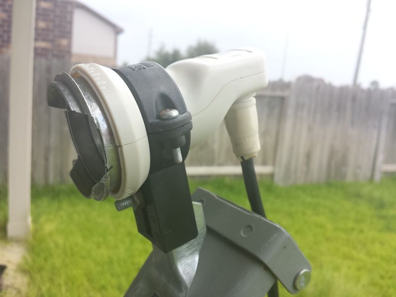

Hello polgyver,
I have modified an LNB with a round field of view for an oval shaped dish (Directv Slimline), see attached photos. Before modification, RT on 97w was 40-41% signal quality, after, it was 52-53%. This is successful enough for me. This is almost as good as my winegard 76cm dish, which gets RT with 57-58%. The winegard number seems low to me, but it does not fade much in the rain, and it is watchable down to 35% signal quality.
This modification was based on intuition and luck, I didn't even measure, just ten minutes with a hack saw to see what happened (I didn't really care if it was a failure because it was a cheap $7 lnb). I simply cut notches in the outermost ring of the scalar, approximating the area where the dish is widest. I know that the LNB now sees the widest bits of the reflector because I can watch signal quality drop when I cover them with my hand, and it didn't do that before. Since this modification, someone posted a link to a document about feed horn and scaler design in the C band forum I think, take a look.
Brian

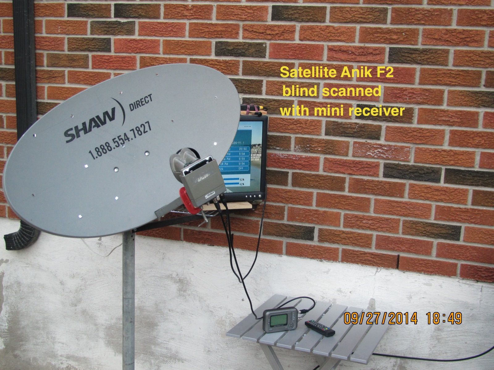

Following Dan's suggestion, I just made flattened "funnel" (oval LNB to oval dish).
Also prepared scalar with some grooves removed (as done by Brian)
Placed plastic ring in front of original Shaw LNBF, for better orientation of substituted other LNBF's.
Planning to compare other scalars to see, which one works best.
Blind scanned Anik F2 (111.1 W) with original Shaw LNBF, and I got 2 channels In The Clear.
Live video of Hamilton Beach, but what's the frequency? 4 digit, is it C-band?
