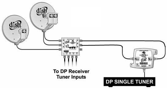

SimpleSimon said:
You mean like this? Anyway, my method is a LOT less expensive - that's it's advantage.
Less expensive sure.....I digress to my earlier statement.....Besides, I'm not concerend about the expense. The customer is paying for the switch or the additional labor for your config....i like neat and clean...i tell each customer that I would not put something on someone elses home that I would not do to my own....Trust me,If a tech came to my house with your idea, I would have to politely decline....
Look, niot trying to start a pissing contest with you here..This is differnce in technique that 's all.......

To each their own - I offer both options, and the advantages & disadvantages of each. Customer picks what they want, and they are right. Most recent situation like that was a D1000 converted to a DP34/DP21 to drive the 625, 811, and pair of 311s. The DP21 is hooked to the trunking outputs of the DP34.

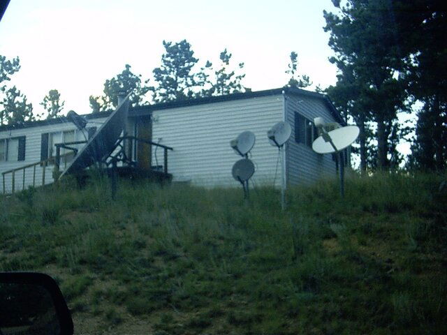

You mean like my neighbor's place? :D BTW, us mountain folk don't consider dishes unattractive. ;)
on the surface, neither do I..But I live and work in the land of HOA's...Now I am well aware that HOA"s have no say in where I place a Dish BUT......Many customers are concerned anyway..i must install with their wishes in mind....
90% of my jobs are Esthetics first, functionality second....Ahhh subrubia....
