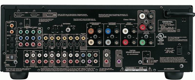

I'm looking at getting a new receiver that can handle the multiple HD sources I now have. I have two devices with HDMI, and at least two more with Component only.
My question is, can a receiver (for this example, I am looking at the Onkyo TX-SR674) that has 2 HDMI labelled as IN1 and IN2 be used for the 2 HDMI sources, and still be able to hook up different Component sources to the IN1 and IN2 Components locations?
In other words, with this unit there are 2 HDMI and 3 Component inputs...can you get up to 5 HD sources or limited to 3 HD sources?
I think the answer to this is only 3 HD sources are supported, but I just wanted to verify...
Thanks for your help.
Anthony

It is highly likely that it is a total of three ONLY, and you can choose to use either HDMI or Cmpt on 1 and 2. NOT all separate for a total of 5. Do you have a pic of the rear jack panel? I can tell from that.
That's what I was thinking...only 3 total HD inputs allowed. Picture of the rear is attached.
I have this exact receiver and on Onkyo, the DVD input is treated seperately if you use HDMI. So you could have 1 DVD HDMI input and 1 more HDMI and 2 component or 1 DVD HDMI and 3 component.
I have my DVD on HDMI In1, my QAM cable box on Component 1 , Xbox 360 on comp 2, vip211 on comp3.
