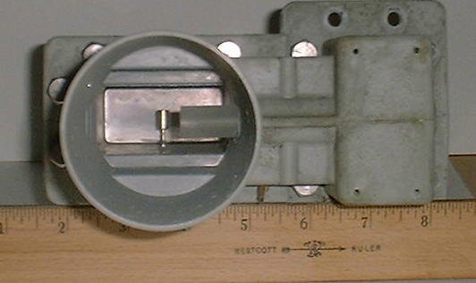

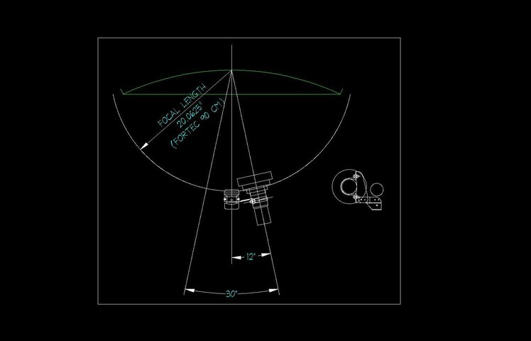

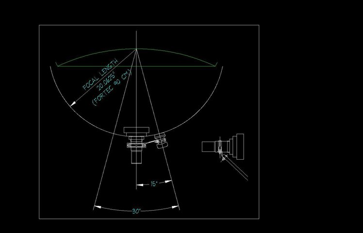

Working on two approaches to C/Ku feeds on Fortec 90CM. Tested C Band feed offset 15 degrees and got watchable pictures on all MPEG satellites but I didn't like the bracket so I trashed it. Work is till in progress and I will post progress later.

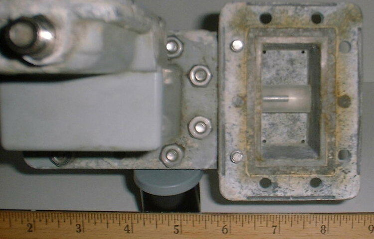

Got it but it broke up on me pretty bad. I didn't take time to optimize the scaler before I decided the bracket needed to be redesigned. It was fabricated from sheetmetal and didn't hold the lnb stationary. New brackets will be from aluminum angles pop riveted and bolted together and attached to the factory feed arm. If it works like I hope, I'll post dimensional drawings of them. I also plan to fabricate a clone rayydio's scalar when he posts the dimensions. Tried to get dimensions from his photos but what I measured didn't meet some of the textbook rules for scalar designs, so I don't trust my dimensions derived from the photos.
caddata, I was looking at the scale of the lnb and cone in one of rayydio's photos. The cone appears to have same measurements of flat scaler, just stepped. Your comments on attaching Ku to ASC 421 are along the lines of my latest interest. But rater than cut the 421, Id like to build an extention that I can cut into. Attached photos are of old dual feed horn.

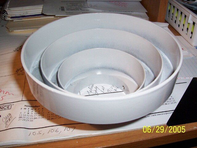

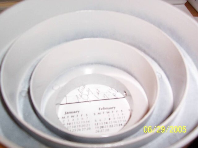

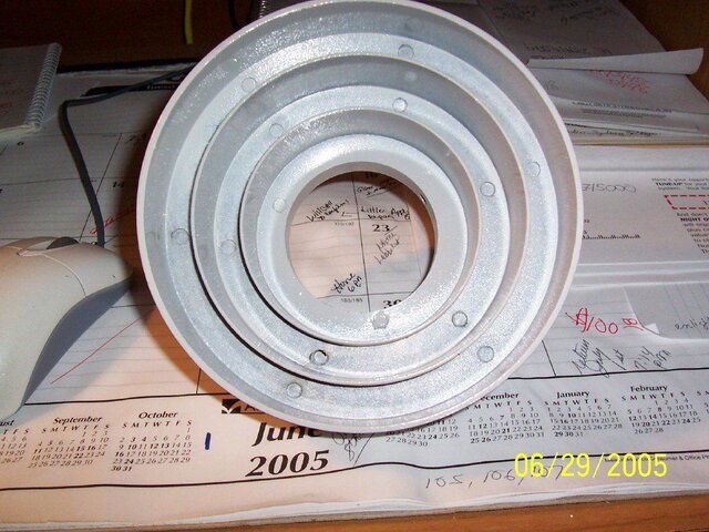

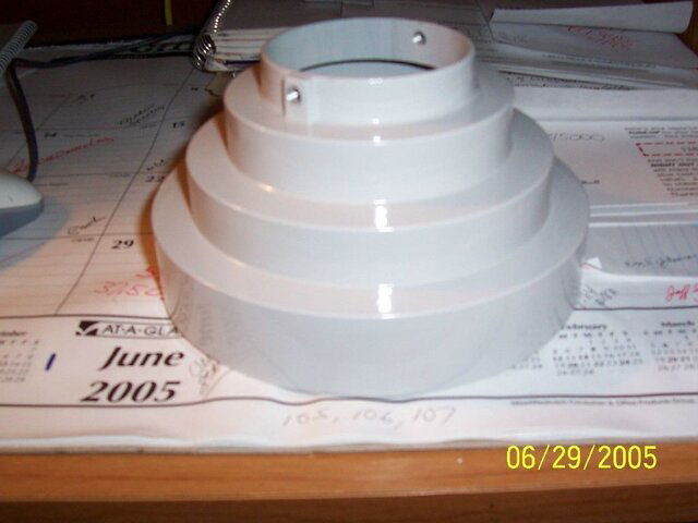

OK - First of all let me say I am not an engineer so all dimensions are approximate! Here are the dimensions for the EITS cone scalar.
Inside meansurements -
Outer ring - 6 3/16" Depth - 1 1/16"
Center ring - 5.0" Depth - 1.25"
Inner ring - 3.75" Depth - 1.25"
Outside measurements -
Overall height - 3 5/16"
Height of (Bottom) 1st ring - 1 3/16"
Height of center ring - .75"
Height of top ring - .75"
Hope you guy's find this info usefull!

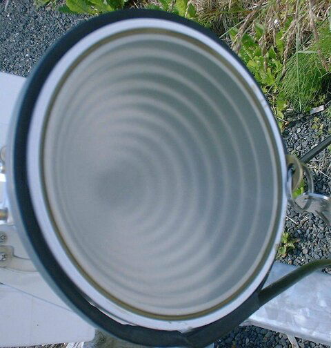

rayydio, great thanks for data. Cascade, was begging to worry a bit , maybe Mack truck run over cone. Look forward to your test resullts. My attempt at Ku cone to flat converter failed terribly. Tried turnning aircraft grade aluminum on lathe, broke many bits, turned nylon OK for backing plate. Sprayed nylon with aluminum paint for reflection, no go. No soft Aluminum plate in this area. Not to give up. Id like others with Ku Prime Focas scalers to post data on ring depth, ring spacing, Have photos of 8' offset dish with Ku cone, many rings on it. Cone about 6" dia.
