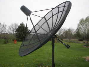

I've been posting ads on Craigslist etc looking for BUDs & primestars. There's a guy with a 10' Unimesh, actuator, feedhorn etc who wants $100 or "make an offer"
are the unimesh's worth it? The guy's maybe 45 miles away, claims that the dish is in great shape and was in use up until 2 years ago.
I guess my question is: should I hold out for a solid, or are the unimesh dishes good performers worth say $50 and an afternoon?
Most of the dishes I have seen locally are mainly free as long as you remove from premises. If this person is charging you 100 bones for that Unimesh and still have to remove and take apart, then its not worth that much.
well, it also says "or make offer" so if it sits long enough, the price might drop more and more.. if it were a stellar dish, then I'd offer him something.. $25 or up to $50 or something.. but only if it's a super duper performing dish
If it's in good condition, has good actuator/feed/LNB(s)/pole and still has good parabolic shape (string test it) it would be well worth $25-$50 to me.
Unimesh is a well made dish, they appear to be a little heavier-built than some of the typical mesh dishes that I have seen.
You can wait (forever?) for a "better" deal, or you can pull the trigger, put up a dish and start watching some tv. ;)
Is it just the Dish, or is the Feedhorn and LNBs included?
When I bought my Unimesh, I paid $250, but it included a working 4DTV 920, HDD200, and good C and Ku LNBs on a CoRotor II feed. I sold the parts off for a nice profit, only keeping the Dish & Arm. :)
It's a complete 10' dish, pole, feedhorn/LNB, support arms, what appears to be a 36" actuator. no receiver though. guy wrote me and said that was really easy to sell on ebay (must have been a 4dtv).
when I asked him about the actuator, he said that he measured the "thing" on the back of the dish at about 46 inches,
I guess what I really am asking is, compared to a 9.5' unknown with "ok" Ku performance, and a 7.5' perfect 10 which is in the barn, would a 10' unimesh be worth going after if I could get it for $25 to $50? do you guys think its performance (especially Ku) would be better than the perfect 10? I know what my current dish is like, and Ku works on most sats, but isnt stellar. that and the pole moves and needs to be redone

I installed many 10' Unimesh dishes and had excellent results with both C and Ku. The main thing is that it still has a good parabolic shape. It should definitely outperform the 7.5' if it's in good shape.
I've had my 12 ft Unimesh since 89 IMHO it is a very good dish well built too been in 90 mph winds and stayed solid as a rock.

The string test is done by running a string tightly across the diameter of the dish from rim to rim, then running another string perpendicular to that string. If the shape of the dish is true, the strings should touch a the intersection while remaining straight.
