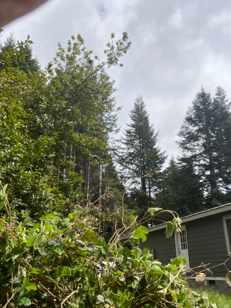

Before I consider any commercial service I need to get the blackberries cut. Once I do that I'll post a picture of the front of the dish
Thank you all for your responses! It's very encouraging. But I am worried that my new house might be in the way.
From my experience I can say that Rainier's approach to sales is pretty high pressure. I wouldn't be considering them any time soon, anyway.
Thank you all for your responses! It's very encouraging. But I am worried that my new house might be in the way.View attachment 181522
I've never seen a BV with a linear actuator on it, like yours has. And most of the BVs I ever saw were 8'-6 in diameter, but I know they also had a 9'-6 reflector. Don't think the larger size was very common though. Search for old threads here by Linuxman and possibly Pendragon for some good BV info. I've got a couple of threads also that might be helpful, lots of good info if you have time to check it out...good luck with your project!
Don't worry too much about the blackberries. They aren't going to be endangered around here anytime soon. They're our version of kudzu. Before I cleared some blackberries the dish wasn't even IMG_20250511_201825.jpgvisible.
Anyway, it wouldn't be possible to move the dish without cutting them; they're growing though the rods that support the LNB. However, moving the dish might be a good idea if the new house proves to be in the way. Although, honestly, I can't quite imagine how I could accomplish that.

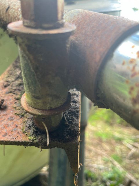

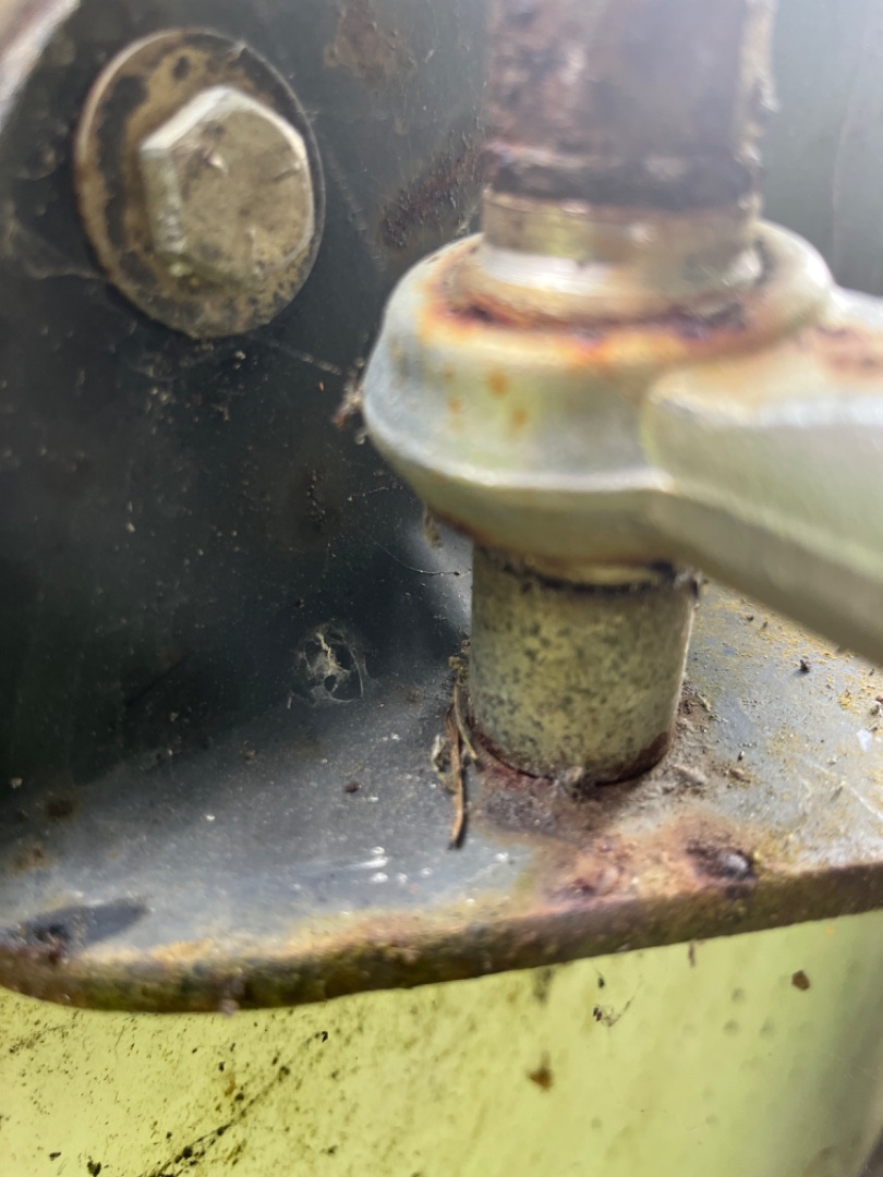

The mount on this Birdview appears to be an early polar mount type (not a horizon to horizon) with a 36" linear jack (actuator) arm. The actuator may still work, but I recommend that you tear it down, remove the rust, reassemble and lube. Apply 12 VDC (car battery?) to the DC power terminals to see if the actuator moves (if so, also swap the polarity to see if the motor reverses). The actuator may have limit switches. Need to open the cover and see if it has limiter switches and also confirm the type of sensor (reed switch or hall effect).
Also, the polar mount may not have a declination adjustment and was preset for a general region. Would need to view a close-up photo of the top and bottom mounting brackets where the vertical rod passes through to determine if there is a mechanism for declination setting. In the early days, dishes usually only moved between several closely grouped satellites. Often, spacers were placed between the polar mount and the reflector to shim the dish for limited declination adjustment.
Thanks for setting me straight about h to h. It is 9'6" diameter.
I maybe took pictures of the brackets? The dish was set up there and working back in the '80s, if that is relevant to the declination adjustment.IMG_0368.jpegIMG_0367.jpeg

Right, I don't see a declination adjuster but if the dish worked originally it should be close to good. Same for the azimuth & elevation if unmoved from before.
If that's not the worst actuator arm I've ever seen, it's in the top 10. If intending to have a motorized system I would simply replace it, though a 36" is going to co$t these days. Otherwise if looking to home in on a certain position and leave there, then you could possibly (if lucky) loosen the bolts on the arm clamp and manually move the dish to find signal.

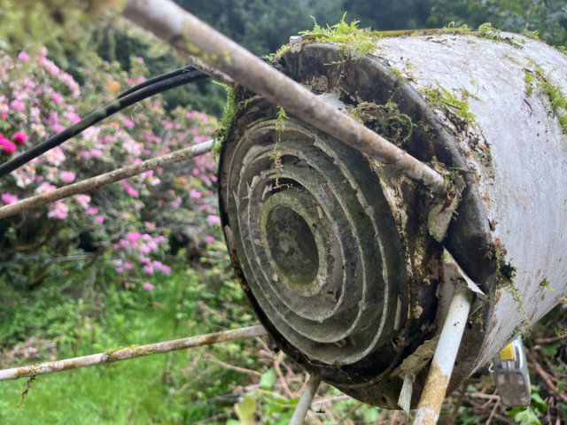

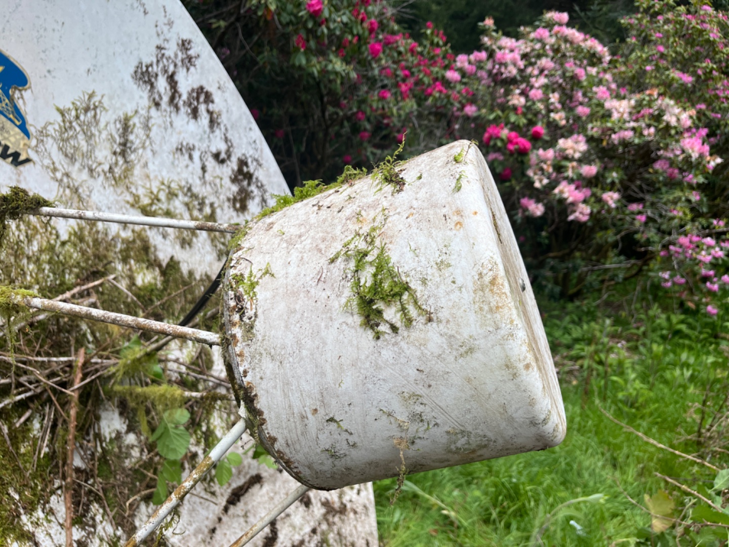

Now you will want to remove the feed cover to see what you have there. Is there still cabling from dish to home?

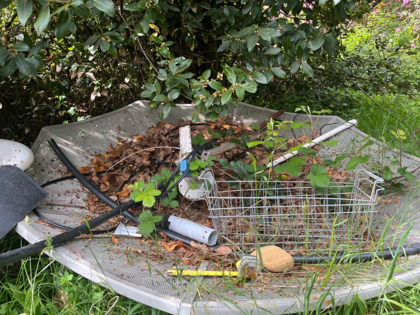

I took another picture by laying my phone down flat on the feed horn so it shows where the dish is pointed right now.
Also, I have a six foot mesh dish from the top of an RV, a travelsat, if I remember correctly
There is still cable but it's cut off. The old house was demolished and replaced. I can find the cut ends.
I don't see any declination setting on the mount photos. You probably will find that the installer placed spacers on a few of the bolts between the mount and the reflector. If there are no declination spacer shims, the dish would accurately track c-band satellites within approximately 30 degrees of the arc. You might find that you will need to add declination shim spacers between the mount and reflector to accurately track a larger section of the arc.
In the 80's most programming was received from 5 or 6 satellites in this smaller section of the arc. Now days, it is quite common to move 80 degrees or more for satellites spread across the arc from the Eastern to Wrstern horizons. In Western Oregon with clear line of sight, you might receive satellites between 58 and 139w degrees, but more typical in the West to be able to see satellites between 80 - 139w (though you might be able to see the Western Pacific Rim satellites around 180w).
It wouldn't surprise me if you find a very antique feed assembly under the cover. Probably a 1980's LNA and other unspported technology. The feed assembly can be updated to more current hardware such as a LNBF for a very reasonable cost. Take a photo under the hood.
Reactions: FTA4PA
My bet is dual LNBs, and they will be huge pieces, painted in white. But given the lack of H to H mount, it could be early enough to have an LNA and BDC.
