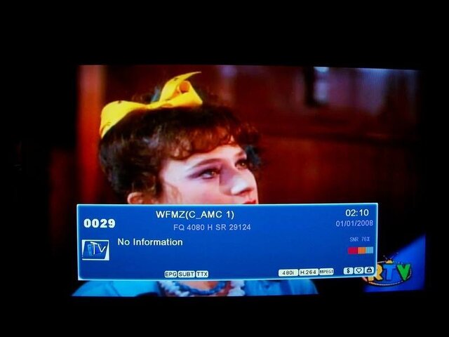

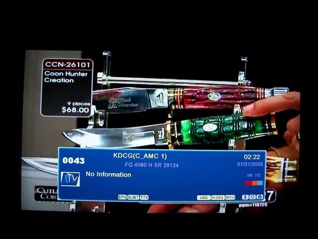

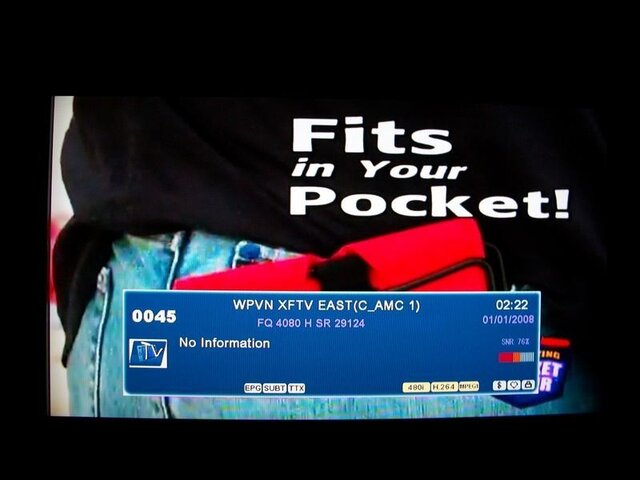

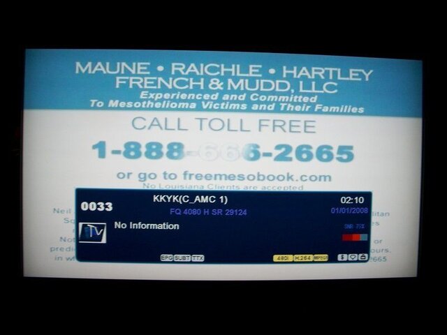

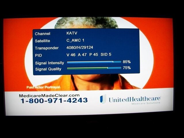

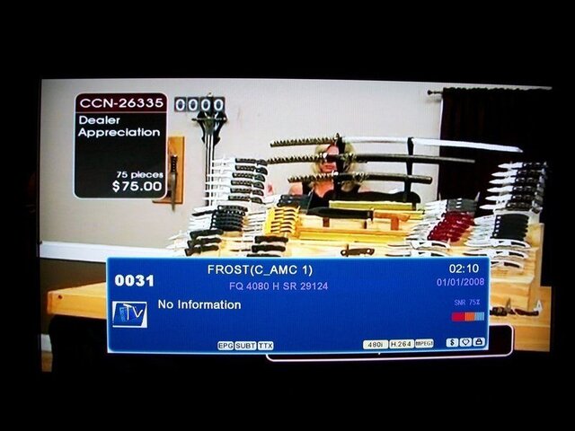

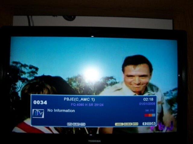

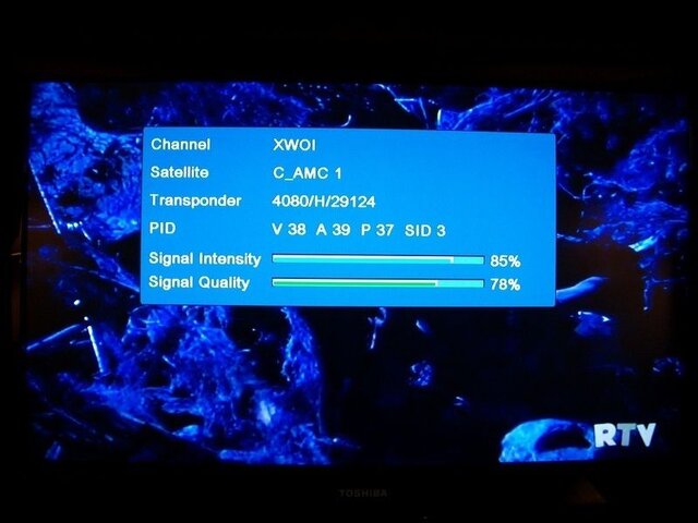

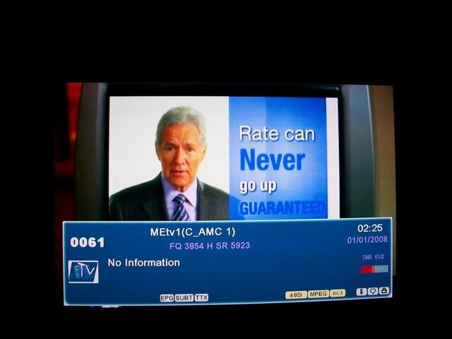

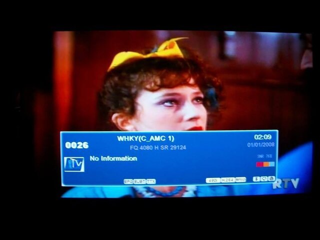

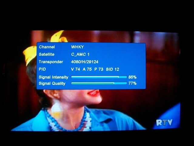

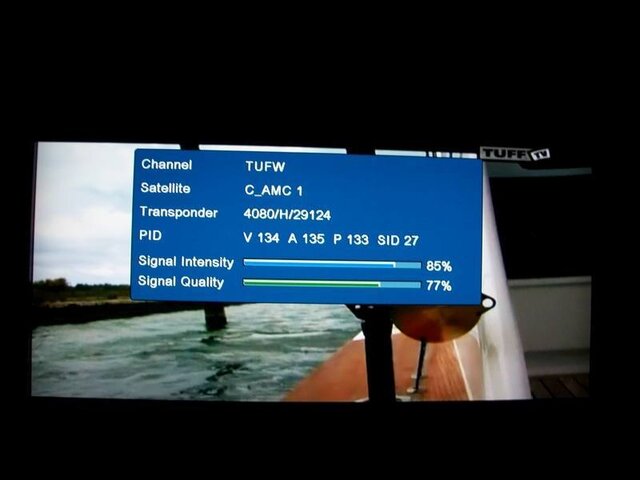

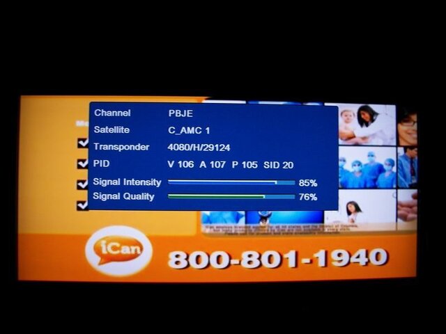

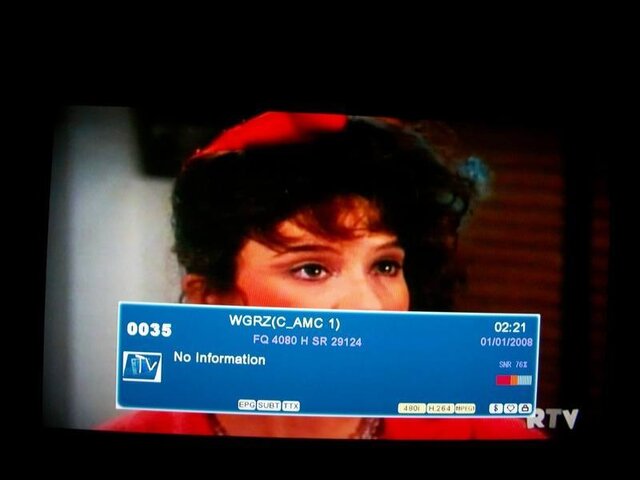

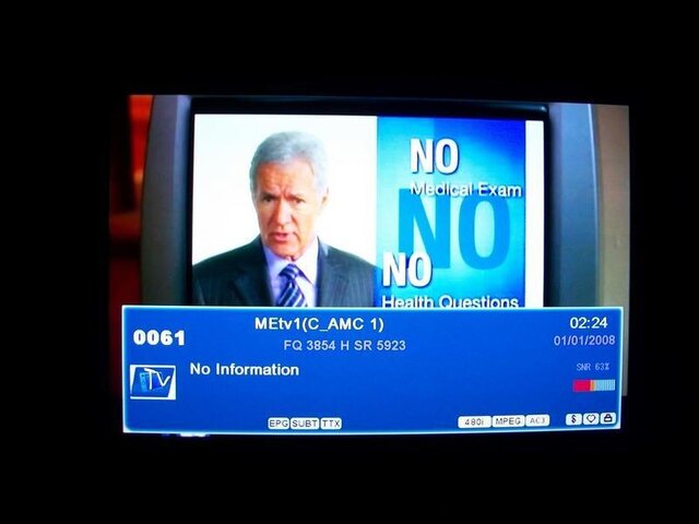

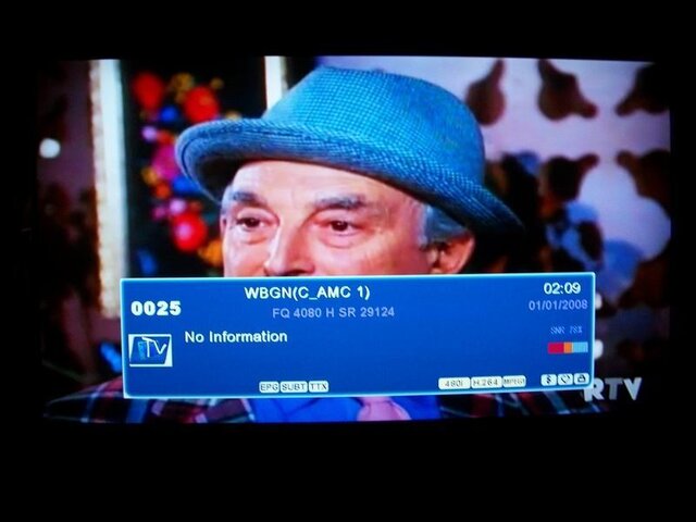

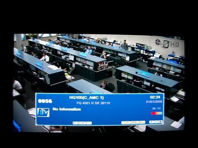

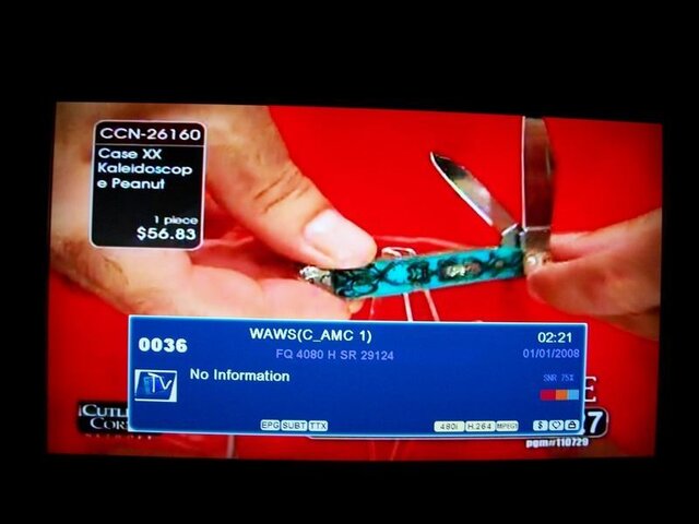

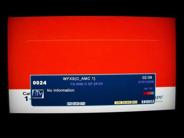

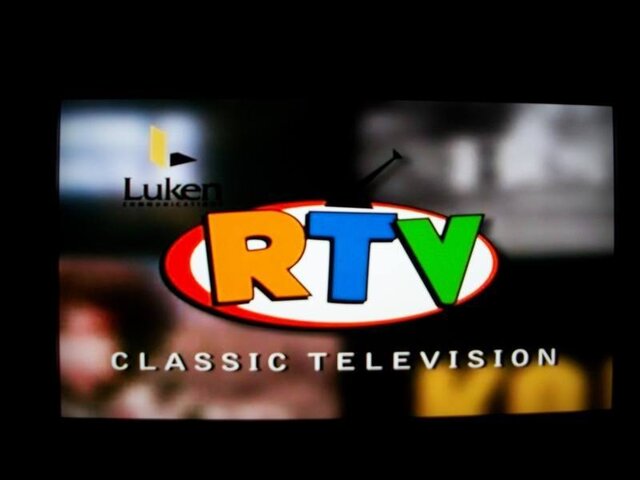

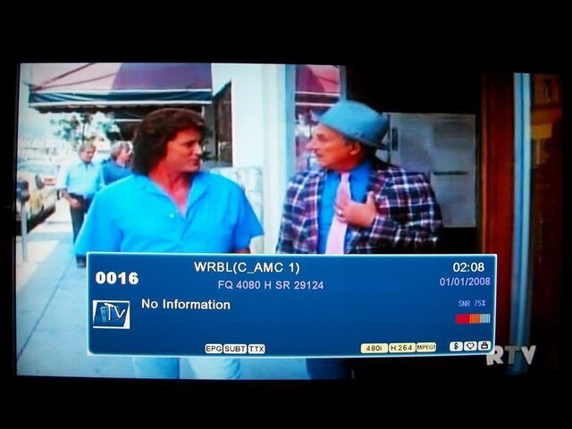

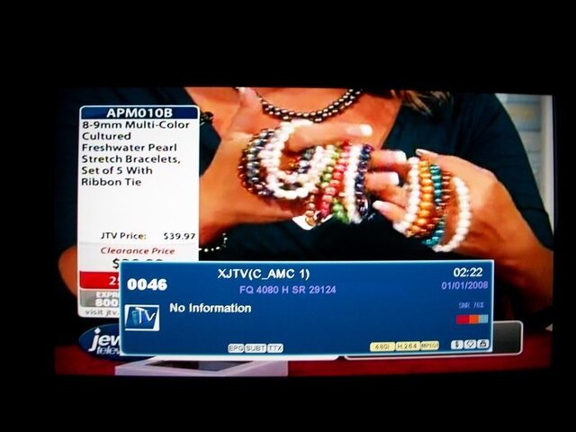

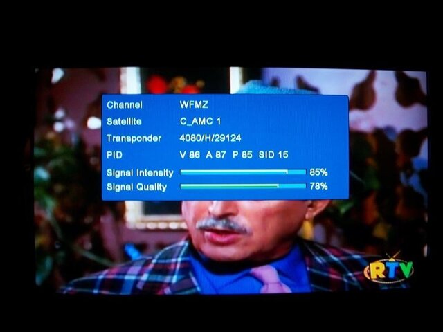

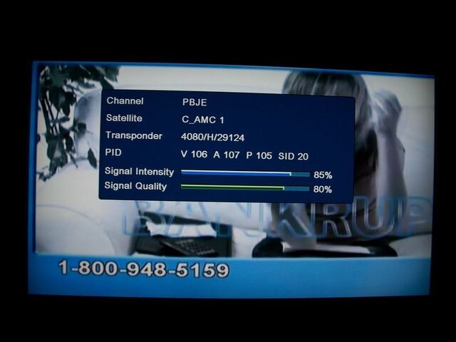

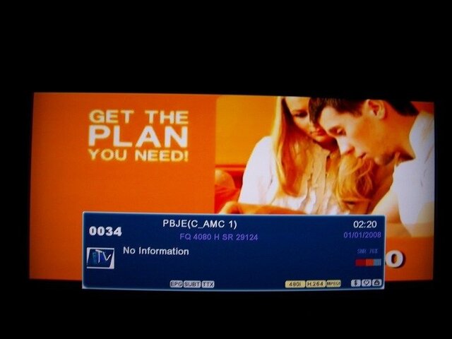

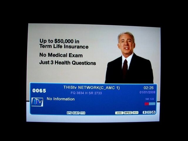

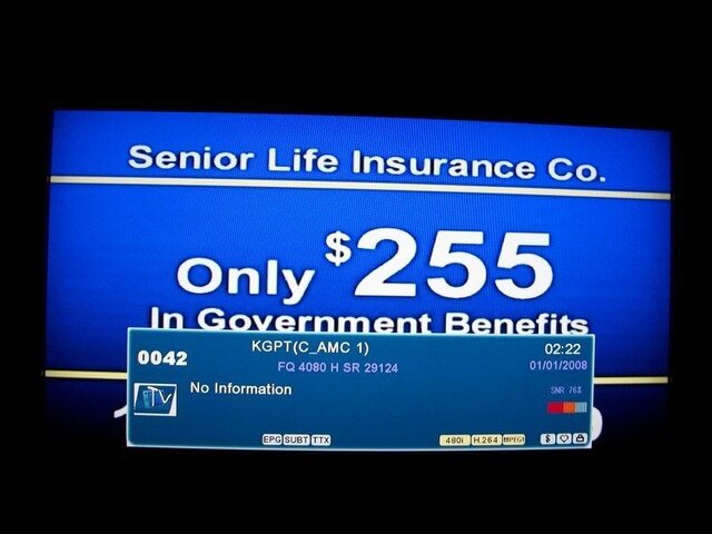

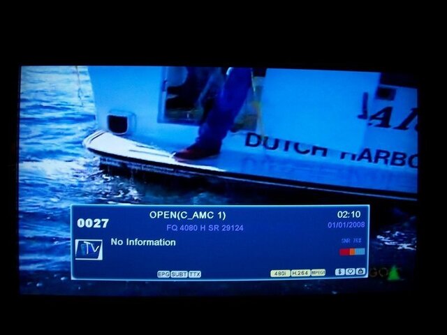

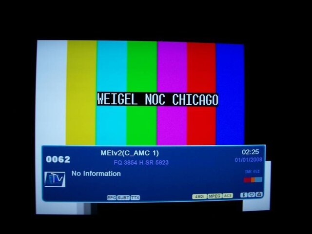

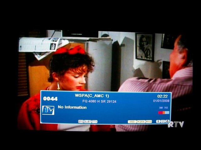

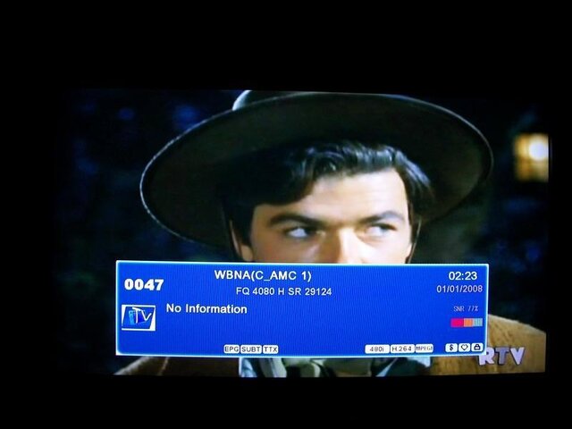

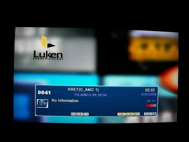

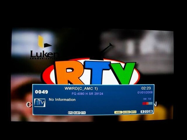

For those who believe that a minimum 8' dish is needed to receive DVB-S2 signals on C-band it might be easier than you think.
Earlier this week I attached a GeoSat Pro C-band LNBF to my 4' Channel Master dish and started scanning in channels using an Openbox S9 receiver. To my surprise when I scanned AMC-3 I received all the RTV/TUFF TV/PBJ channels on the 4080H mux each having a signal strength 75% and above. In fact, these signal strengths compare to the same received on my 8' WS International dish.
Please note that NO adjustments were made to the dish or C-band LNBF. I simply installed and began scanning. I also received a CW channel in HD on Galaxy 28 that looked awesome which is also a DVB-S2 signal. I'm also receiving most of the channels on Galaxy 16 (Leasea, Networks, etc), Galaxy 17 (EWTN, WORD, etc), Anik F3 (TV HOT, MeTV, etc) and other satellites.
I'm going to be doing more scanning tonight to se what else I can receive before making adjustments to see if I can also receive the RTV 3800H mux.

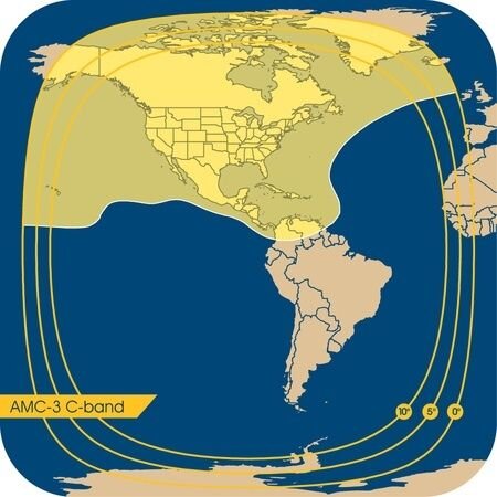

Easy for you , Popcorn. :) If you look at the sat's EIRP map, you're in a good area . I'm in the worst area in NA for the signal, and I don't get a burp !! ( Well , maybe a burp, but no lock ! ) Thanks for the info , though. I'm a big fan of a 4 foot mini-BUD in the right situation. :)
Hmmm. According to the footprint I may be able to pull it off with my 4ft dish. Only issue would be I would really like to the C and Ku band capabilities on it. What would I have to do to convert a 25mm lnb mount to a C/ku feedhorn?
The EIRP map looks good to me.

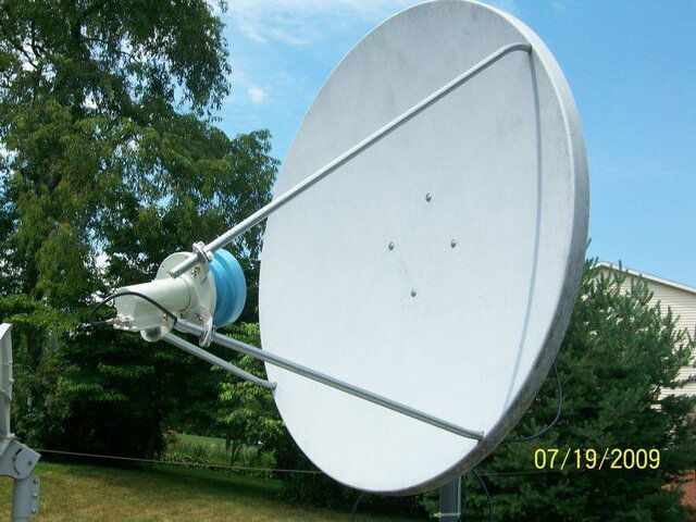

I believe the reason for me receiving DVB-S2 channels with a signal strength of 75% and higher is due to the fact that I'm using a commercial Channel Master 4' dish which holds its shape and is one solid piece rather than being mesh or having panels.
Plus after 10 years in service the dish still looks great and can easily be cleaned. My newer 6' and 8' panel dishes on the other hand have rusted hardware that bolts the panels together as well as some of the panels.
I understand they do this in order to make them easier to ship and to reduce costs, but they just don't compare with a good 4' or 6' commercial Channel Master dish. when I lived in Florida I purchased (6) 4' and (2) 6' Channel Master dishes for only $10 each from a surplus supplier (Astro Too) located in Melbourne.
As I said before the signal on my 4' Channel Master is roughly the same as received on my 8' panel dish. this is why I want to get one of the 6' Channel Master dishes up, because I feel it would perform as well as any 10' and possibly 12' out there.
Attached is a picture of how the GeoSat Pro C band LNBF is attached to the 4' Channel Master dish. Since this is an older picture it shows the blue conical scalar which is not installed now.
