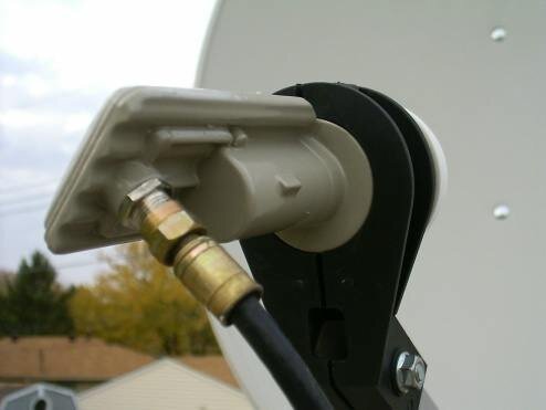

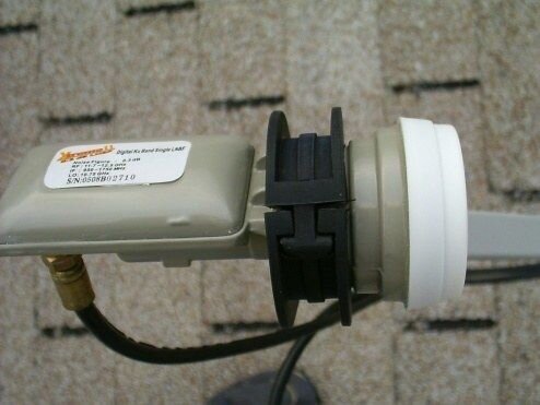

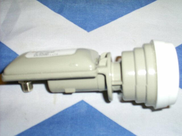

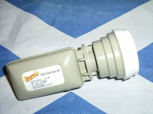

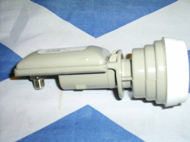

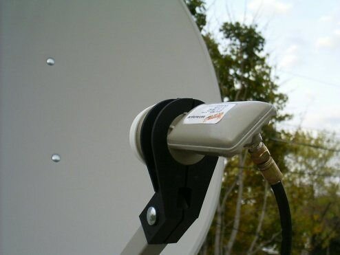

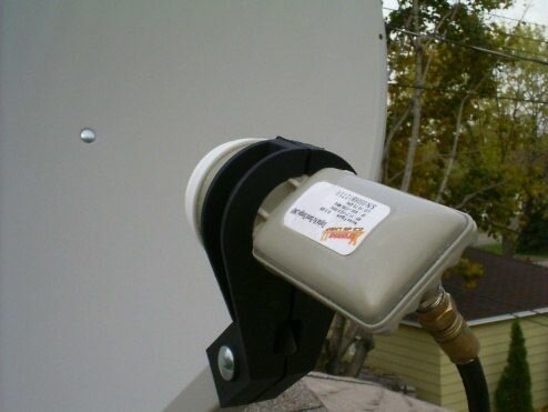

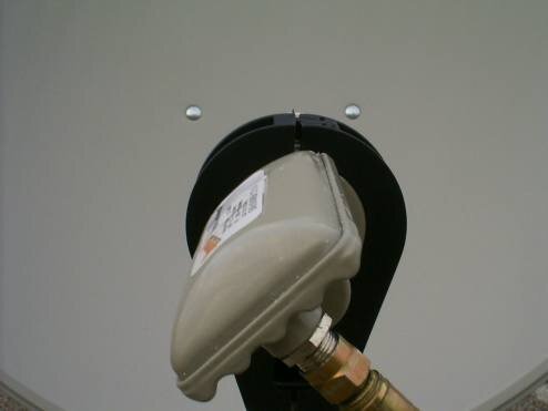

Unlike the regular Xtreme LNBF this model is all steel and has to be off set from the usual LNBF scew position. (see below)
Installing the Xtreme II LNBF
Its a Standard US Ku (10750 L.O.) Light weight compared to the QPH-031
40mm throat mount.
With the all metal housing it should have better shielding, better performance and less interference.
Nice little unit!

I just purchased this as it was the same price as the ASC-321 I was going to buy. On a scale of 1-10, how difficult would you estimate the mounting to be for a beginner?
Should be just as easy as ANY LNBF, just make sure you click above where it says "Installing Extreme II" As there is a small mark on the LNBF that has to be at the top.
