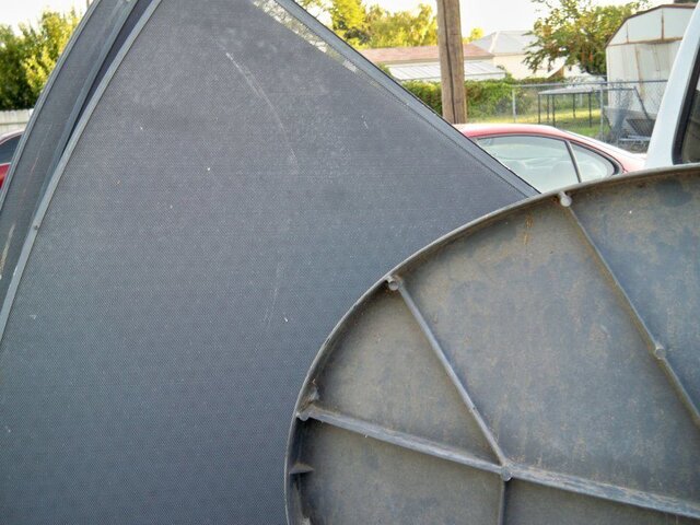

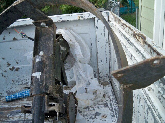

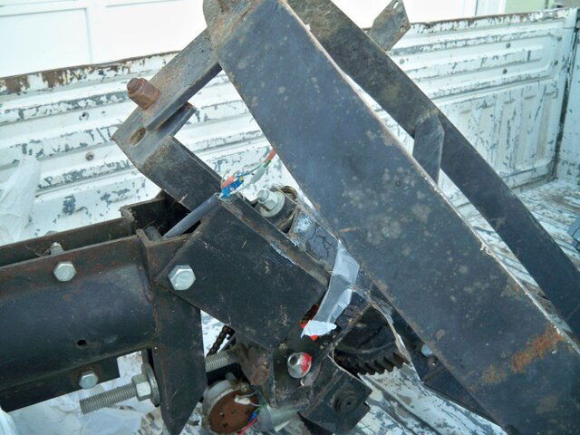

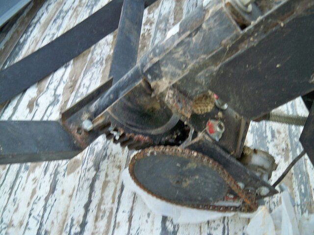

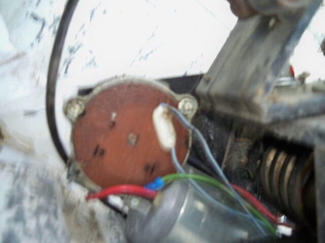

Well now that I'm in my new house. I can put up my c-band. (Probably next year). This is a nice 10ft winguard dish (mesh). However, it is HH mount. Can you get motors and parts for hh mount? I took picture and figured maybe it would be a easy convert to a SUPER JACK ACTUATOR LINEAR MOTOR. Also I have the traditional polarotor with motor. I found all the parts for that. But I would have to look at a v box or something. AKA about $100.00 So why not just purchase a new dish? So I have all new parts and easy fix? THe problem is I cannot find anything above 8ft and would like to make sure 1 dish to cover all needs to be 10ft or 12ft. Below is tons of pictures.
I guess I'm saying how easy is a convert and can I put a newer 13/18v swith lnbf on it. I think I can do that for sure.
Thanks,
Josh

That pile may look bad now, but I believe you have an AJAK 180, H-H motor.
Clean it up and get some covers on it. - :up
Talking about replacing it with a regular jack might get you hurt 'round these parts! - or worse: - :rant:
As for running it with a Gbox, see my signature for a link to buying one, and look in our Review Department for why that's the one you want! - :up
To convert the traditional Chaparral feed to a voltage-controlled one, decide if you want C-band only (use a C2), or want to fight for both bands (the DMX741 or Ck-1 are possibles).
There are a number of other threads discussing the critical alignment needed to get good Ku on the dual-band LNBF's.
Not impossible, but you do need to be serious, and do it accurately.
Another (much more expensive) solution is the dual-band orthomode feedhorn, equipped with two C-band LNBs and two Ku-band LNBs.
It is apparently a lot easier to get tuned up, but at quite a cost.
Hope these comments give you something to chew on. :)

Josh, you have what is arguably the best motor that exists right now. It would be WELL worth it to take your time and clean that mount up, grease it up, and USE it! As an owner of two dishes with H-to-H mounts, I have NEVER been sorry. As long as it has never been underwater, the motor and all should be fine. Just keep it out of the weather. When I did my Paraclipse one I set ti up in my shed and worked it a little each day until I got it cleaned and lubed like I wanted it. What you have should be no different. Just TAKE YOUR TIME AND ASK QUESTIONS if you need to.
As far as LNB's, I use CK-1's on both of my dishes and I am extremely happy with them. But, as Anole said, they take some doing to get set up properly. But they are as maintenance free as can be. :up
Nice setup and good luck! :)

The whole thing will have to be taken apart and cleaned up before re-using. Check the motor when you take off to see if it still runs or not. The mechanical parts look fine from the pictures. Get the rust off the polar mount and any moving parts.
It looks like a heavy duty dish, BTW.
I rebuilt the one I got and there is a bit to it depending on how much wet it has encountered.
The real Achilles heel is the bearing method they use for the main (polar) shaft.
Instead of actual bearings they use a sheet of teflon about 0.060" thick. When new it's great, but as the shaft rusts, it grows and the teflon then acts like a lock. Getting it apart at that point will mean pretty much destroying that sheet. Mine was pretty rusted and locked up pretty bad. It still moved, but it took all the might of the motor and would have killed it quickly.
I wound up putting the polar axis on the lathe and sandpapering all the rust off as I spun it. Then I got some regular bronze bearings and turned them so they would fit inside the polar axis housing and over the polar axis shaft. I also had to replace the zerk fitting as it was totally rust up.
To add to the problems the manufacturer used welded pipe as the polar axis shaft which is not perfectly round.
I had to replace the cherry switches (limit switches) and the barrier strip (connector strip). I sand blasted it and repainted it.
Most of the original construction technique employed welding it together instead of using screws or clips so to really disassemble it you would have to grind the welds away and then re-weld it later.
In my current location, my view of the Clarke Belt is extremely limited, so rather than expose it to the western Washington elements again I chose to use a conventional jack and save the H2H mount for NM where I can actually see the horizons.
If I ever get ahold of another one I will salvage and use the very nice parts of it and redo the bearing with real ball bearings and use real shaft material instead of the pipe the manufacturer used. It's to bad the manufacturer had to be competitive and use some of the materials he did.
