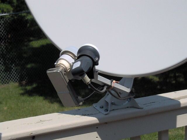

yes it will support the LNB but you have to make some adjustments for it to fit in the holder
The holder wont fit the LNB as is. You have to remove the plastic from the LNB. The outside plastic cover cracks open very easily. The top part of the plastic case has to be removed so you can fit that into the holder. What I did was wrap masking tape around that to make it big enought to snugly fit in the holder
see attached picture. Thats the LNB with no case on it (the one on the left is for 119..the right one is for Galaxy 10)

Iceberg said:
I didnt want to either but I had an issue with signal dropping 15-20 points when adding a SW21. Tried numerous combos and still same thing
Thanks for the comeback, in my junkbox I have an old DSS(direct) lnb with a neck of the right size, I believe it is legancy, I think I'll experiment this week as I have no real need for 121 anymore.
