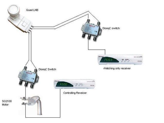

Hi Guys,
I know that someone willl know if this is a good setup. I know that Multiswitch would be better, but I am hoping that it would work as well. What do you think about it?
Thanks, Peter.
I'm doing the exact same setup and it works just fine. Multiswitch just eliminates one extra switch :)
Works for me, and I use the other 2 for C-band and BUD ku. I have a new 1.2m currently hooked to a Coolsat 5000 (going SOLO). Haven't made up my mind how I'm going to integrate what into what yet. But, there will be some changes.
Al
OK Guys, Thanks a LOT.
This is a great news. I have DiseqC switches lying around since they're cheap:)
My idea is to be able to receive both linear and cirlcular signals. Since Iceberg mentioned that he has the same setup it's even better news. I hope to test it next week.
Peter.
