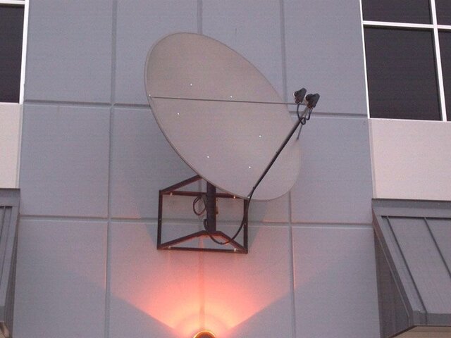

In a few months we will be offering a GEOSATpro 1.8M Offset with polar mount and locking bar to be used for fixed installations. Final retail cost is not established, but it will be considerably less expensive than the brands listed. :D
Stay tuned for more information as the release date gets closer.
Mosters to hang and monsters to ship!

Nice lookin' dish, Brian. - :up
Shipping a 6' solid is going to be a challenge, though.
What's the f/d gonna be?
I want one on the side of my house:)
I'm guessing that dish is to big/heavy to go UPS or FedEx package, will it have to be shipped LTL freight?
I've had LTL stuff shipped to the carrier's local terminal for pickup at their dock, it's cheaper than home delivery. Plus you can inspect for damage at that point, and if there is a problem, initiate a claim. :(
Maybe Brian can post some more specs (weight?) and pics soon.
A holder that would handle a CK-1 would be very nice, and maybe an adapter to install a 40mm Ku LNBF in that holder?. :up
Definitely want to see what the stock polar mount is like but I'm already having visions of one of these sweeping the Clarke Belt while attached to a BV/AJAK H-H mount. :D

A few additional details:
Estimated delivery - December 2009
Hanging Weight - Sorry, did not place on scales before mounting (approx. 110lbs?)
Shipping - Ground Freight in Custom Crating
We opted to upgrade the mount to a Polar Mount type to better serve the hobbyists (adds a few $$$, but sets it apart from any other offset on the market).
Model - GEOSATpro 1.8M OP (Offset Polar)
Reflector Type - Offset
Offset Angle - 23 degrees
Efficiency - 80%
Horizontal Axis - 180cm (70.86")
Vertical Axis - 195cm (76.77")
Gain @12.5 GHz - 47dB
Focal Distance - 108cm (42.52")
F/D Ratio - 0.6
LNBF Mount - 40mm and 60mm
Mount Type - Polar Mount (w/lock bar for fixed AZ Operation)
Azimuth Range - 360 degrees
Elevation Range - 0 to 90 degrees
Mounting Pole Diameter - 89mm (3.5")
Operational Temperature - -40c - +60c degrees
Operational Wind - 90 km/h (56mph)
Survival Wind - 180 km/h (112mph)
