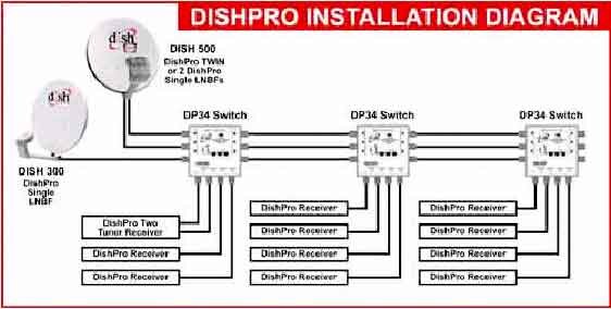

2 wires for 500 quad lnb and 1 wire for 300 single was used in the setup I saw with the 12 receivers, so total of 3 wires going into the 3 inputs for the DP-34. the 500 quad lnb is being used to pickup 119 and the 300 is for 61.5.
you said 2 chains of dp34 switches meaning 2 sets? each dp-34 has 4 receiver outputs so the setup I saw was 3 switches x 4 for the 12 receivers but I'm not sure if I can just add another switch for my setup because of the picture layout only showing a max of 2. I'm thinking I can but I want to ask one of the installers here. Thanks.

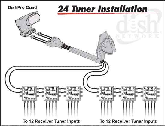

I had a diagram that had a quad lnb going into two different strings of DP34s. If I find it I'll post it. Like TheKrell said you can actually connect 24 receivers. Found it:

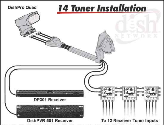

I would just buy a DP Quad and run one string with 2 DP34s and another string with 2 more DP34s. Here's a diagram for 14 tuners, using a Quad LNB.
