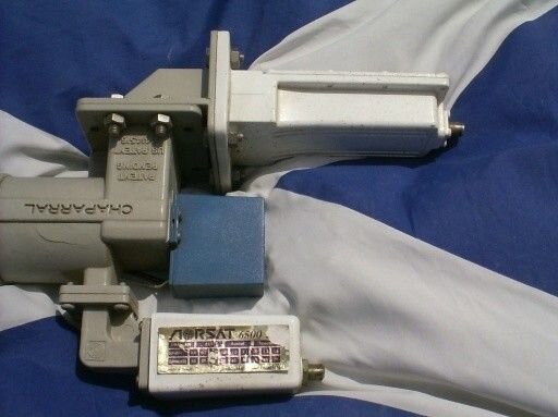

I am getting good results with a 6' mesh dish on Ku signals :up
I did optimise the LNBF for Ku signals (Including modifying the LNB cover) adjusting the skew and F/D while locked on a ku signal. C-band signals did suffer but the end results were worth it.
