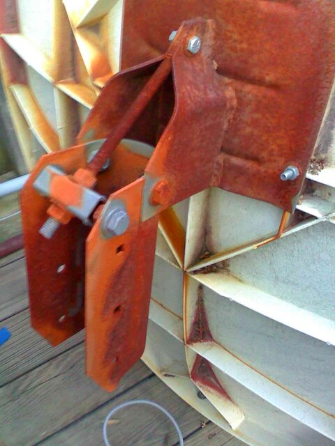

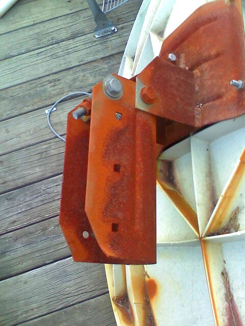

Got this dish from a friend of mine who can' t find the mount for it. Does anyone know how to set that baby up on some kind of mount?
Or better yet, have a picture of a simular dish mounted so I can figure how to get that dish set up somehow?
Thanks!

that looks almost complete.
You should replace that long rusty vertical bolt (if possible) and the nuts and washers.
that is your elevation adjustment.
And get some bolts that will fit horizontally. A 2" pipe should fit in there.
Mount your 2" mast in the ground if you can. It needs to be perfectly vertical.

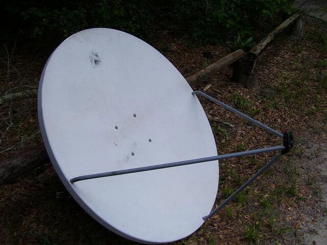

That's a fine lookin' molded dish! It appears to be about a 1.2 meter size, similar to my Channel Masters.
