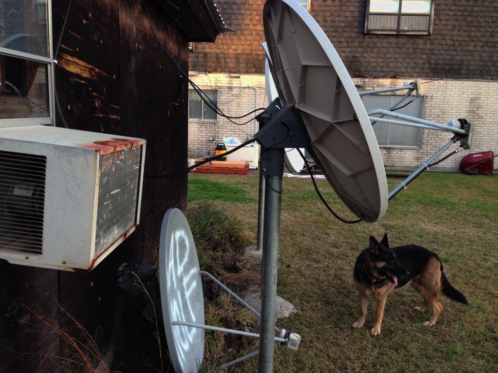

A few months behind schedule but it's time! Tuesday is the day.
First priority was getting my subscription dishes set up because I'm paying for that TV so I want it up and going ASAP. And I watch a LOT of the BBC..
I do have the luxury of moving piecemeal so I don't have to be in a huge rush to get everything over there at once. My FTA dishes ARE GOING but it will be a few weeks. There is a KU dish on an HH motor there now which will get me Retro and a few others I like, that will hold me over until I get the other dishes moved.

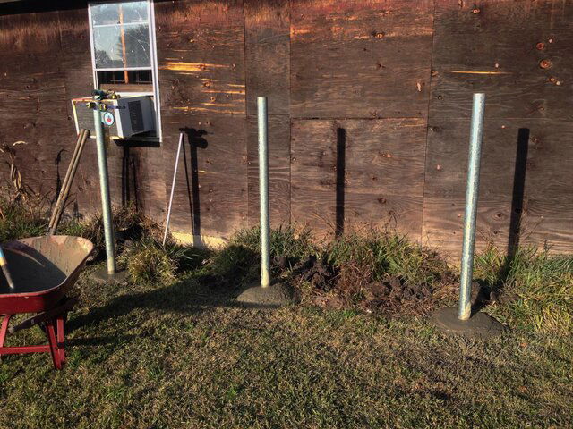

I also have to get the fence finished on the side where the FTA dishes go, when they were drilling holes in the ground for the fence they hit a gas line and made a HUGE leak that scared the whole neighborhood. That shut down everything for the day and my fence line had to get shifted over which I wasn't happy about.

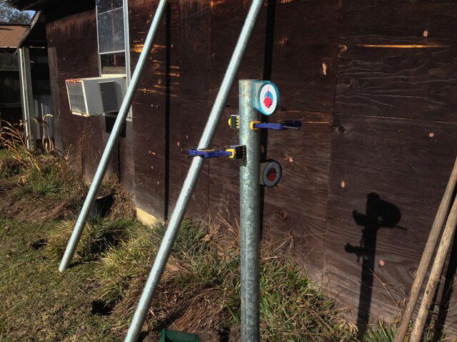

At least we now know where everything is buried so I won't have to worry when I plant the poles for my FTA dishes. The smaller dishes are going three foot down, the 10' C-band and the 1.8m Prodelin are going SIX FEET IN, I want 5 feet above ground so I need two 11' x 4.5" poles.

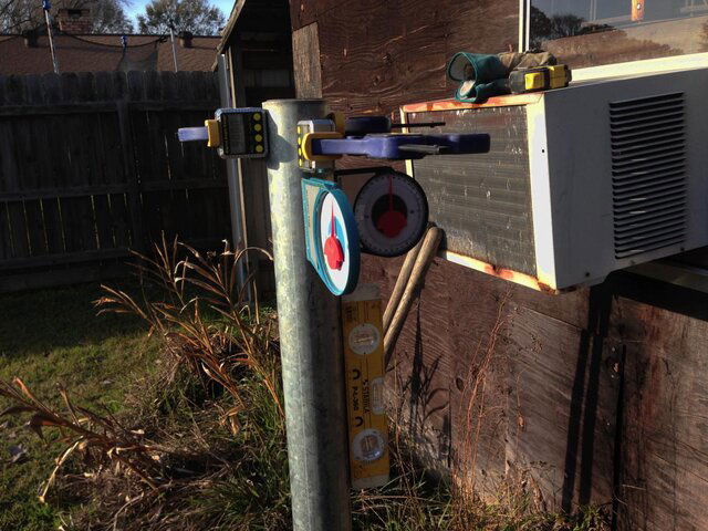

Over the years I've suffered a lot of grief from my FTA adventures. Mostly because of poles not put in plumb and or put in not deep enough. For my subscription dishes I got three schedule 40, 3" by 8' galvanized poles. My dad drilled holes 18" from the bottom and put some painted rebarb through so they can not spin in the cement. I had the handyman drill three, three foot deep holes when he was drilling holes for my fence. I had to use a hand digger to make them bigger around so I could get LOTS of cement in.
I mixed up cement till it was like crunchy peanut butter, nice and thick and well mixed so there was no dry stuff in it. I dropped the poles in and I clamped TWO digital inclinometers to the pole at 45 degrees from each other PLUS I stuck some of those needle type inclinometers and a bubble level to the poles and I set them to be PERFECTLY PLUMB. Absolutely dead on, 90 degrees plumb. Each one. Once I got them plumb I just backed off and rested awhile to let the cement set up a little, after about half an hour I checked them again and they were still dead on perfect so I very carefully removed all the levels and meters without disturbing the poles.

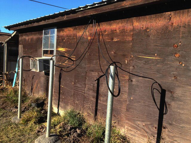

Today I went and ran RG-11 end to end and tacked it up properly along the eves of the garage (Yes, it's ugly, it's getting new siding soon). With my very excellent meter I expect that I'll get excellent performance from my dishes and that they will be indestructible and trouble free.
This is exactly the same way I am going to do my FTA dishes. I am taking my time and remembering all my past mistakes and griefs and doing it RIGHT this time. Also I this time I get the luxury of planning out where they go. The mish mash of randomly placed dishes here at my old house are not entirely my doing, my ex started that mess. I just went with it because I didn't know any better. Now I do.
It's really nice when you get a clean slate to work with and you can do it the way you want. And even better after you've learned the hard way what not to do.
My A3 is still on the blink, I haven't had time to try and fix it yet, Brian at Titanium sent me directions on how to fix it but I've been so busy prepping for moving that I just haven't had time. I hope next week I can give it a try because I would like to get back to recording my favorite shows.. :)
There's also my OTA antenna system that I'm going to do as well, I have a matched pair of 91XG's and the fiberglass tubes for mounting them. I just need to get a tower to get them up to 30 feet. I have a pair of thrust bearings for the motor so that should really help as well. And of course EVERYTHING from now on is RG-11. I bought a 1,000 spool of the stuff. There's enough to do everything I will ever think of plus I need to install an FTA system for my dad at his new home. He really, really likes his PBS. He totally digs the Oklahoma feeds.
As the FTA stuff gets moved and installed at my new(ish) home I'll post that stuff. As always, expect massive overkill. Because I can. :D

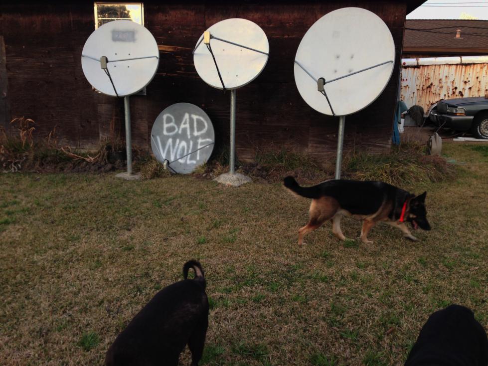

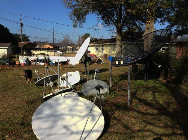

Well, here we go! I thought I would never see this day!
Truck is on the way this afternoon to take them to their new home. Gonna get the big ones another day as I don't have poles planted for them just yet.

Anyway, the dish moving is plodding along at a glacial rate. It's been raining and cold so everything is pretty much at a stop and I'm about two week behind where I would like to be.
Just today I finally got my subscription dishes connected which was priority one since of course it's costing me money. I should have had them finished a week ago.

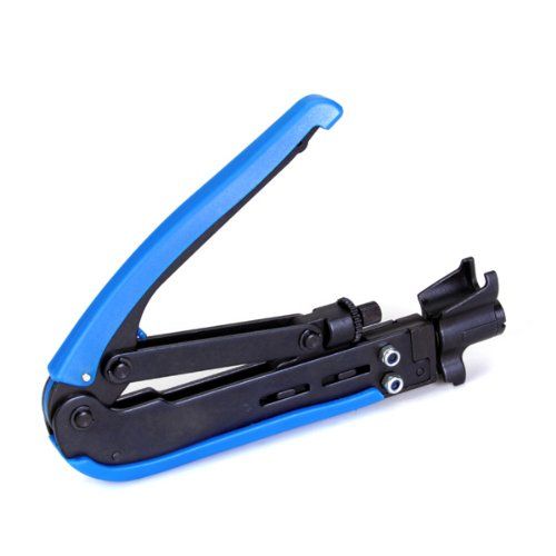

Probably a stupid question but I'll ask anyway, RG6 compression connectors won't work on RG11 will they? I was thinking about doing some re-wiring on my Dish Network system ( I use 2 30" Winegards to get 61 and 72) I have a couple of DPP44's and Hopper nodes for the signal to all pass through so I want to keep as much signal as possible to feed the Hoppers and avoid any rain fade. Will the same compression tool I have work for RG11?

The cables are two different sizes (More info here) RG11 (top) vs RG6 (bottom):
You can use the same compression tool, if it is made to handle multiple sizes. Here is an example: Amazon product ASIN B007NE8AIA :)
Reactions: Dee_Ann and jorgek
Oh goodness no, they are very different. I had to buy a whole new set of tools as well as new connectors.
But whatever you do, don't buy a compression tool like this one.
It's rubbish! It will not compress where the gap is so you get this distorted fitting that looks like a little kids bottom lip when you tell them "No more candy!"
You should find one that contacts the fitting a full 360°.. I can use this one but I have to squeeze it a tiny bit then turn the cable a tiny bit and squeeze a tiny bit again, over and over so it presses it in squarely all the way around.
I'm quite unhappy with this tool.
If you're going to go to RG-11 spend the money to buy top quality tools. Since that is all I will be using from now on I am going to shop about and buy good stuff. I bought cheap because, it was cheap. Ouch..

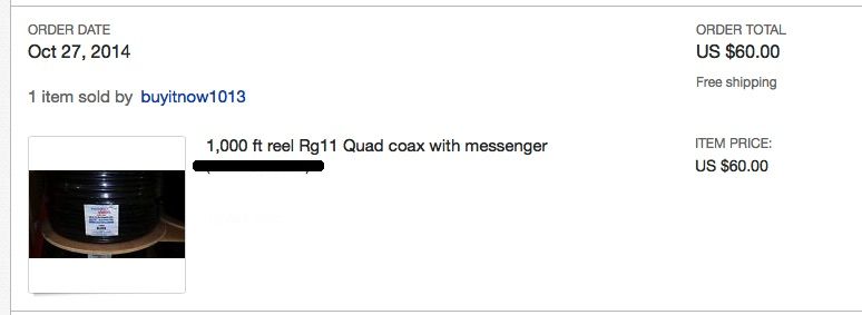

I should have known better. As for the wire, it's bloody heavy !! (The spool weighed 100lbs so I had to build a dispenser for it that I can strap to a hand cart.)
I bought a 1,000 foot roll for $60, DELIVERED! That should last me the rest of my life and then some.

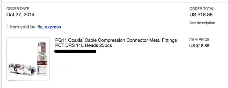

I do need to buy some more connectors and I think I could have bought some rated for a higher bandwidth but they seem to be working fine on my Dish Network stuff for now.
Of course I could always cut them off and put better ones on.
But yeah, you'll end up having to buy all new tools. RG-6 tools ~will not work~...

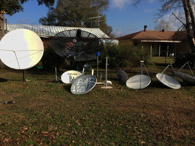

That is my FTA, HH motorized dish which I need to plant on the side of the house in the FTA farm. It's just leaned up against the garage for now. I figure it will be a few weeks before I get my FTA dishes moved and put up here.
Getting my C-band dishes over here are going to be a nightmare. I have to take the 10' dish completely apart. There is no way I'm going to try to move it whole. It's only about 6 miles but the roads are packed with idiots.

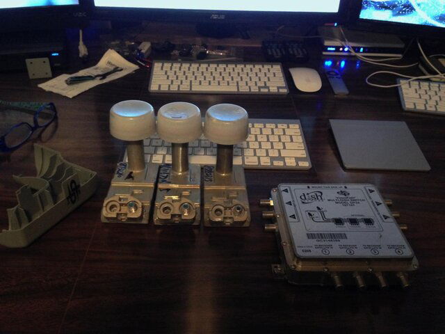

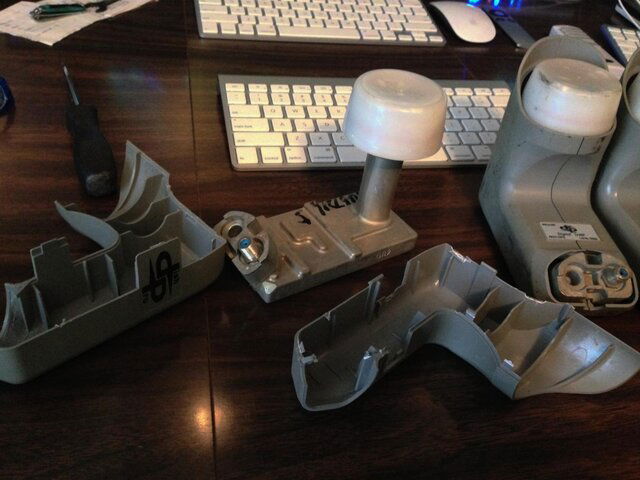

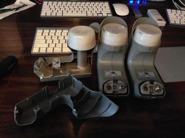

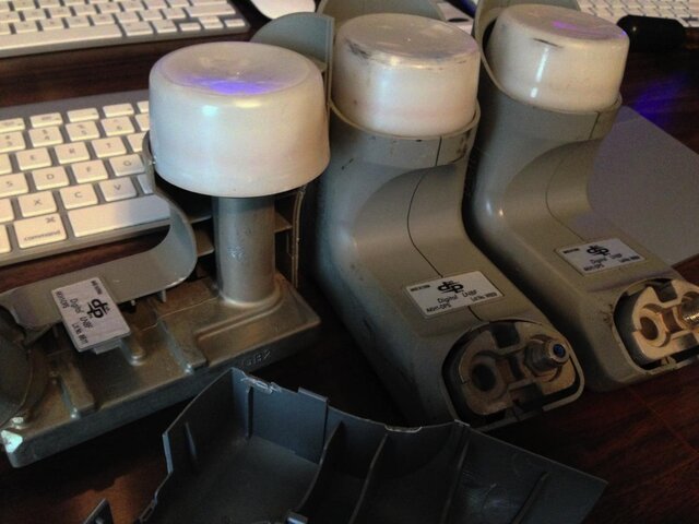

Got me three DP LNBF's in the mail today.
I popped the covers off with a screw driver and find that the necks are 23mm in diameter.
I'll have no problem adapting them into my existing Primestar/Andrew/Prodelin dishes..
They will replace old Dish legacy 300 and Directv LNBFs so I can connect them to my DP34 which will feed two ViP211k receivers.
Believe me, I fly blind and it's more error than trial for me but eventually I get it figured out and working.
If I can do it, ANYONE can do it.
