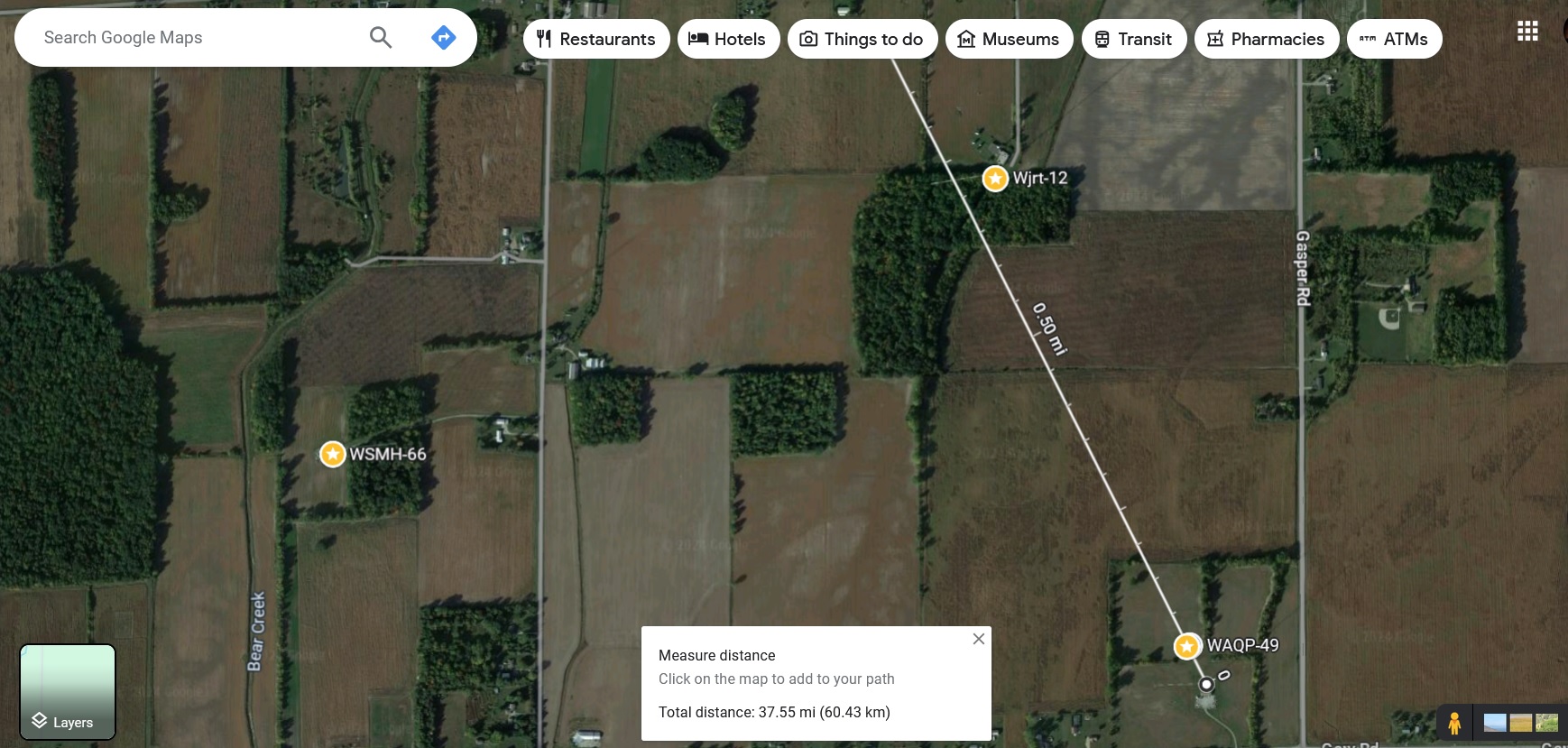

Trip , I'm 37.5 miles North, and slightly West of this tower. Right on the corner of W Birch Rd, and N Lakeside Dr as seen in the attached printscreen below. Here's my Rabbitears report for the exact location of my antenna, which is a Televes 149884. https://www.rabbitears.info/searchmap.php?request=result&study_id=759888
I seemingly shouldn't have issues at all with this station based on the report, yet it is a semi-frequent pixelating troublemaker for some reason I simply can't figure out. My closest cell tower is 2.37 miles away just slightly East of the antenna bearing for WAQP tower, but the antenna has a 4g/LTE filter that starts at channel rf37.

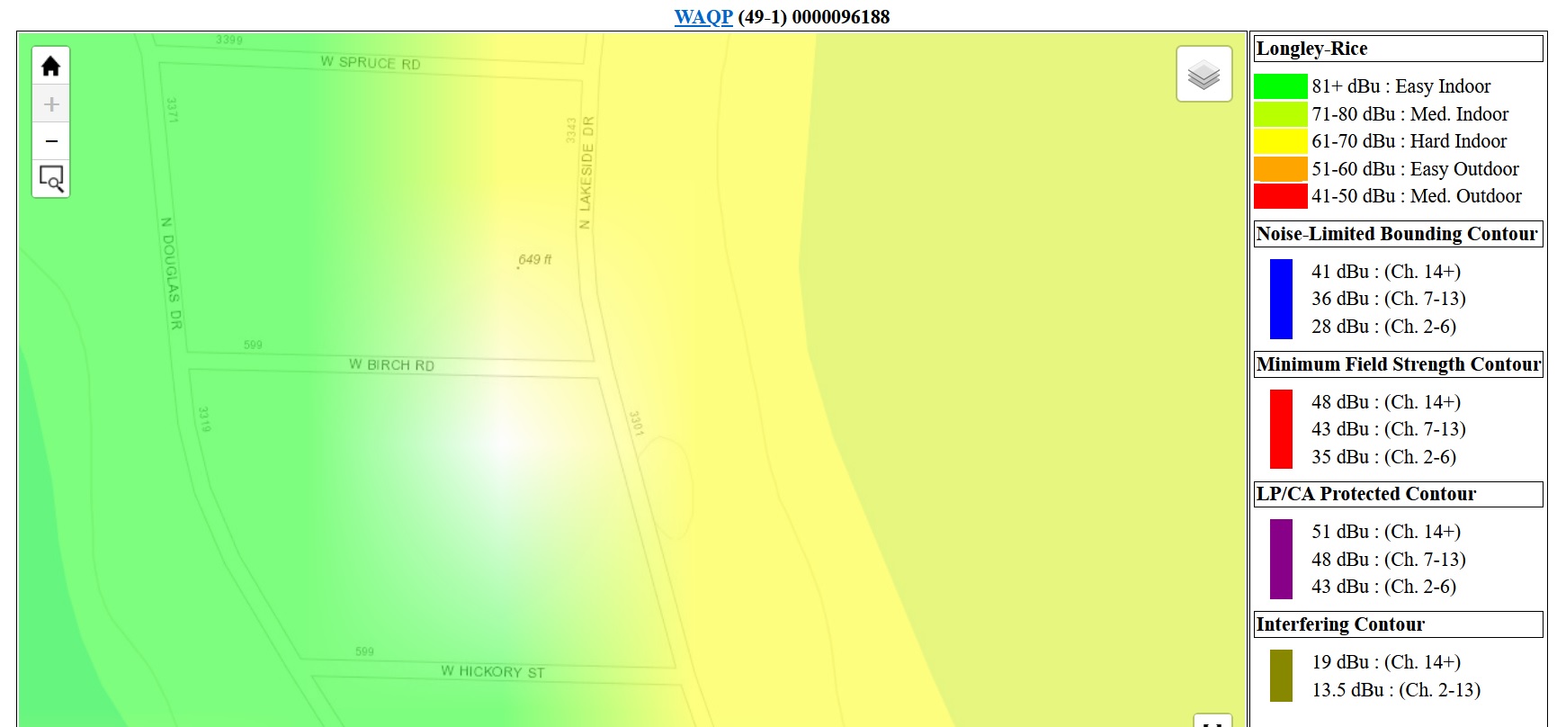

What is the WHITE area showing on this print, as it's hovering almost right over where my antenna is. Is it some sort of suspected signal hole?
So, to start, the coverage map and the report use two different pieces of software. The map is made with SPLAT! and the report is done with the FCC's TVStudy software. They can and sometimes do disagree, even though both are Longley-Rice. (Different underlying terrain data, different code implementing the model, etc.)
To answer the exact question, yes, the white indicates a spot where SPLAT! is predicting a hole in the coverage. It's interesting that TVStudy doesn't predict the same drop-off that SPLAT! does. It would be interesting to see what the signal looks like on a spectrum analyzer, as I am inclined to trust TVStudy over SPLAT! personally.
I also looked at the cell tower situation and while you're right about the distance, it also looks to be around the same azimuth you'd be aiming your antenna. It also looks to have both T-Mobile and Dish on it, so almost the entire 600 MHz band is in use from that tower. (30 out of the 35 MHz of downlink.) That said, between the distance and the filtering, that's unlikely to be your issue.

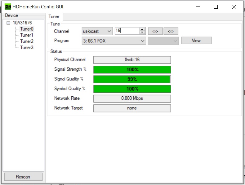

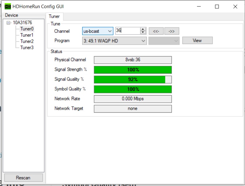

Ok, WJRT-12 (rf12 so high vhf) WSMH-66 (rf16) and WAQP-49 (rf36) towers are ALL in a triangle area close to each other and on the same bearing. I have no issues receiving either WJRT or WSMH. It's just WAQP that's a troublemaker.

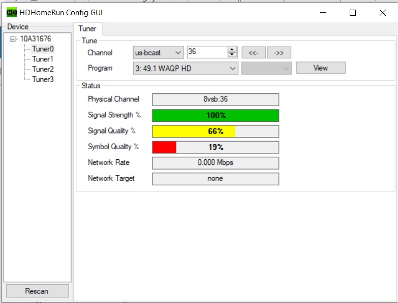

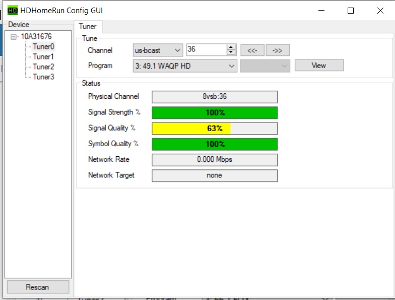

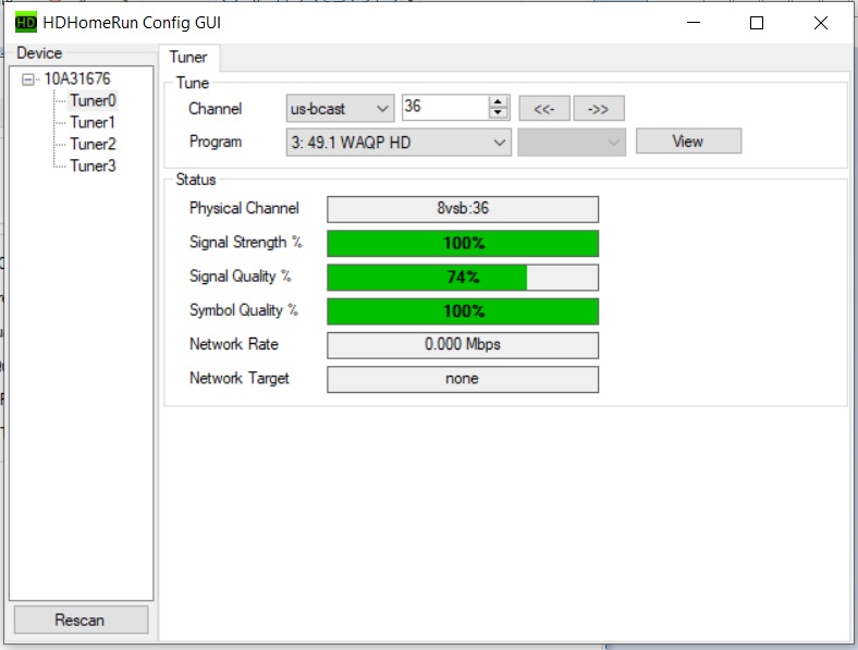

Here's some screenshots taken a few minutes apart from each other. Top one is where it was oscillating badly enough to drop out. Bottom one is WSMH rf16 taken at the same time. It never varied like WAQP.
WAQP levels: at 79% (-37dBm) Signal Quality = 24dB MER, BER: 0.00E +00
It's been raining this morning, and it's behaving at present, so I can't get readings again for when it drops out. I do know WHEN that happens, MER & BER fluctuate wildly for a short period.
waqpdrop.jpgwaqphigh.jpgwaqphighest.jpgwaqplow.jpgwsmhhdhr.jpg:
Go figure, right now (3:56pm) WAQP is at 100 100 100 (-37dBm) everything, which is:
32.7 MER BER: 0.00E+00
All solid, no issues at all. NO DIFFERENCE in weather, except it's now very windy, with 14 mph wind gusts, and tree leaves are waggling like crazy! I'd think that would make it act up, YET, it's locked solid! This makes no frigging sense! dxinfocentre.com TROPO report shows as "marginal" right now also.

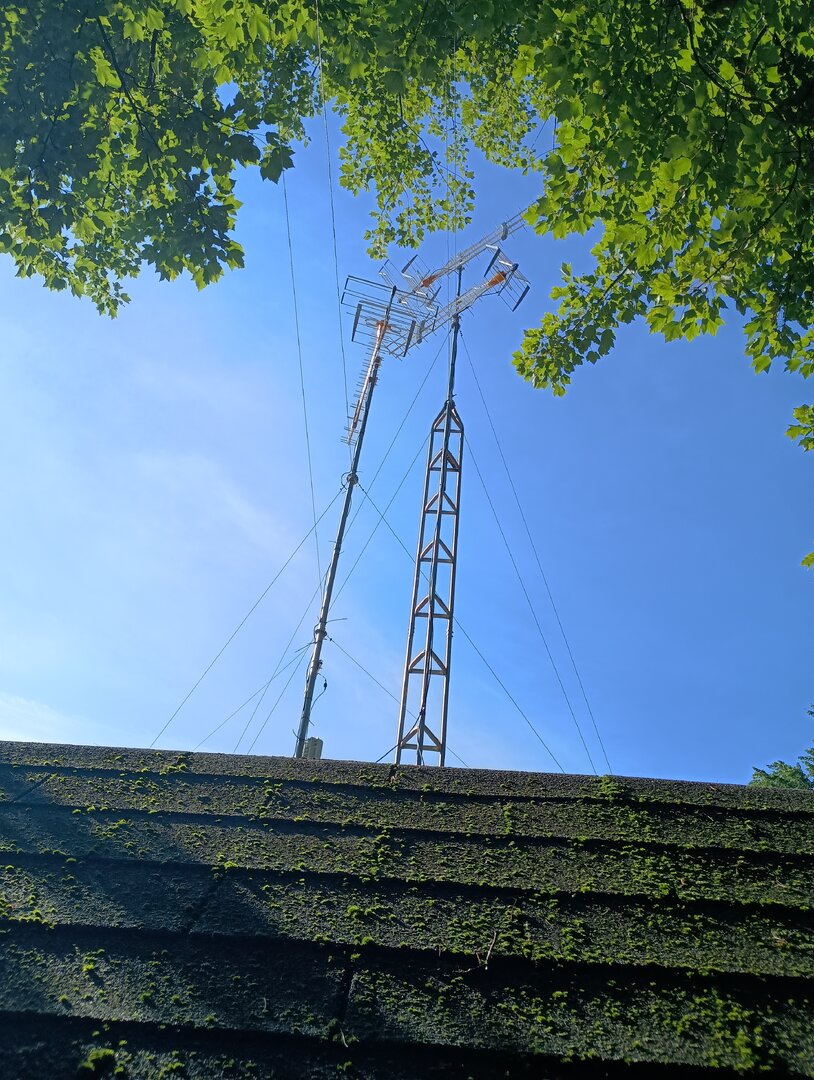

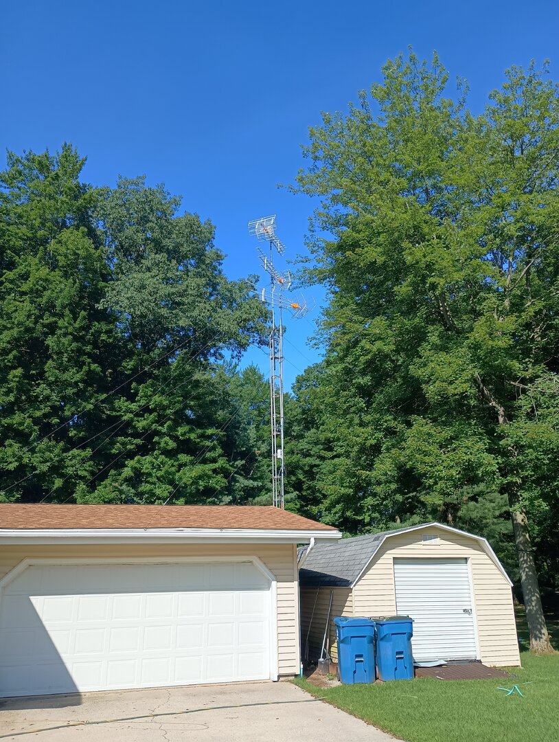

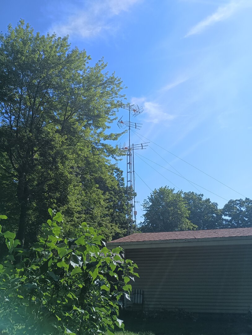

To top it off, IF the signal hole thing that shows on that one report for WAQP is LEGIT, I aim directly through that with one 149884 antenna to pick up WCMU rf26 and WWTV rf9, and it doesn't apparently affect those channels at all.
Top antenna 42'~ is the one pointed for rf26 and rf9, through the so-called signal hole
Middle antenna 35'~ is pointed for rf15 and rf30.
Bottom antenna 30'~ is for all the rest, and the one rf36 is presently being picked up from.
Neighborhood is oak, maple and pine trees, averaging 85' tall.

That the signal is not consistently flat is interesting. Definitely implies some type of dynamic multipath--something that's moving around. What that is, I'm not sure. What else have you tried? Like, have you tried using a different antenna at a different location just to see if it's better in different conditions? In theory, based on your report, WAQP should be workable with even an indoor antenna; it might be worth trying it out just to see what happens.
The map doesn't work the way you're implying it does; you don't look "through" a dead spot and then have less signal on the other side. Each point on the map is computed for its predicted signal level. Assuming the prediction is accurate, you should expect the color to roughly align with what you're seeing in terms of signal.

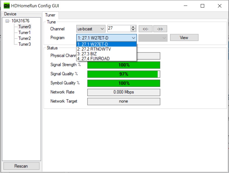

Ok, Trip , I reprogrammed my SmartKom to pick up both these stations. Didn't re-aim anything, just set the very top 149884 that's pointed for WCMU RF26 MT Pleasant and WWTV RF9 Cadillac to also pick up the new Rf27 and Rf31, since it's aimed closest that way of the antennas, yet slightly more North-West because of splitting the difference between the tower locations of WCMU & WWTV, which are my main focus for it.
Anyway, here's what I have:
W27ET-D: Comes in solid on the HDHR 4k Flex 100/81/100%
.1 = Something called "Victory" which has a religious talk show on it
.2 = RTNOWTV presently has a frozen picture, looks like the encoder might need rebooting
.3 = "BIZ"
.4 = Fun Roads Tv
W31FF-D: Flaky signal on this one, won't stay locked, but does work for a few seconds here and there. I think the main beam is aimed more towards it's towers South-West, thus away from me. It has EXACTLY the same sub-channel lineup as W27ET-D, along with .2 RTNOWTV having a frozen picture.
