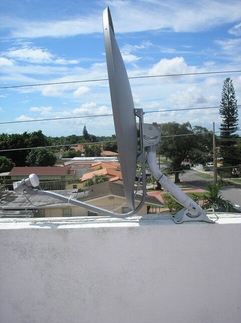

Here some addtl info + Pictures

SatelliteAV: Thank you also for get me clear about this inclinometer stuff. So basically this tool is not worth to try to use it. I am attaching some pcitures as you requested.
I have done this two changes however I still can not get Hispasat and to be honest any other sat. So I am very much blaming myself on this.
I am thking that probably I am beginning on FTA with a hard to get Satellite. Do you think I should try an easy to get satellite and then move to Hispasat? if that is so, can you tell me wich satellite with free TV programming I should try from my location ( Zip 33142).
Here a the pictures of my setup.

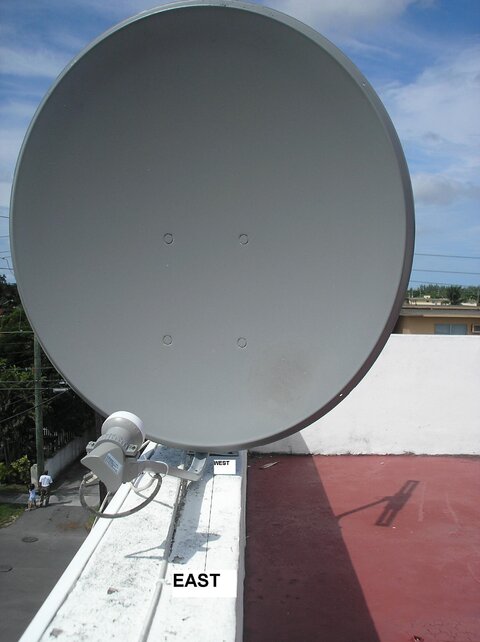

You look pretty close with that setup, have you tried varying the elevation on your dish by very much? I'd say go up and down by as much as 10degrees, slowly pan the dish side to side while your receiver is set to an active transponder on your target. The viewsat quality meter should jump a bit when you get close, takes patience and time. Unless there's some obstruction between your dish and the satellite, you should get it eventually.
Thanks for posting the photos.

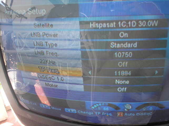

  1. The receiver settings are correct as long as the polarity and symbol rate are set in the second window.

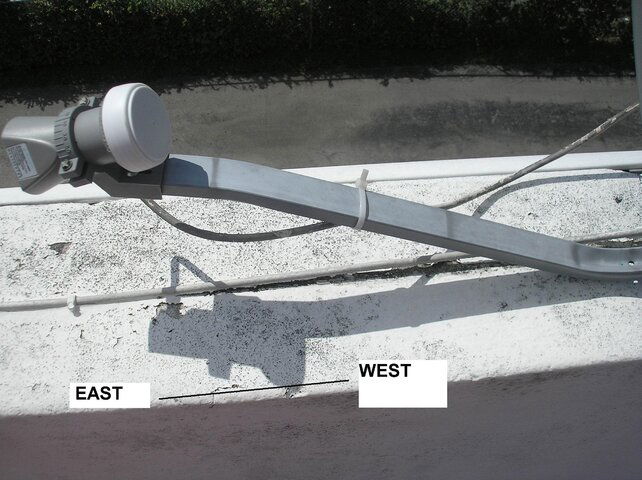

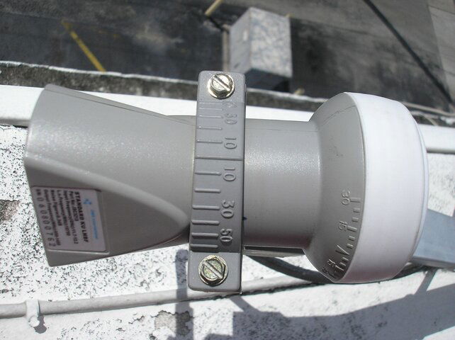

  2. The LNBF setting is correct. When aiming east, the LNBF is twisted Clockwise. When aiming west the LNBF Skew is twisted Counter-Clockwise.

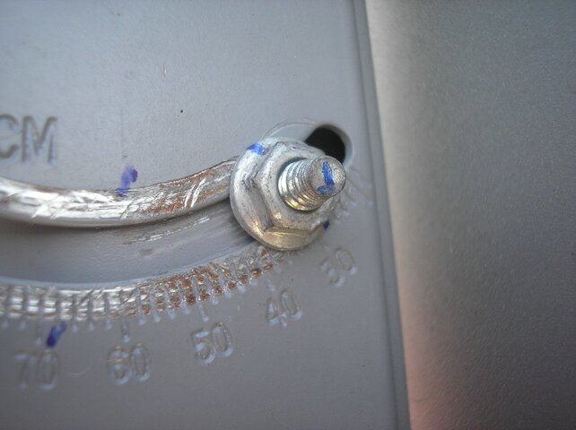

  3. The dish setting appears to be possibly slightly low. What is the brand of the dish? Do the specification of the dish indicate the offset angle? If so, then the face of the dish can be used to measure the exact elevation angle using the inclinometer. Does the dish assembly instructions indicate what part of the bracket is used for the elevation pointer? Some dish designs use the center of the bolt as the pointer and others use a metal pointer which is visible through the elevation scale.

I second Iceberg on moving the LNB all the way back on the holder to grab it by the neck right almost at the head.
Make sure there are no obstructions for that bird and try a range of +/- 5 degrees around the elevation angle because most dish (and also because the pole not being plumb) could be up to 4 degrees off on their Elev Scale.

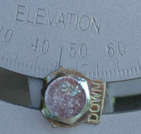

. . . Does the dish assembly instructions indicate what part of the bracket is used for the elevation pointer?
( the red line in the picture below)
. . . and some have a funny washer-like thing with points on it.

Adjust the Elevation setting. Anole: Thanks for the pictures!!!!
Azimuth changes at very small steps. SatelliteAV: awesome information.
Adjust the receiver settings: Iceberg thank you for you inputs.
Hispasat from my location (Miami, Fl) look a little more that 27.5 elevation I would say almost 30. The same happens with the azimuth it looks like 120. What I did was to move the azimuth until I got the best Strength level that I could (83% while at the same time I had 0% in Quality). Then I move my elevation at very small step until I finally got some Signal Quality. I did continue ajusting my elevation until I got the best I could 73%.
