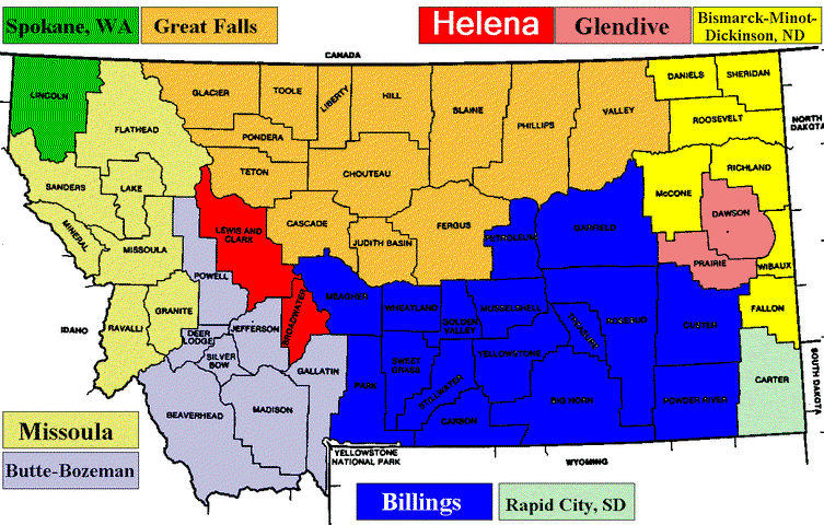

Parts of Eastern Montana are indeed in the Minot DMA with Dish (see map below). Directv doesnt carry locals there yet
now depending on where you are the spotbeam should reach (see below link for the spotbeam)

Well My S.A. or service Address is located at the property I own in the Plentywood area but most of the time im about 2 hrs north lol, im a duel citizen. Im not sure if DTV has to go to the local Minot stations and get the waivers from there or not? I have all east & west nets in S.D. which im planning to drop the West S.D. feeds after I get NBC HD West as thats the only one im missing.
no worries :)
Checking the FCC coverage maps, when everything was analog CBS **was** a station that the FCC claimed was available in Plentywood. With digital its not...
HOWEVER....NBC is covered on digital. Thats why
-you couldnt get analog CBS but can get digital CBS
-you cant get digital NBC
see link
http://www.fcc.gov/dtv/markets/maps_current/Minot-Bismarck-Dickinson_ND.pdf
stations in question are
KUMV (21 & 22)
KXMD (31 & 32)
the red means they claim you cant pick that station up anymore.
So they indeed were going to the Minot stations for waivers
