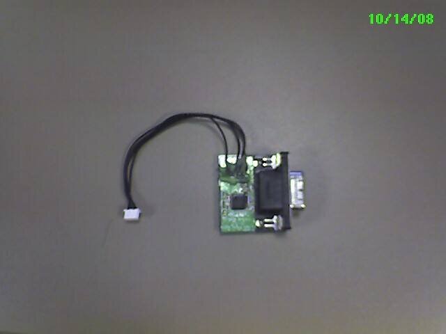

Also you will find on the board RS-232 and JTAG connectors for debugging SW.

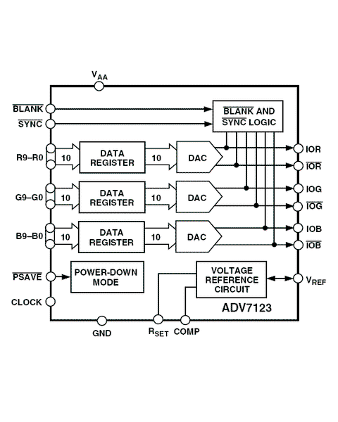

I have a question.
The block diagram appears to show digital RGB out into an Analog Devices ADV7123
I have 2 Zenith DTT900s, they use the LG LGDT1111D. Do all LGDT1111D solutions have digital RGB out from block D2A in the diagram (which I assume is the LGDT1111D)?
Is it possible to tap into the board and get a digital or analog RGB signal? Why does the block diagram show an ADV7123 and a DSUB when it's not on the PCB?
It is normal for multi-functional devices like the LG chip; you'll need reference design info to add the ADV7123 to your box and rewrite FW if the outputs controlled by LG.

Smith, P. or anyone else,
How doe one hookup the RS-233 to the board. I see the connector but does it need an RS-232 interface chip between the computer and the 4 pin connector? If so, I do I get one one. Also what software do you need to access the board via the RS-232?
Teddy
Teddy
Here is zip with files for restore your Venturer flash and EEPROM in case if your box lost it. You'll need desolder the chips and use programmer device for that.
Teddy, used RS-232 board like this:

You should be able to flash the EEPROM via the JTAG port without removing the chip.
Also, it's likely that a boot loader exists to allow firmware updating via the RS-232 port.

I would like to see how you managed JTAG or RS-232 reflashing.
Share please what SW and HW you use for that.
