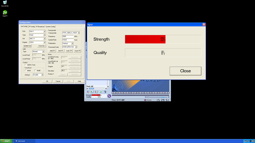

I tried that and I get zero quality. My Strength is at 91%, but when I try to lock it falls to 53%. It must be something wrong with the dvb card.

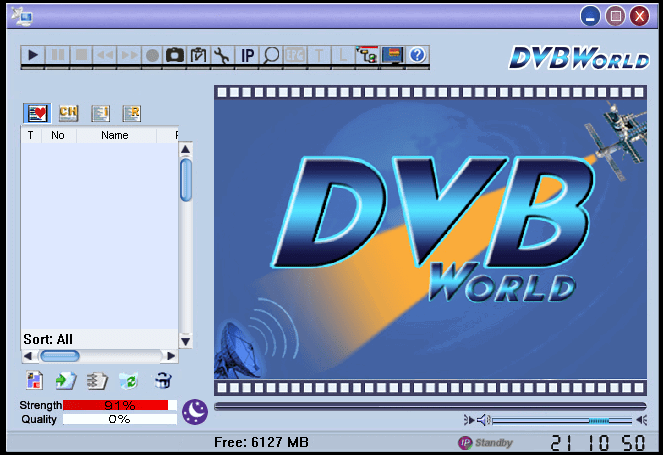

I connected the lnb directly to the dvb card and the only difference I noticed was when I tried to lock the signal the Strength dropped from 91% to 61%. When I had the card connected to the analog receiver with a splitter the Strength dropped from 91% to 53%. In both cases Quality is 0%.
Yes, I am running the latest DVB world software.
I noticed a poster said his Strength and quality bars are green. Even when my Strength is at 91% it is still red. Maybe I still have some setting wrong?

I was looking at the images in message 5, and I noticed something. I noticed that it indicated that you were using "Normal" for LNB type, and in the grayed out boxes below, it listed 5150 for LO1 and 5750 for LO2 . I don't know how the software you're using works, but is it possible that the thing is somehow trying to use LO2 instead of LO1??? Usually, when 2 LO freqs are indicated, there is some switchover freq parameter, but I don't see anything like that in the display. Anyway, probably not the problem, but you might try to change both LO freqs to 5150, which might require switching to some other (like standard or single) LNB type. If it's using the wrong LO, then you probably aren't tuning the frequency you think you're tuning.
The other thing that came to mind. When you connected directly to the coax from the LNB, I'd recommend setting your program on horizontal polarity (not a bad idea even when slaved through the splitter), since when set on vertical the card is only putting out 13V, which often isn't enough to power a BUD LNB.
EDIT: one other idea, again not knowing what "Normal" refers to on your software. I thought that perhaps Normal means that it isn't using a LO freq, but is just using the raw IF freq. If that is the case, try using 1222 for your frequency instead of 3928. Just a thought.
