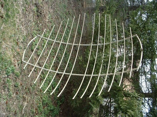

OK, So I took the time to dig out, and partially assemble my old UFH antenna. The way it stands now (if things work out the way I hope) I'll have a warped 7 foot BUD when I'm finished. Some of the elements are slightly out of true. I hope to make this better by finding the focal point and using a piece of string to bring the elements closer to where they belong. I also noticed that the LNB will be looking directly down the antenna arm. I don't know much about this, but I think that I might need a button hook design of some kind.
Tonight, in the name of Science, I plan to fabricate a complex Duct-Tape LNB bracket, and try to use an old circular LNB and my "Outdoor NASA alignment tool" (An old DTV receiver :) ) to try to see if I can get any signal strength on a DTV bird. This will be without any screen modification. I think that the reflector element spacing (as it stands now) wont work at all for this frequency, but I'm really interested in seeing what it might do. If this wont work, I'll dig out my nine dollar satellite pwr. meter and see what comes of that.
Anyone want to hazard a guess on my chances of making this work?
Any guesses on the amount of power I might find (not find) tonight?
At least I'll be ready for OTA DTV, Tron :)
Edit- Oops, I forgot to rotate my picture! :)

The W1GHZ Online Microwave Antenna Book. Try this book for ideas.
I think it can be done. But I'm sure you'll run into the problem of doing 30db of work for 3db of gain.
The antenna might be perfectly engineered for UHF frequencies, although you might find it completely out of whack in the microwave band.
Browsing through Chapter 4 it seems that as long as the dish is reasonably parabolic, the critical step will be finding the focus. It will be interesting to see what you discover.
Good Luck.
I just got back from working with the dish. So far I have nothing. I'm not really surprised....I will admit that I had hoped to get at least get a bar or two on the level indicator. I'm having the misfortune of misplacing my power meter. :(
Thanks for the excellent link Tek465m. I've only had time to skim chapter four. I think you're right about the focus. I've been moving it up and down, but it's hard when you don't even know if you're focused on a satellite. I guess that I'll have to invest the time in screening it somehow. Sure do wish that I could find that power meter!
