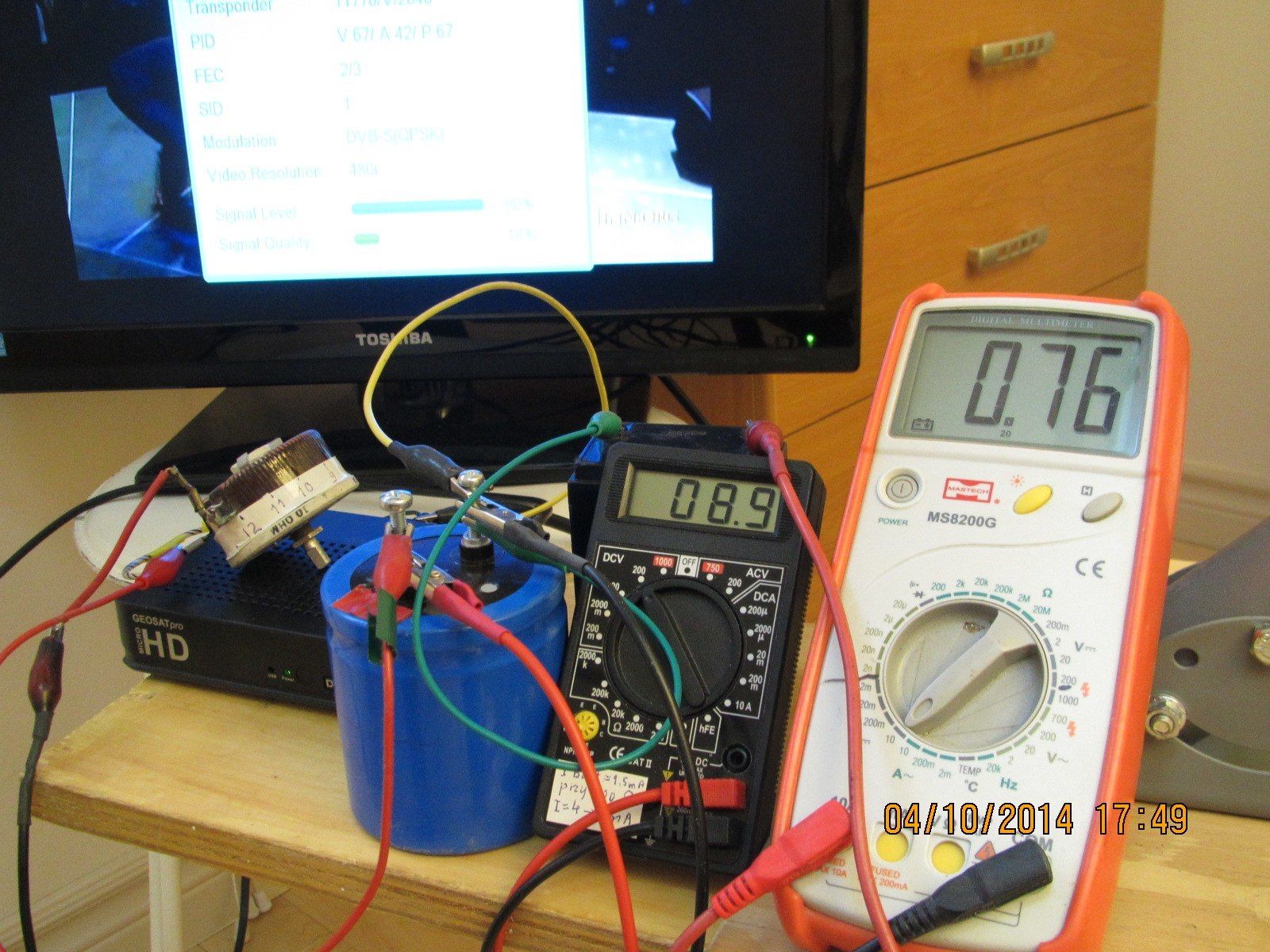

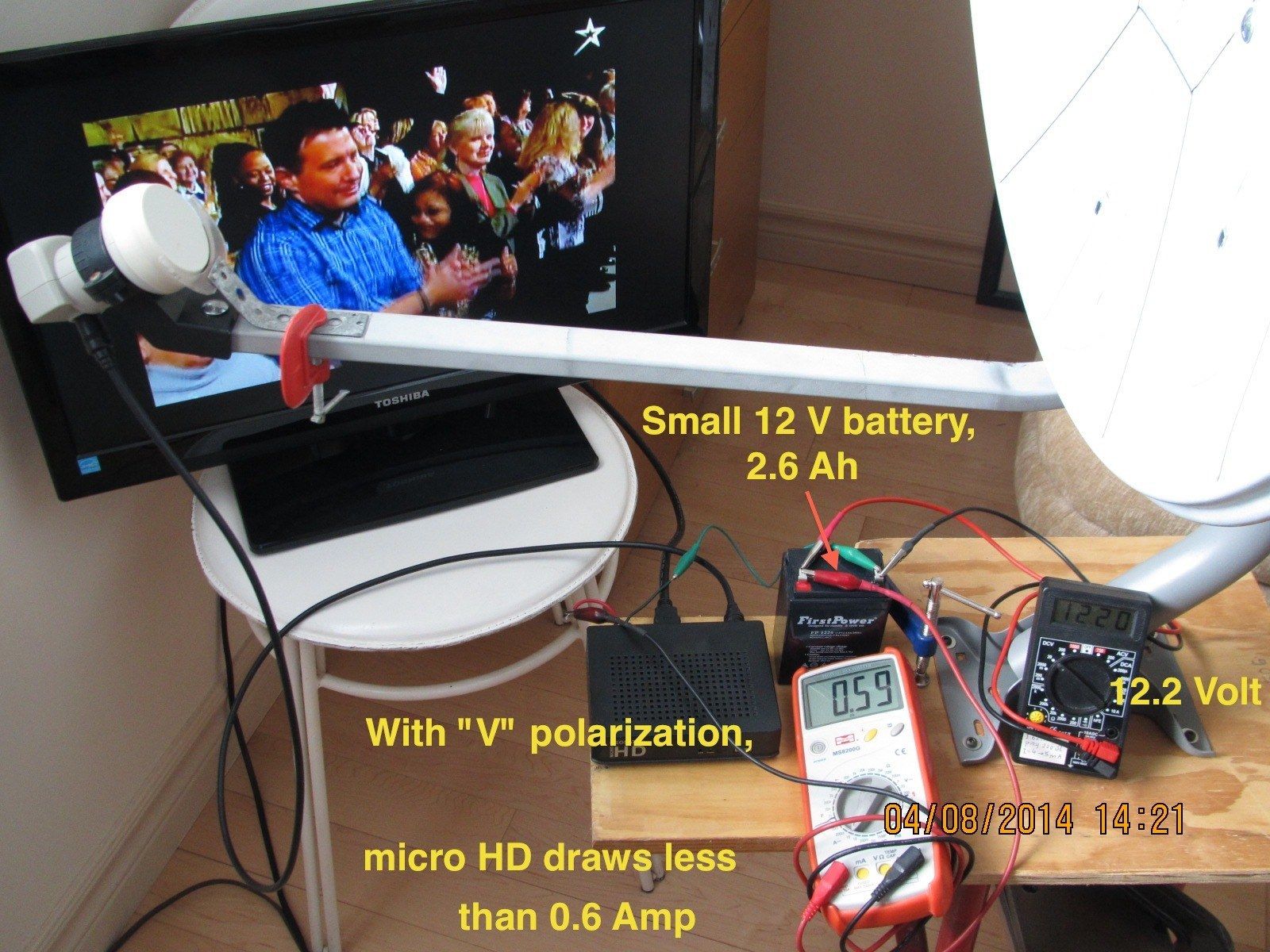

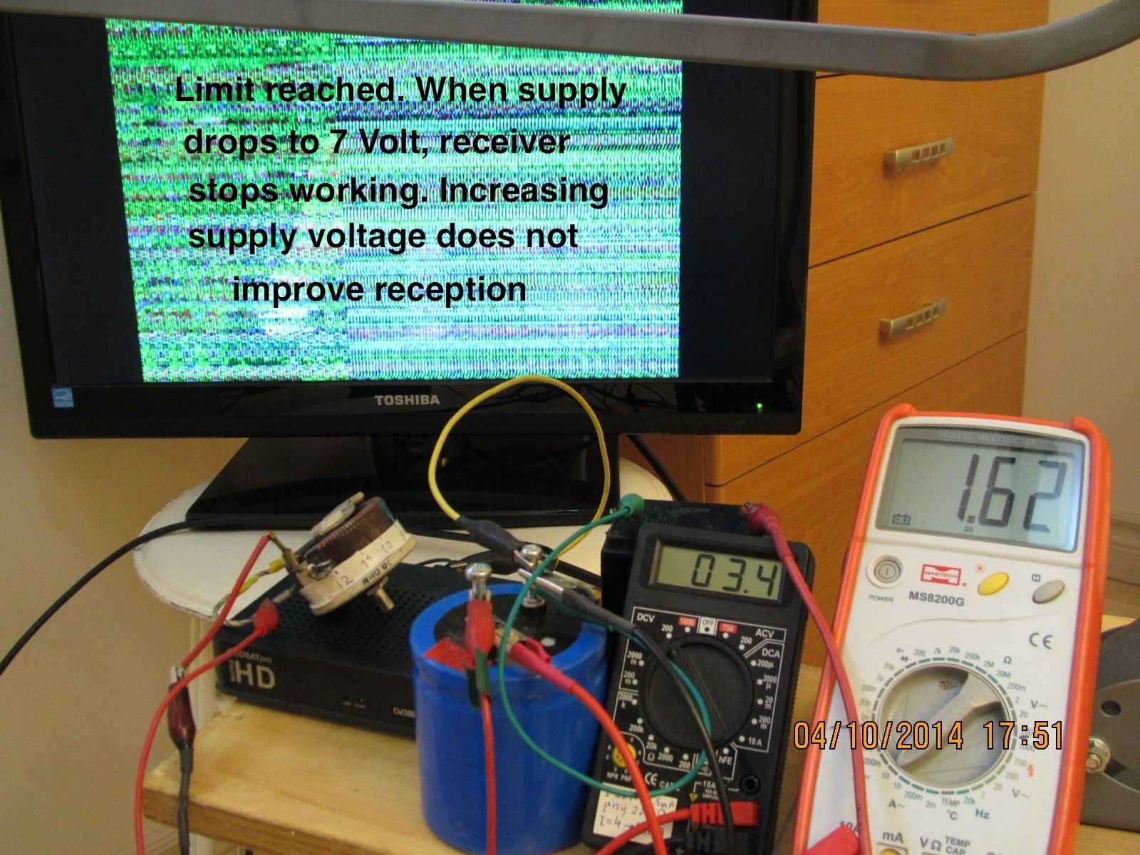

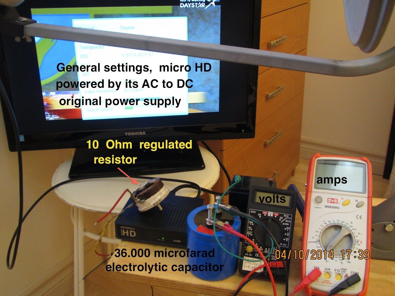

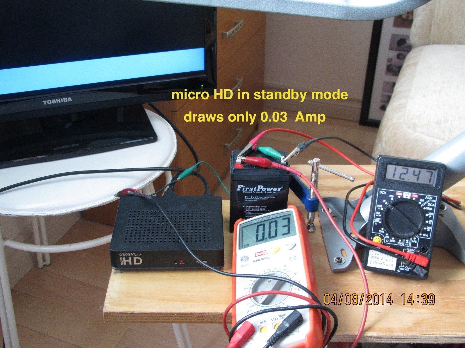

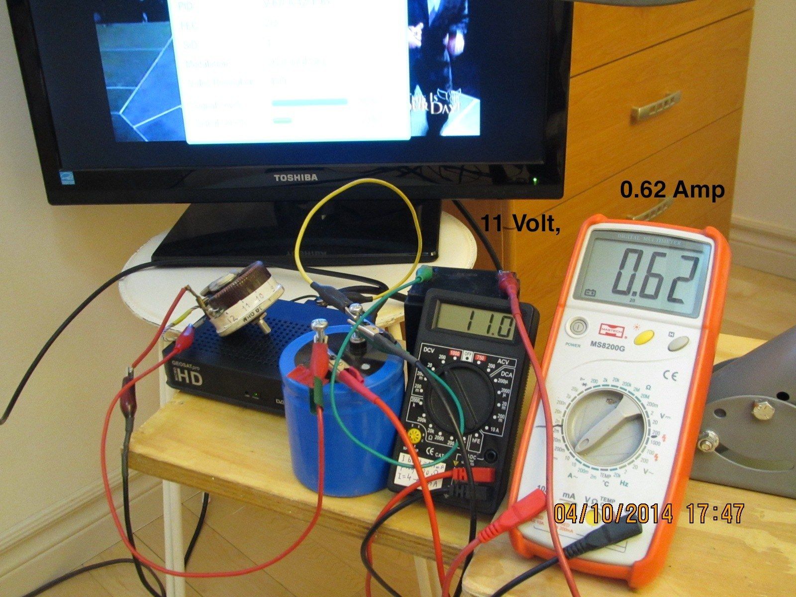

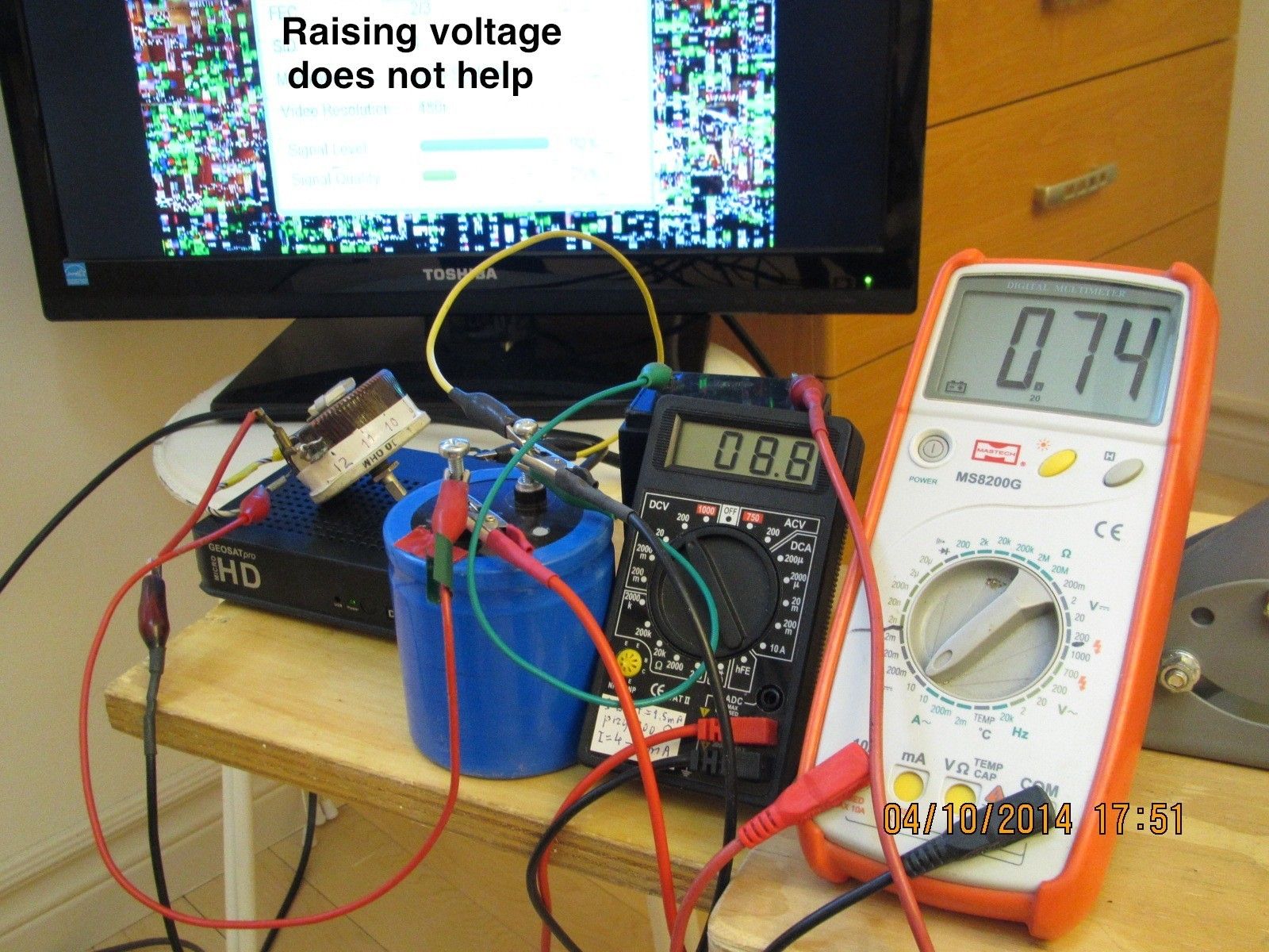

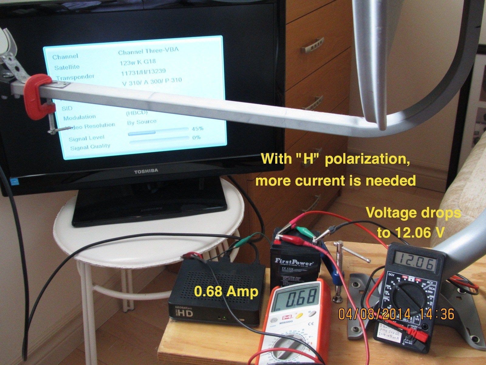

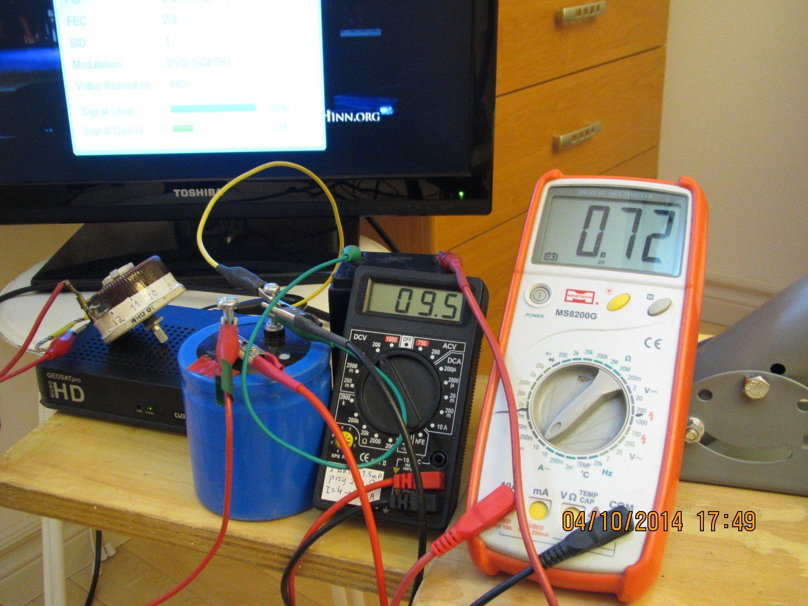

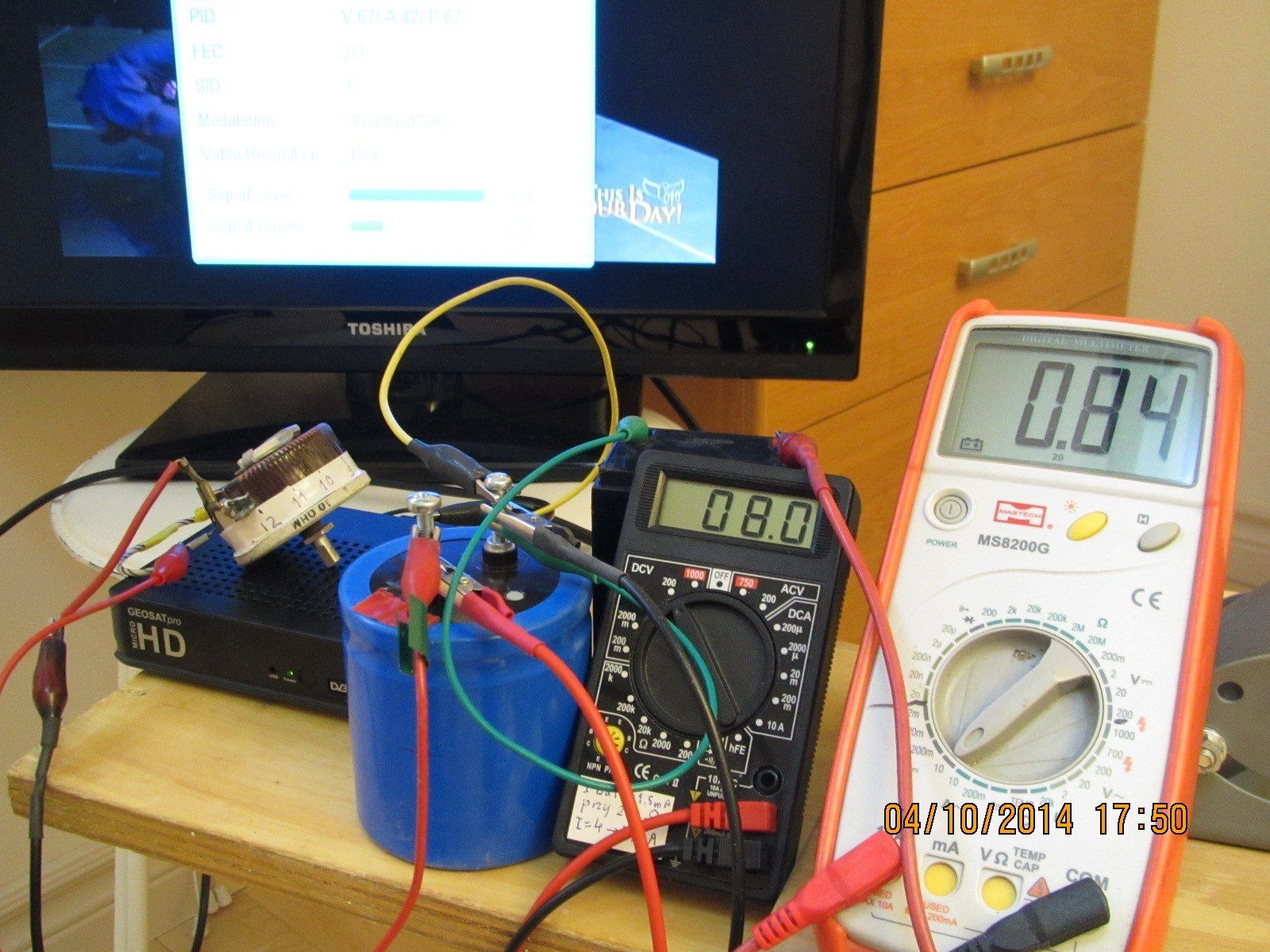

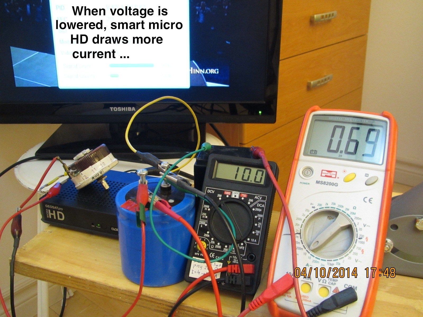

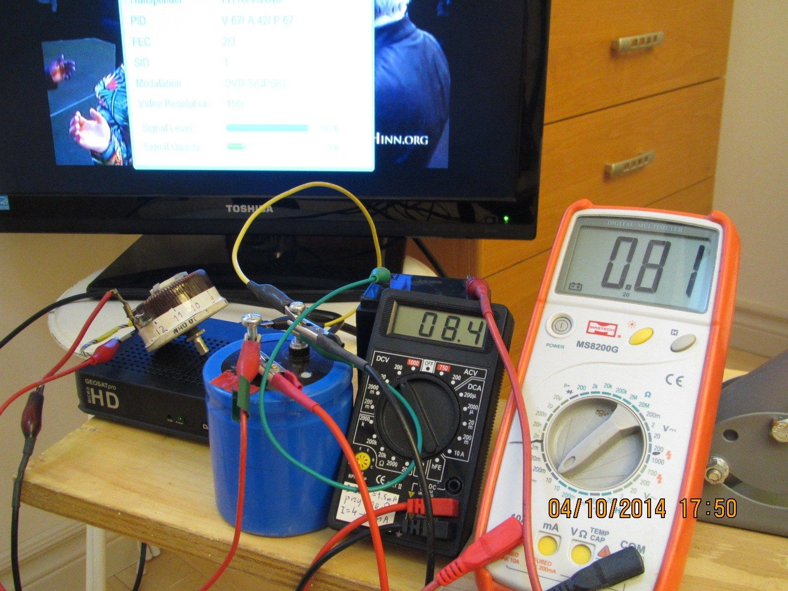

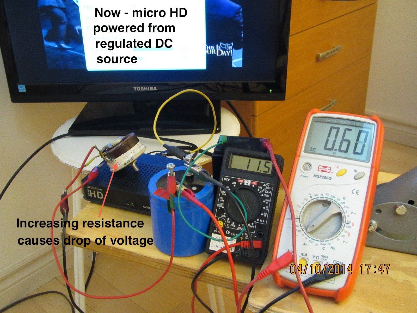

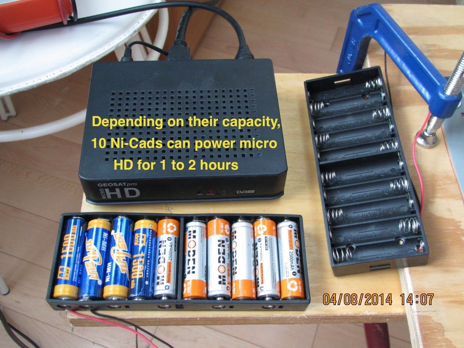

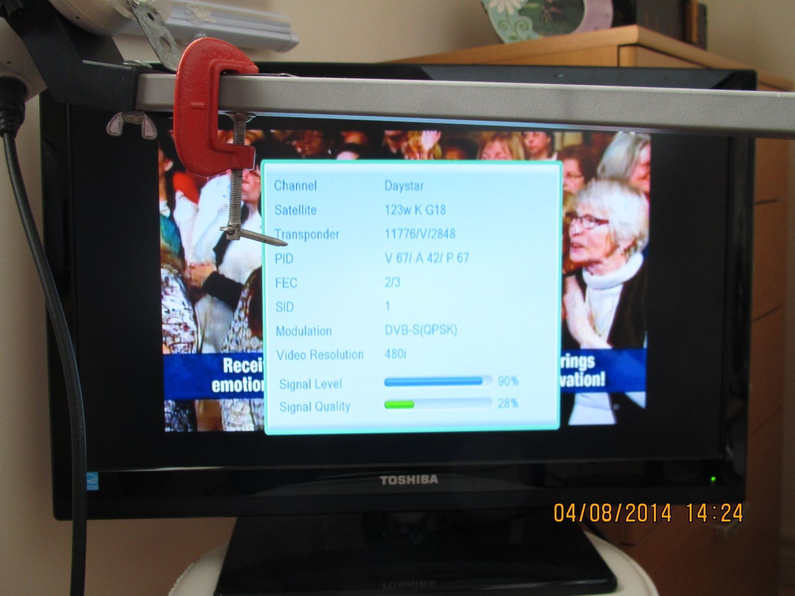

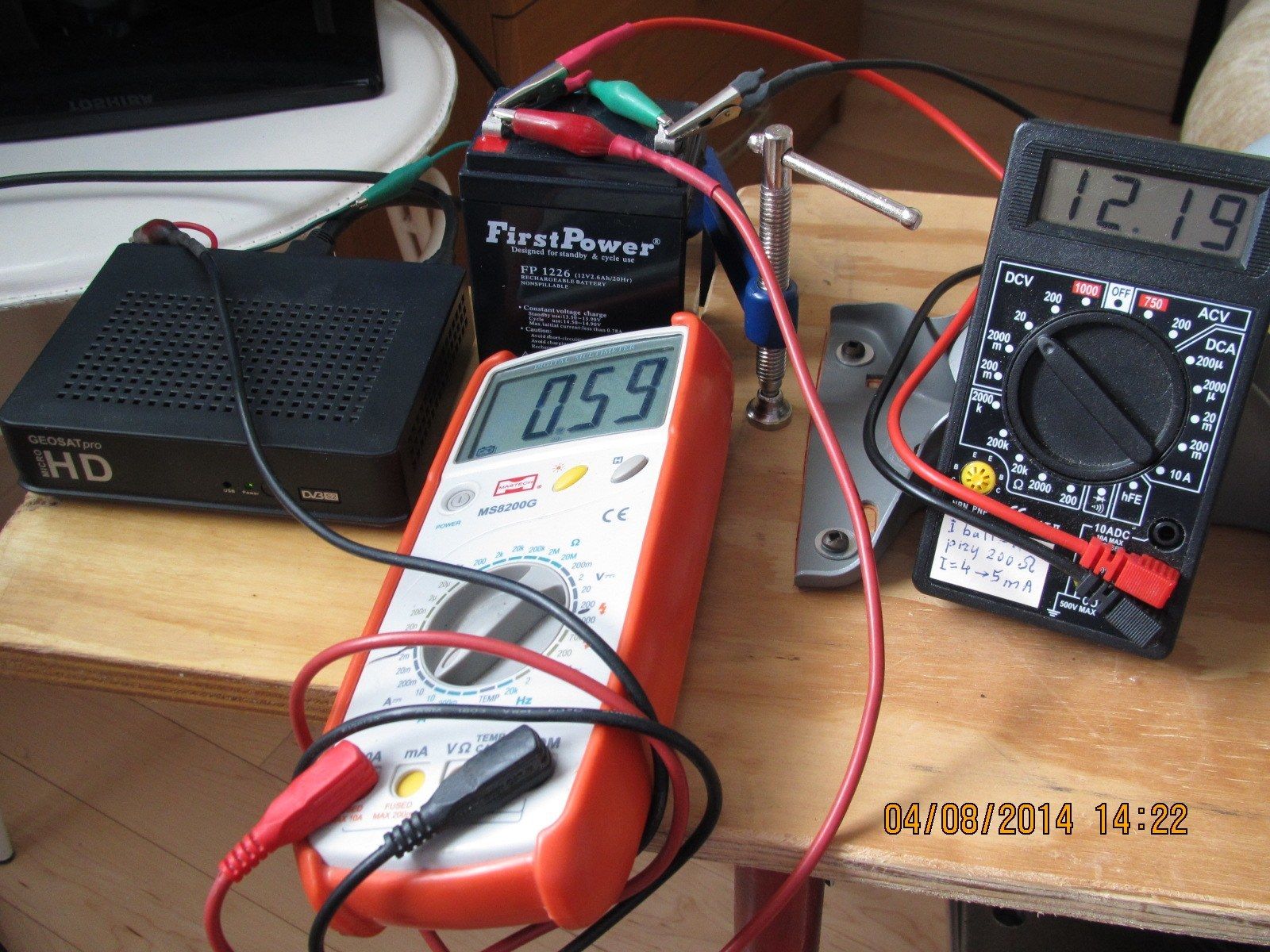

Current needed for micro HD:
Even small 12 V battery can do the job for 1/2 to 1 hour, as the micro HD needs less than 0.7 Amp to work. A few pictures follow.

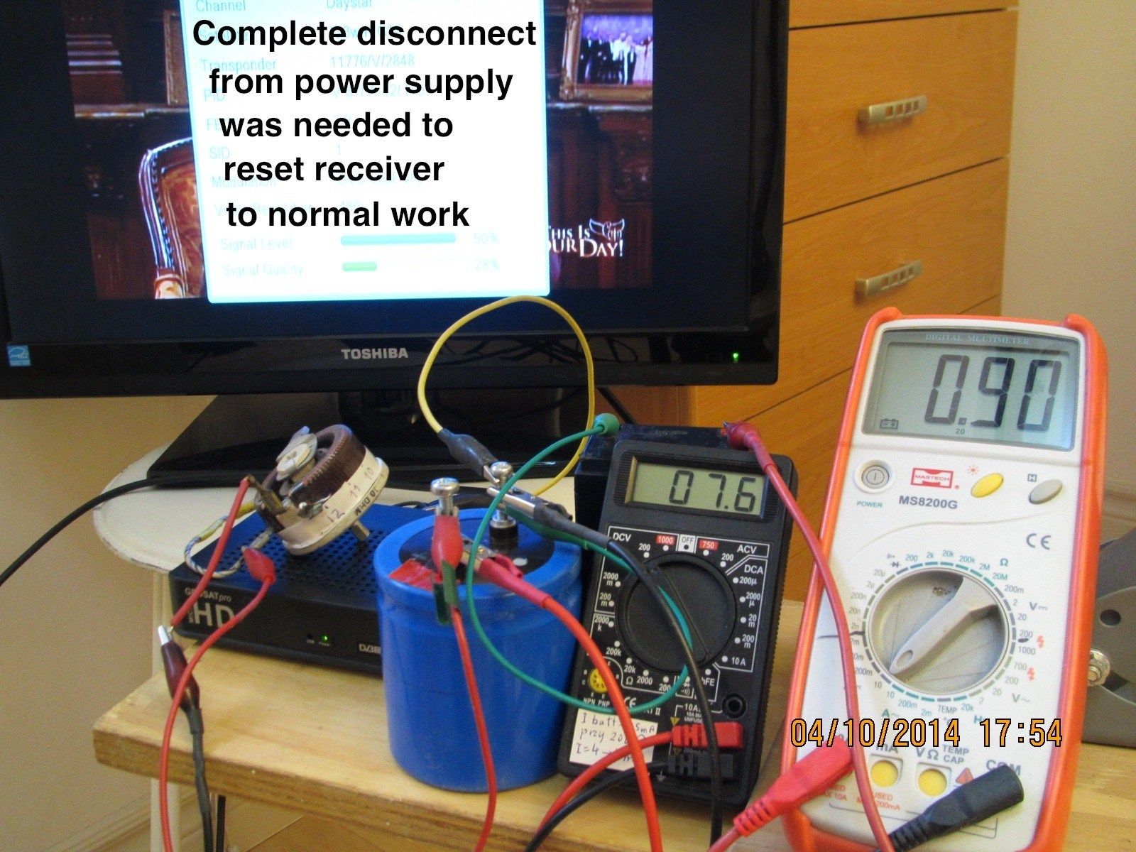

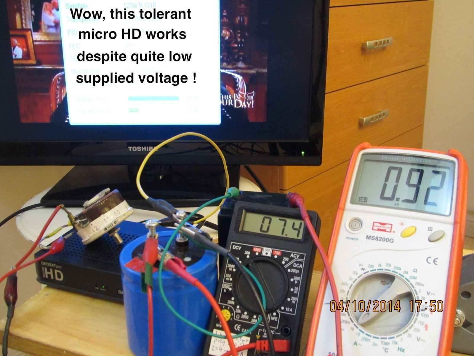

True, receiver, being not-linear device, has the ability to "take" what it really needs.
The micro HD is wonderfully tolerant to voltages much smaller than nominal.
Twelve annotated pictures follow.
