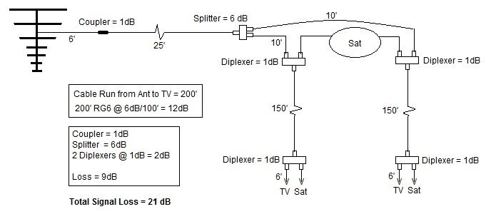

Sorry to keep bothering everyone. I've been watching my signal, and it's been pretty consistent. I got out my calculator and did some figuring, and it appears that my signal loss from my antenna to the house is pretty high. See the attached image. Could someone check over my figures and suggest an amp/pre-amp that would fit my needs? Apparently there's plenty signal where I now have it, but most of it is lost on its way to the TV.
A 2 way splitter is normally calculated as 3.5 dB of loss or 1/2 your signal so if possible add your distribution amp before the 2 way splitter. In post 5 you said you have a 15dB distribution amp so give it a try. You show 2 150' cable runs between the diplexers, can that be shortened?
Agree with boba - shorten any cable run that you can as there is loss incurred there as well, especially over long lengths like you are using. The higher the frequency, the higher the loss. This page from Channel Master will give you an idea just how much: http://support.channelmaster.com/hc...Signal-Do-I-Lose-Going-Through-Coaxial-Cable- Also as boba said, if you use an amplifier, put it before the splitter and as close to the antenna as possible, if that is possible. Amplifiers amplify noise as well as the tv signal so you want to amplify the signal before it is degraded by the long run. Good Luck!:)

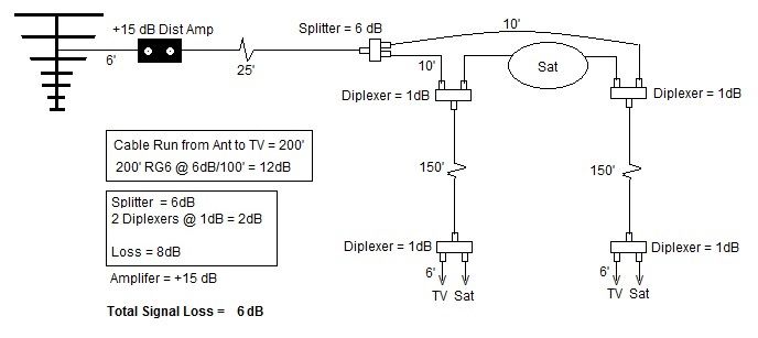

So if I replace the coupler with the distribution amp, I should get something like this:
I can't shorten the 150 foot runs because my satellite dish is a good distance from my house in order to see over the hills. I can probably shorten the 25 foot run by a few feet and get another .5 dB.
Another question then arises. If the amplifier is located 6' from the antenna then you are definitely using it outside. Is the distribution amp outdoor rated and can you safely run power to it without the risk of electrocution? Probably not. If this is a plug in distribution amp then we are talking about 120 volts of AC power sitting on the antenna mast. It would be safer to install a mast mounted preamp such as this http://www.solidsignal.com/pview.asp?mc=03&p=CM-7777&d=Channel-Master-Titan2-TV-Antenna-Preamp-w-Power-Supply(CM7777)&c=Pre-Amplifiers&sku=02057207774. It's injector is usually plugged in safely inside your home but since the antenna feed needs to move on to the satellite dish that's not likely possible. You could place the power injector just before the splitter if there is a weather protected GFCI outlet available nearby.
