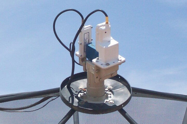

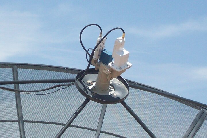

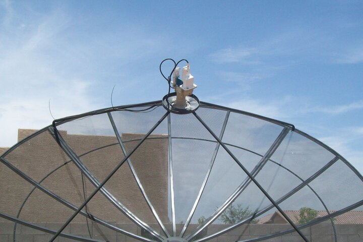

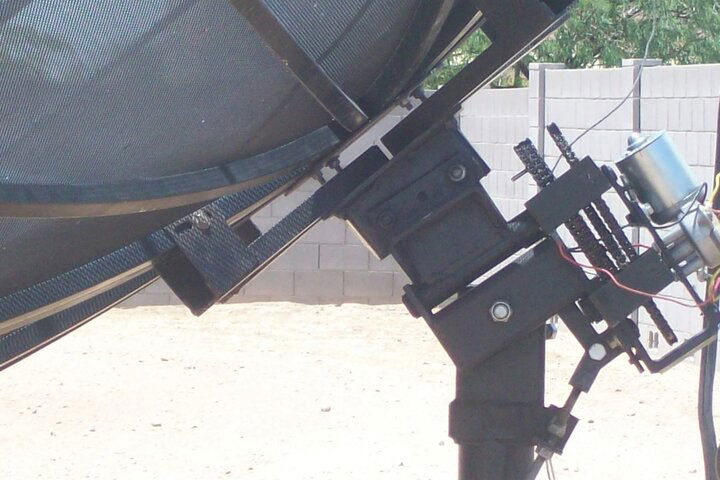

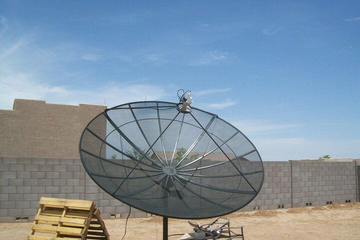

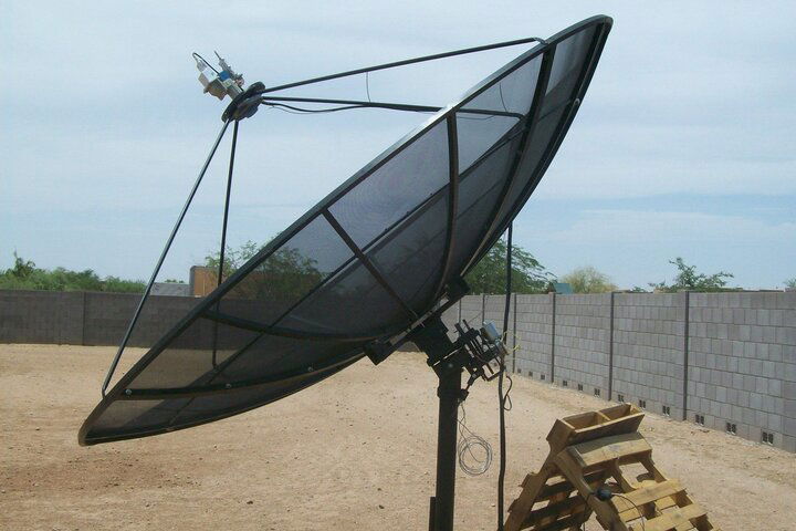

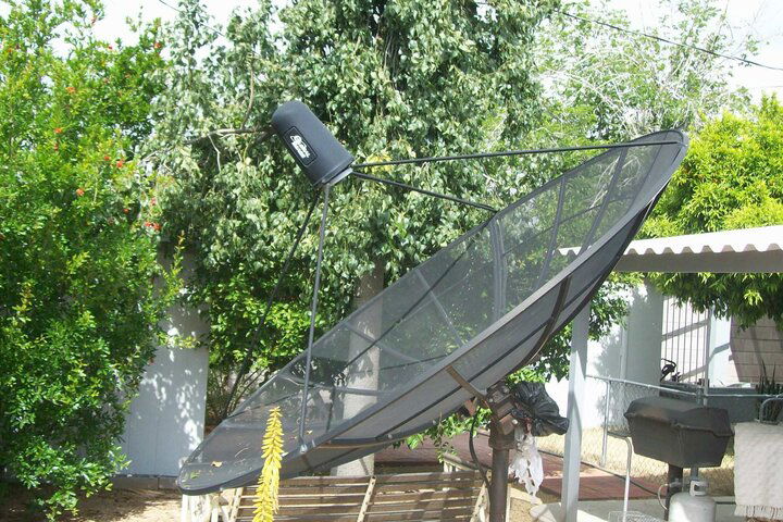

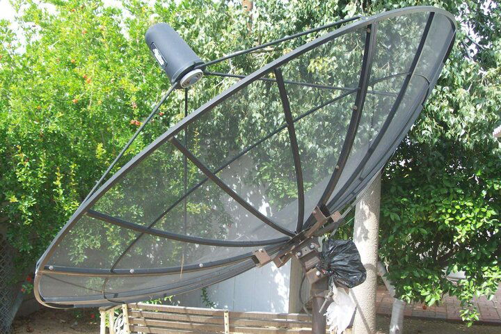

Trying to adjust the feed horn and azmith and ele. by useing a t.v. a fortec receiver and a sat. finder and its not working out very well.Idownloaded some pics. and may by lookig at these pics some one can get me started. I did stumble on to D121 but the recevier said 107w The angle of the dish looks to high my 33" dish looks to be lower.And is the lnb cband & ku look like the right place cband at around 5 oclock and ku about 11 oclock.

do you're self a favor, an go an buy a angle finder it will help a great deal, price on them from $10 to $80 for a fancy digital it will make this job so easy.

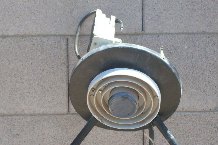

1 problem that I see from the picture's is you feed legs an bolt hole location that you used bolting to the dish. you need to use the hole closest to the bend on the dish where they bolt, an on the scalar the same hole also, an if you have a Channel Master scalar ring you should use that also instead of the chaperral. reason why is the CM scalar will have 2 bolts per leg an it makes those CM dishes more rigid by using their scalar. now those CM dishes they have their F/L work out real good as long as you use the right bolt holes.

Offset vs prime focus 'look angles' are apples and kumquats. Ignore the offset dish for elevation look angle. It might come in handy for general azmuith though.

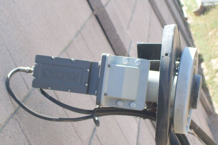

Note the polarity of the dipole in the feed horn. You will need to stand behind the dish and look up into the feedhorn. It is a small wire, or hook looking piece with a section of it parallel with the dish surface. It is ~5/8-3/4" and appears suspended in the center of the feedhorn.

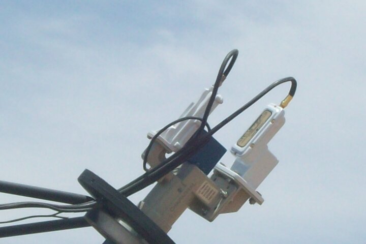

Been away for a few days working.Thanks 1captain & melgarga for the responce i guess an angle finder would help , i thought that I got dish 30 miles away that a lot of adjustments would be the same.Any way there are three holes on the feed legs and I just used the hole were I took it apart from as in old owners location pics 1&2 pics3 is the orginal ku/lnb. and the scalar ring i keep the CM orginal and put the dual lnb ku/cband in to. 1captain a mesurment of the focal point would be great (befor i took the old lnb i mesured F/L 47 3/4 inches from the center of the dish to lnb ring) and my cband lnb i have at around 5 oclock and ku at 11 oclock

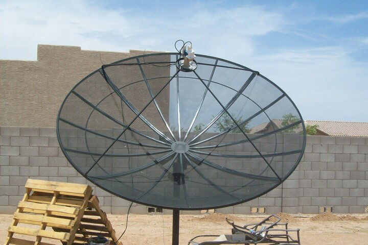

Now I think i am in the home stretch but its 115 degrees out and it is just to hot to mess with it, have a small window in the morning to work on it.Any how try to return them to the original positions I don't know were that is so i will have to adjusted the inclination and declination settings. The true south sat my long. is 112.5 w and long is latis 33.7 w i thought it would be 111.7 or 113.0w satmex 6 i don't know which sat. is best to test?

Well if you think you've whacked the adjustments beyond getting them back to the original point then stop now and get an angle finder. A dish within 30 miles may have needed a slight tweaking but probably would have gotten some of the stronger TPs if the new pole is plumb and the true south alignment was correct.
