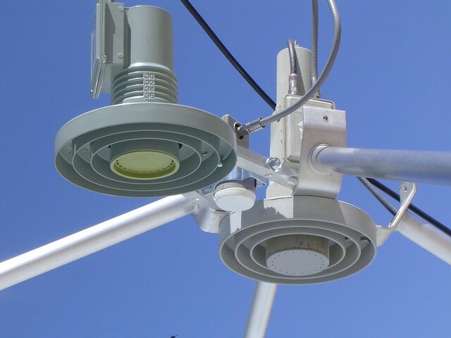

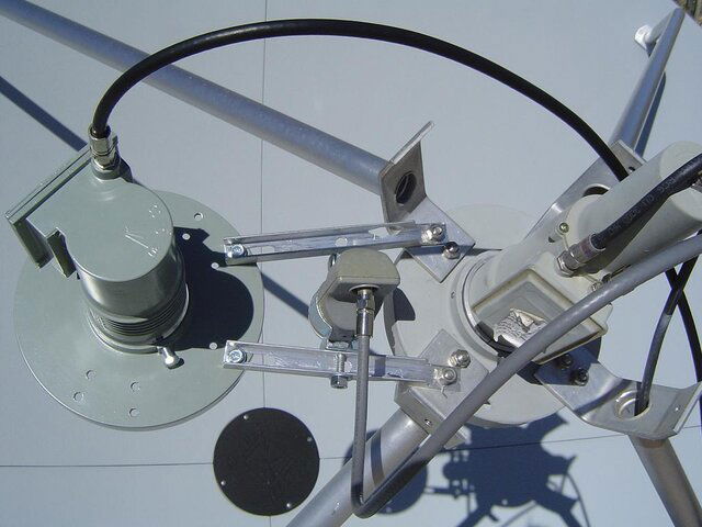

Just thought I'd show you Guys what I did to my 8 ft solid Channel Master BUD. I mounted the extra C-band lnb on it yesterday, the two lnb's are aimed at the 91.0°w and 103.0°w and both are pulling in excellent QS. Today I mounted a Ku linear lnbf in between the two for the 97.0°w Ku sat. It's getting 98% QS on 11842 H 22000 3/4, much better than my 90cm dishes.

Nice!!
Was it difficult to tweak in the signal?
Thanks Guys! kbghdg, it was actually easier than I expected, it was more of a shot in the dark with a lot of guesstimating and after I mounted the scalar ring (the 91w lnb) I bent it down a tad for the curvature of the reflector and stuck in the lnb, hooked it up and there it was. I didn't do any tweaking whatsoever, I'm afraid to fool around with it, you know how that goes, right? This 8 ft Channel Master dish is excellent and so easy to pull in good signals but my 10.5 ft mesh is a mush! I'm having a lot of trouble getting a good signal on anything except for the 99w & 101w strong TP's.

As for your question, the two C-lnb's measure 10 inches apart from center to center, 12° degrees from the 91.0W to the 103.0W, I calculated that each (1) degree is equal to 1.2 inches. This does not apply to all dishes, the size and depth ((F/D) focal distance) of the reflector (dish) will determine where to place the lnb's. A simple method is to connect a lnb to a receiver and a TV at the dish location to see what you're doing, with the receiver set to look at a specific frequency on a specific satellite and watching the onscreen signal meter, hold the lnb in your hand and wand it around slowly in the vicinity of where you think it will be mounted and scan for a signal. Once you find the signal, aim it carefully for the best quality signal (holding it steady) and take note of it's location by measuring the best you can, I just used my hand as a spacer between the two scalar rings and it equalled 3.5 inches (the width of my palm). Then make the mounting bracket, install the lnb and tweak it for maximum signal. If at first you don't succeed, try and try again.

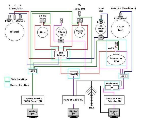

Here's a sketch of my current plans, I'm doing a complete makeover and moving all dishes to the ground. I ordered another motor and will be trying a mini bud on a motor, likely my old Stab HH120 for initial testing.

And many thanks to Cadsulfide!
