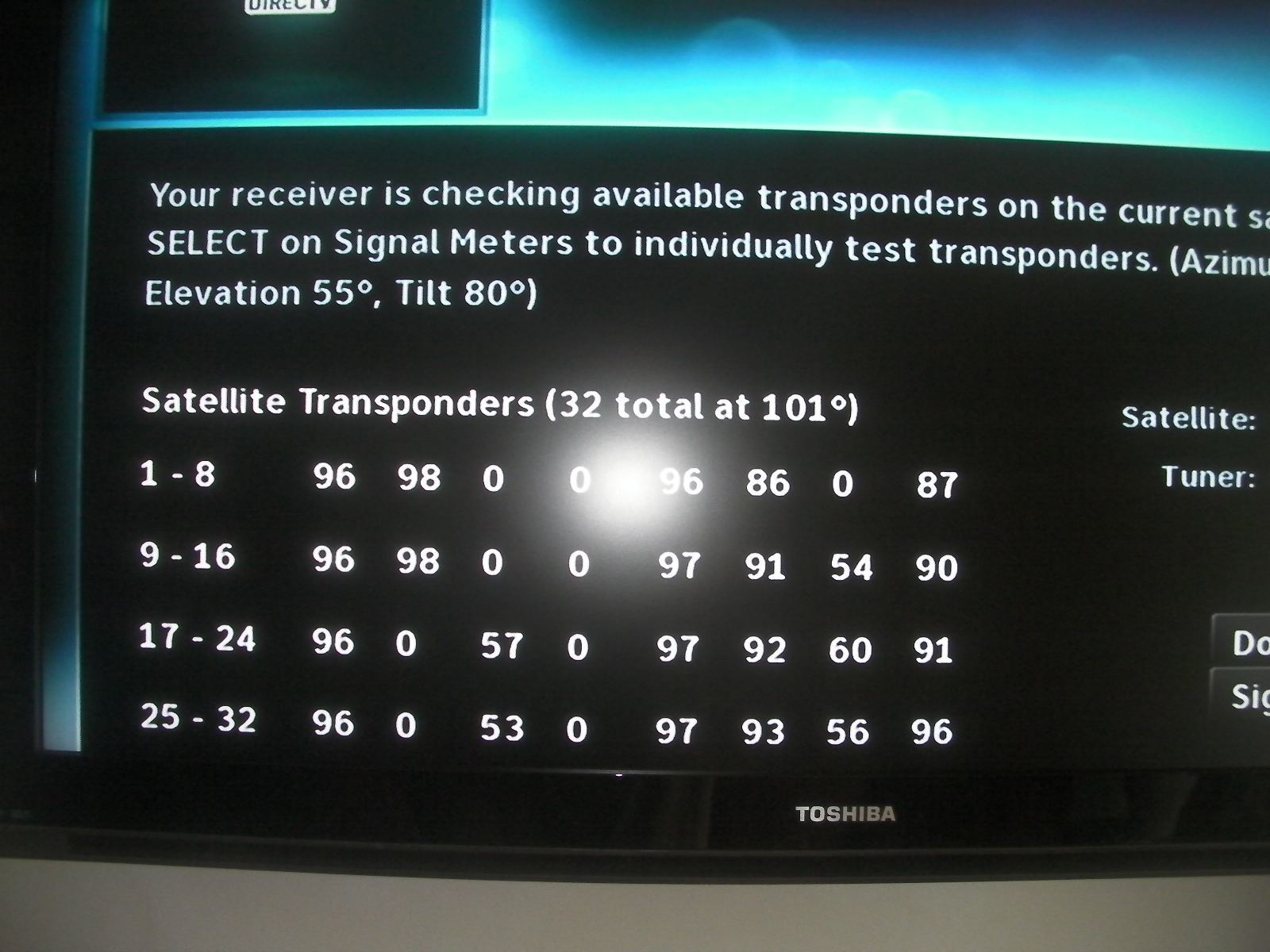

I am using an HR22 & SWM.
My receiver will only boot up completely between 8am and 3pm. The other times my receiver will get stuck at 98%, sometimes earlier. The boot-up green download will remain stuck all night until the last 2% finish around 8am.
If you look at my signals on 101W, the low signal transponders (in the 50s and 60s) disappear at night (go to zero) and come back the next morning.
Signal 50 seems the cut off for a lock-in for 101W; if they fall below 50 the HR22 shows 0 (zero) reception.
My other 15 year old non-HD receiver still shows sufficient signal on the low tps for a picture; all night. signal fall down to just 35 at night still providing pictures.
Unfortunately the HR22 cuts off on signals below 50 (for the 101W).
Strangely enough, for the 103W(ca) the receiver still locks with signals as low as 32.
