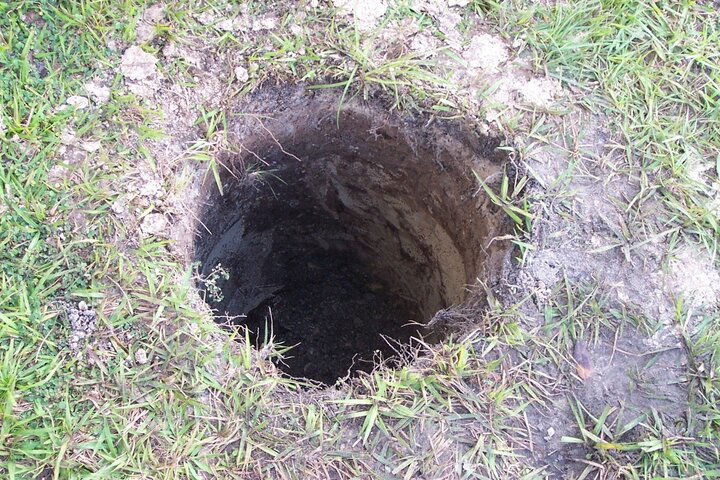

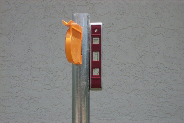

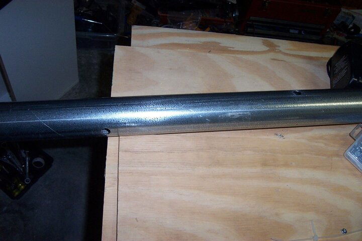

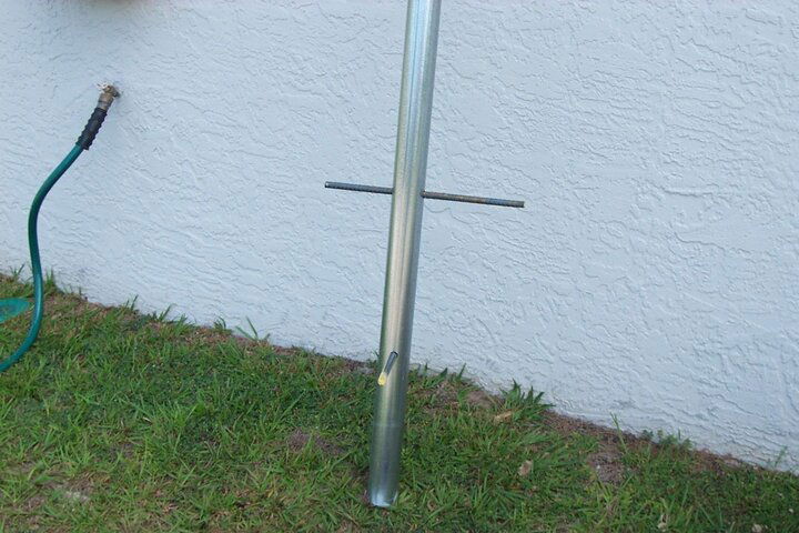

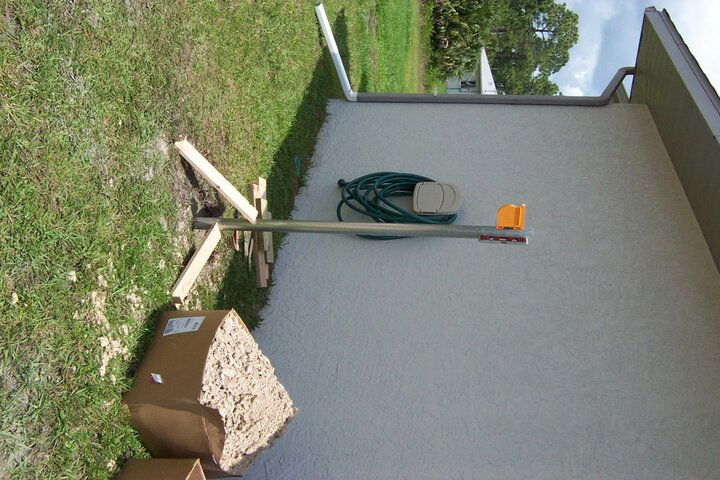

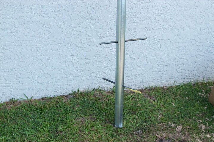

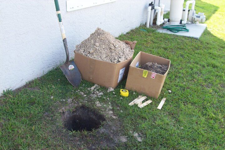

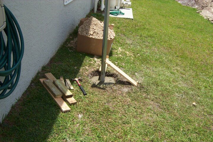

This morning I skipped church and went outside and dug myself a hole. :D

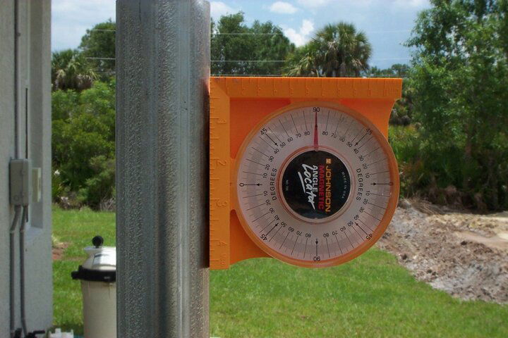

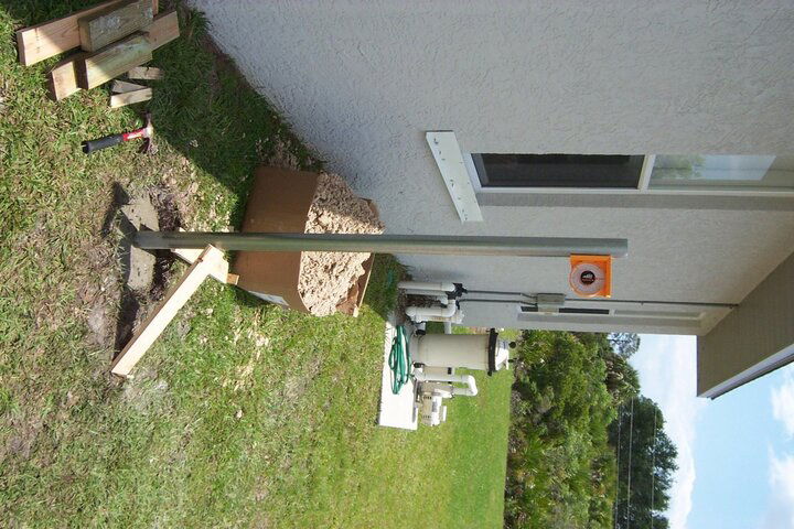

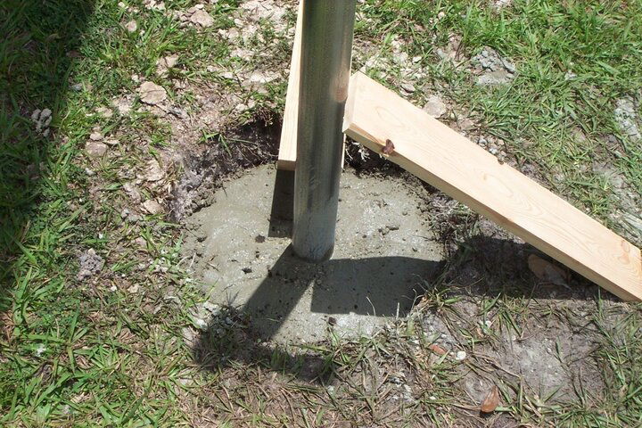

I dug the hole 3 feet deep by 16" in diameter. Then I added the rebar, planted the pole and filled the hole with 360 pounds of cement including the inside of the pole. Hopefully now it won't rain. :eek:
I'm trying to keep up with Shawn, but he's just too fast. :) Now it is time to paint my 1.2M Channel Master dish, create a mount and feed assembly, prime and paint the pole and install the RG-U cables in the attic.

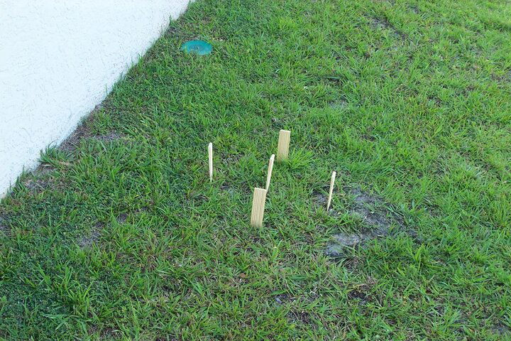

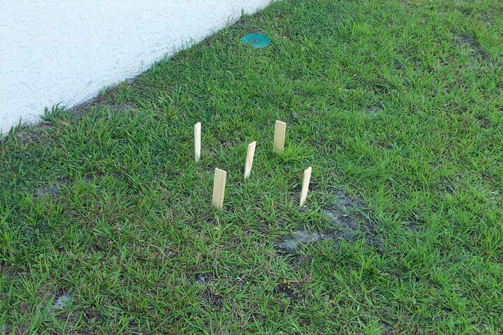

Dave, how far from your wall is the pole?
The reason I ask is if you're getting a motor and it swings the dish to far left/right you may foul the wall with the edge of the dish - I assume you're intelligent and measured it beforehand, just thought I'd throw that in :)
I one of the pics it looks liek the dish is pretty close to the wall but in another I can tell you've got plenty of room. I was sweating that with mine as well but witht he SG-2100 the dish just kind of twists. Even cranked way over to PAS 9 the dish itself doesn't portrude behind the pole much if at all.
Look'n good!
edit: I had to check after making the above statement. My pole could be dang near flush up against the wall without issue. It doesn't portude behind the pole AT ALL. The 1st pic is from the East and the other is from the South.
