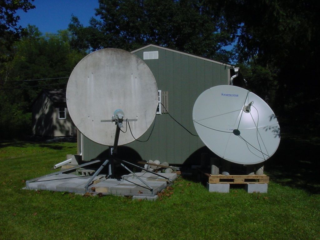

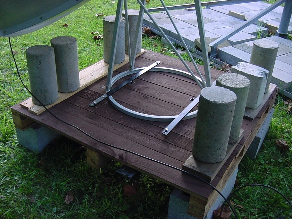

Back in 2009 I bolted my Fortec Star dish to a wood pallet and have had very good luck with it. I have moved it in various places in the yard.
The pallet is quite stable and is weighted down with some concrete pieces. Picture 011.jpg

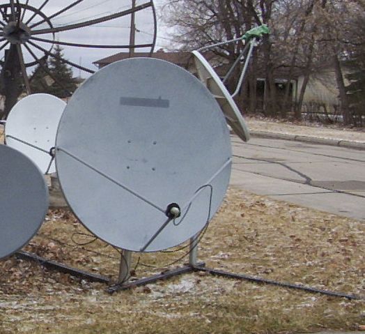

How about Telespar ? I've got a 1.2 and a 30 inch on a base fashioned from it. (Adjustalble - The "T" the pipes are welded to accept the horizontal legs and can be slid along the base)
Just for a 'gander', here's a pic where U can C it.
The poles are a chain link fence post for the 30 inch and a 3ft piece of truck exhaust pipe for the 1.2m.
I guess Telespar is a brand name, as is Unistrut. Don't know a generic name for it.

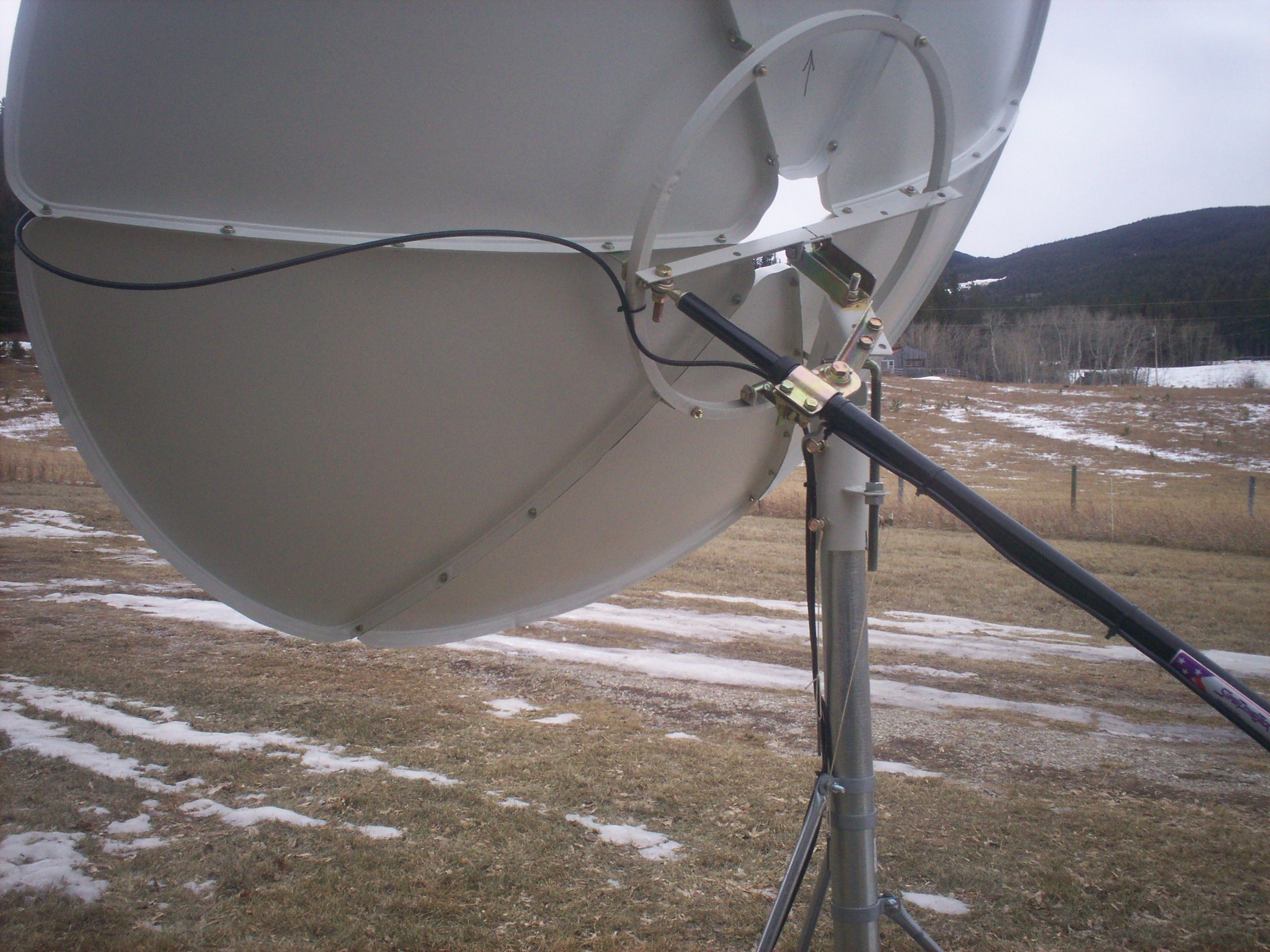

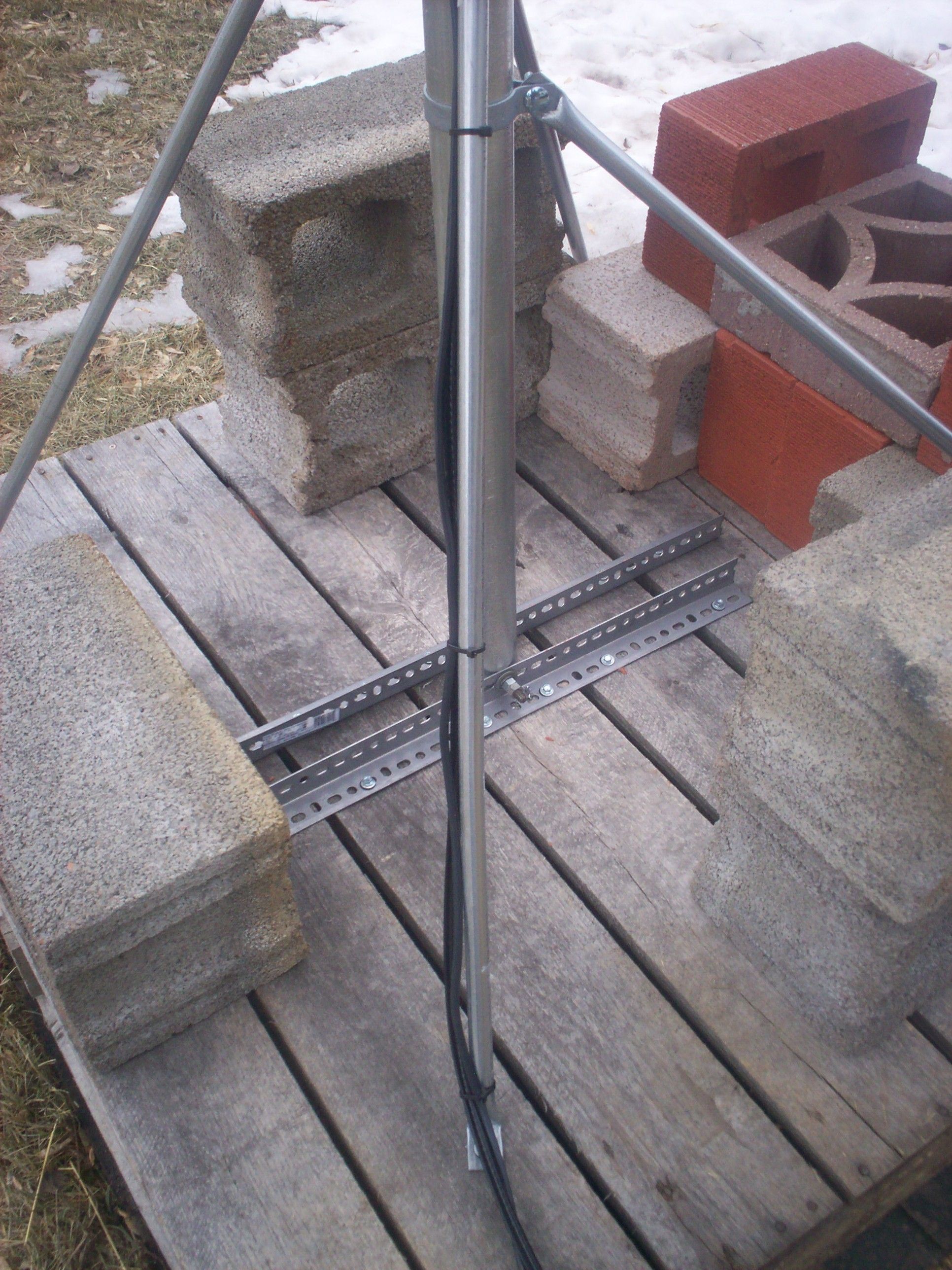

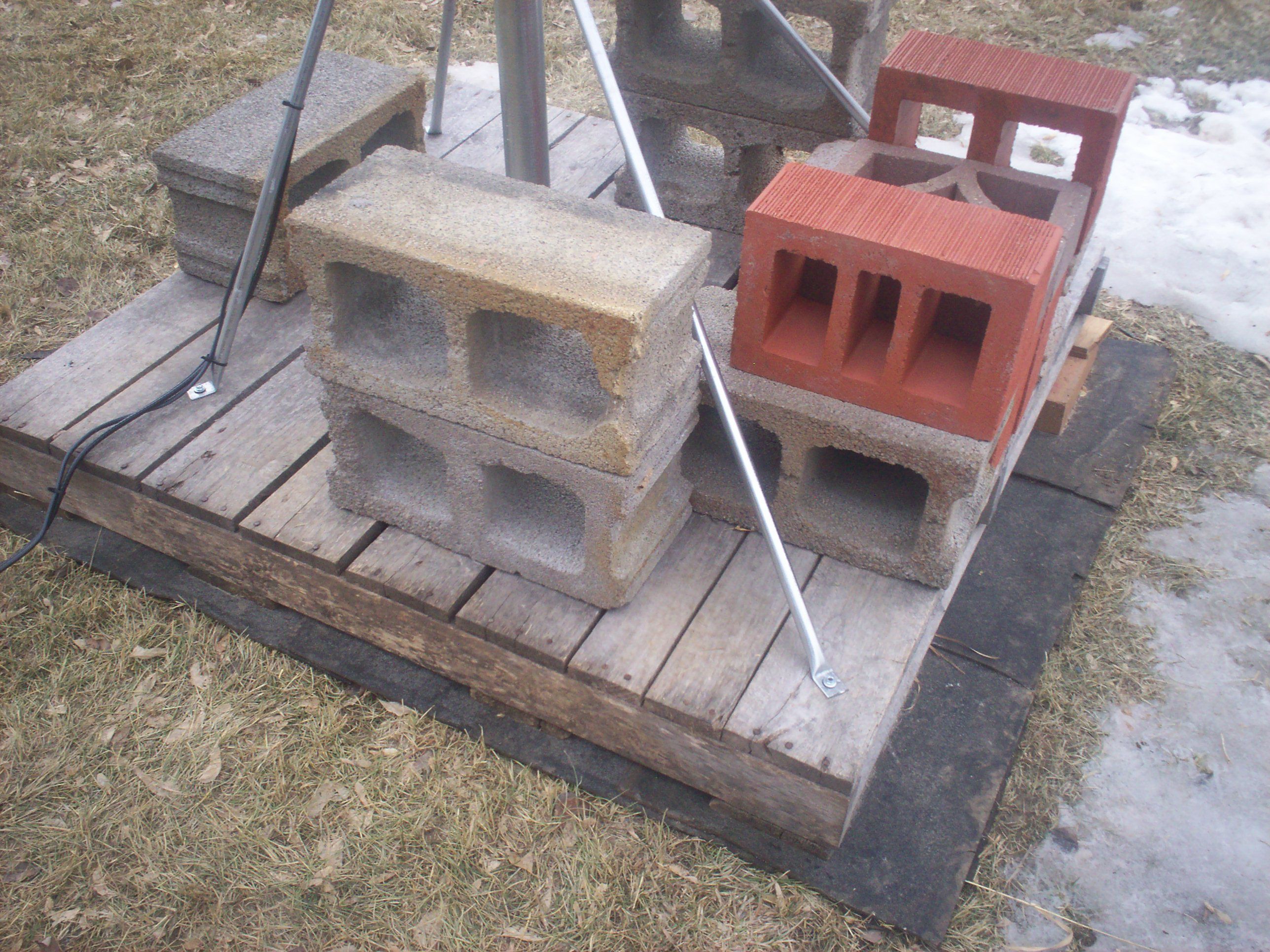

Here's a couple of photos of a temporary mount that I made.
Shingles on the ground keep the grass from growing. Pallet is reinforced with extra screws. Support arms made from conduit. Fence post for a pole.
The main difficulty was keeping the pole plumb since the mount was laid out on frozen ground and when spring came things shifted.

Excellent work papabruski.

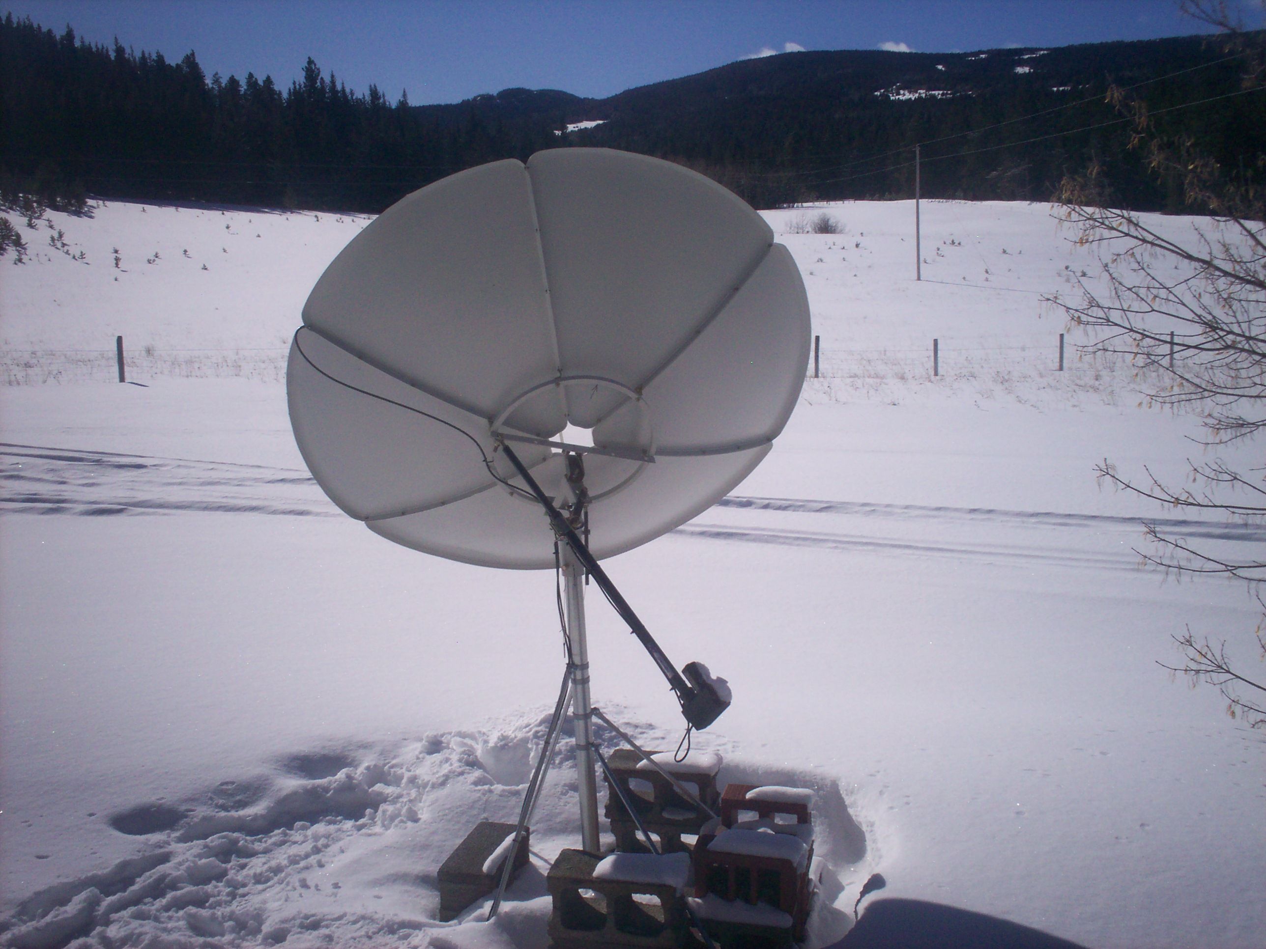

Can we see a photo of the whole setup from behind?
Here are a couple more shots. This was a temporary installation until a larger dish could be permanently installed elsewhere. Almost all of the information in setting it up was gleaned from this forum.
The dish is no longer installed and the mount now supports some solar panels which can be adjusted for elevation and azimuth with the motor so I can't show any current pictures.
I wore a path going to and fro doing adjustments and learned a good deal in the process. Fortunately, I had the time to invest.
