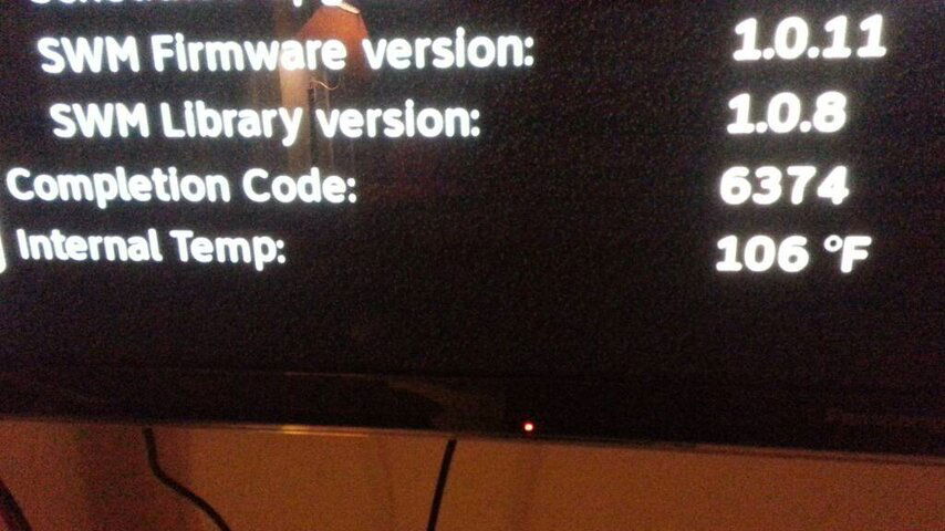

Mine is at 106f
Sent from my SPH-L900 using Tapatalk 2
