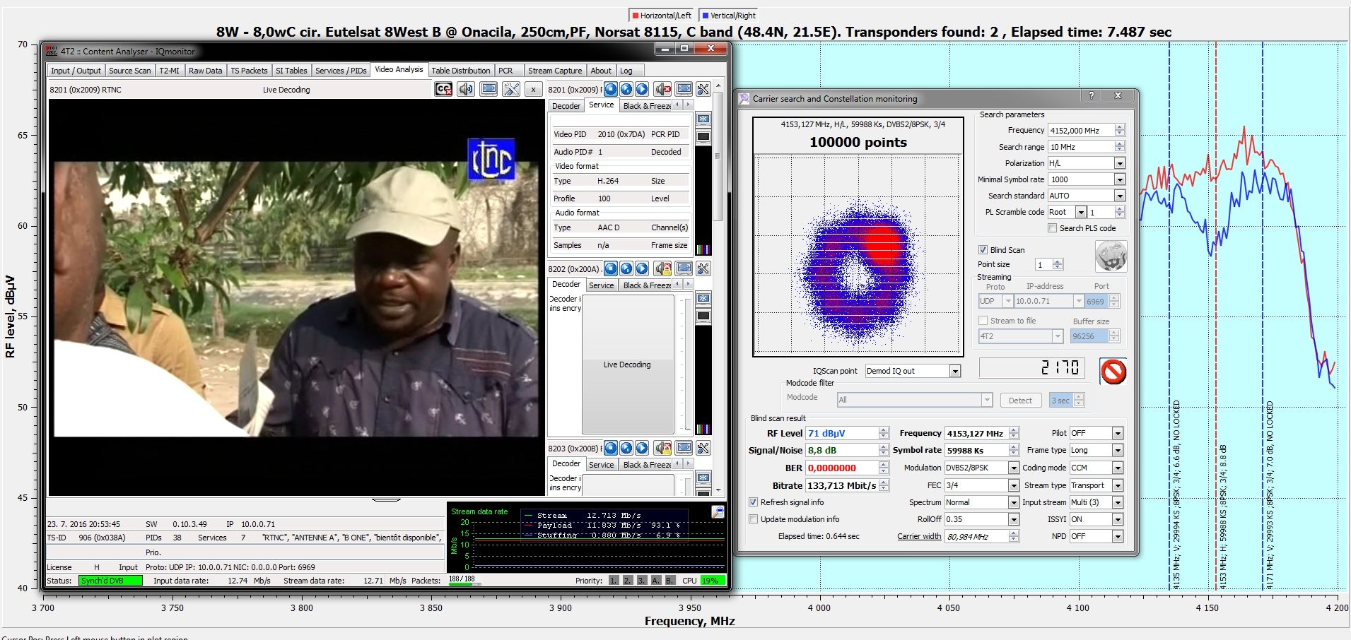

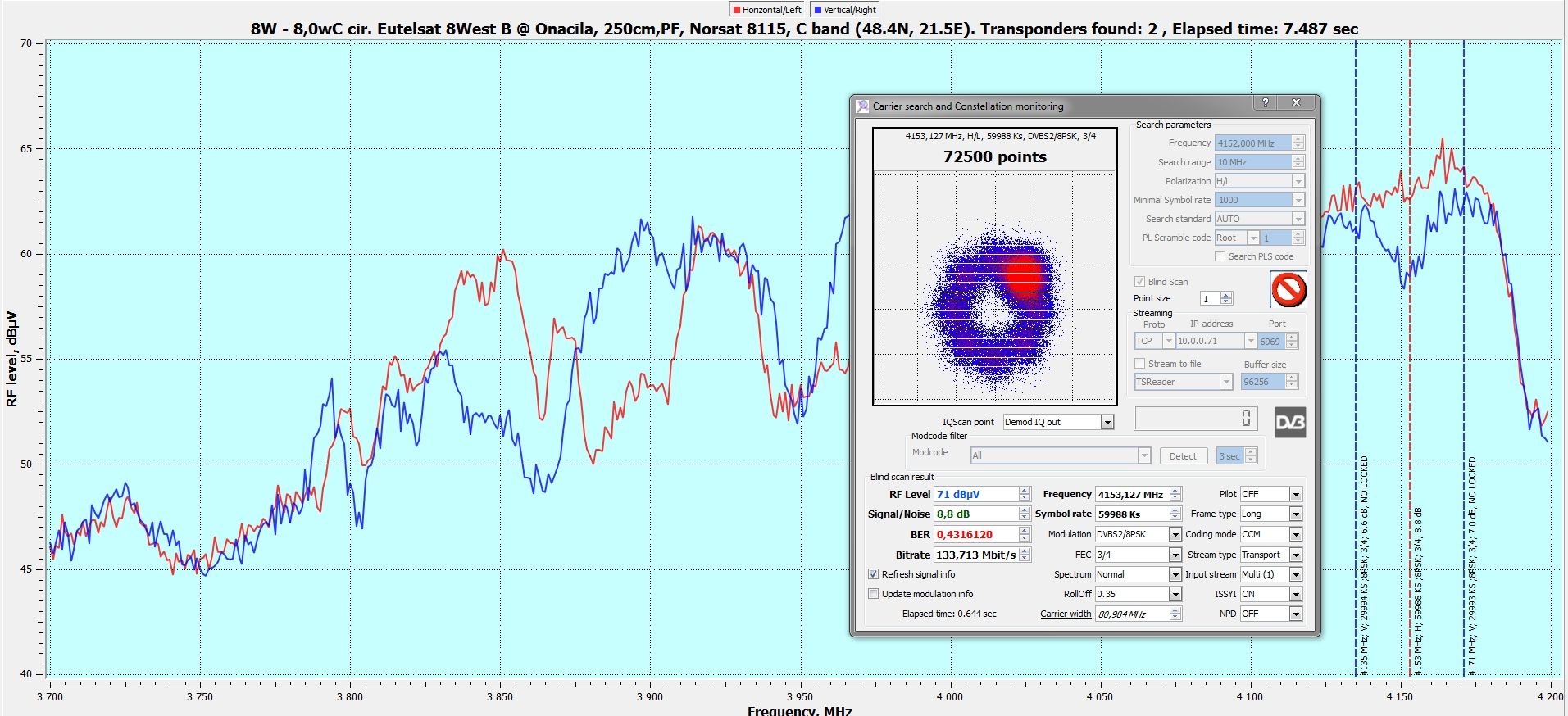

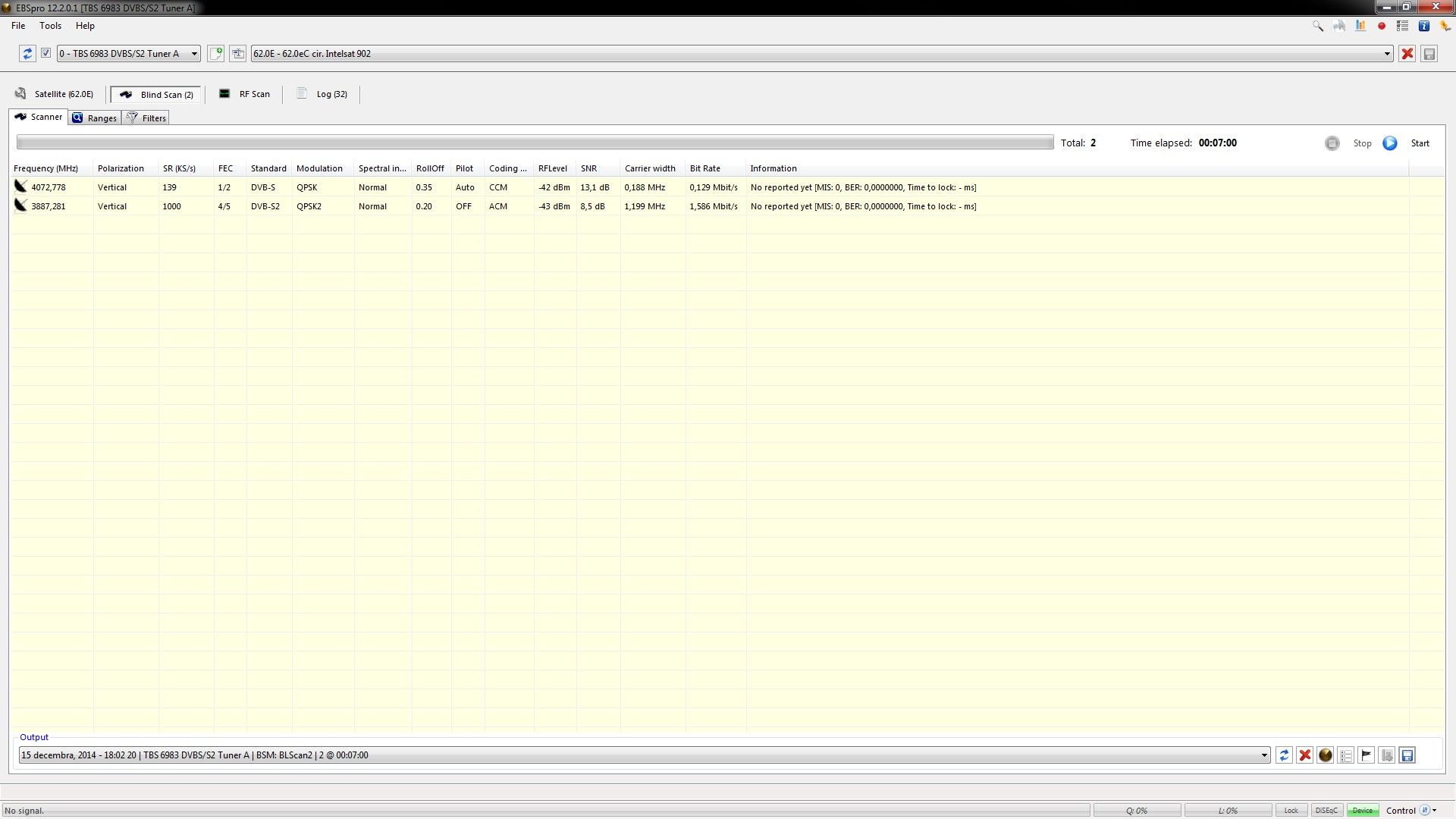

As hard core DXers I (Sato) and Peon (aka Onacila) decided to prove the TBS 6983 card`s capability on reception of the lowest and highest SR we can receive in Europe.
We test our hardware to the maximum on various bands as we can cover C (3.4-4.2 + 4.5-4.8 GHz), Ku (10.75-12.75 GHz) and Ka (18.2-22.2 GHz) plus X band (7.25-7.75 GHz hardware is ready).
Anyway, with TBS 6983 on Windows 7 (32 bit) the lowest SR we have been able to get so far is SR 128 and the highest is SR 60000 KS/s. Both stable and hassle free on a 2.5m prime focus dish by using XMW 9216HDF and NJR 2842S. SR 139 KS/s have been received in C band by using a Norsat 8115F LNB. I guess, these are current limits in orbit at the moment, but definitely not the TBS card`s! If there`s anything under or above those SRs, I`ll post screenshost here asap.
Additional details can be found on lyngsat.com or flysat.com where our and other DXers` updates are posted.
If there`s an approval of certain people we collaborate with, we can test TBS 6903 to the max, too.
Peon & Sato
Eutelsat 16A @ 16E 21564 H SR 128.jpg Intelsat 902 @ 62E 62E C-band low SR scan.jpg Eutelsat 8West B @ 8W 4153 LHCP SR 60000.jpg Eutelsat 8West B @ 8W 4153 LHCP SR 60000 Multistream + T2-MI.jpg

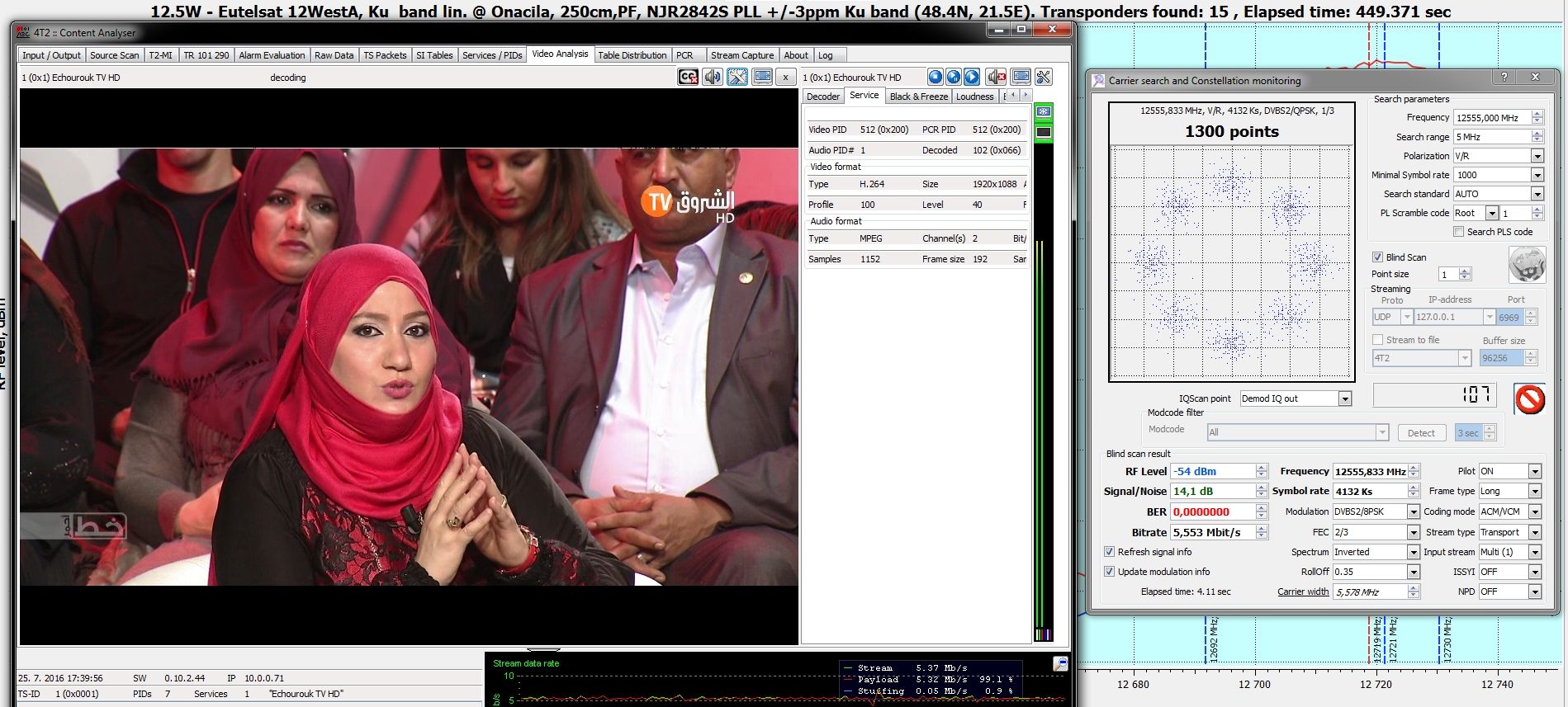

For now on I`d add a screenshot of Eutelsat 12 West A @ 12.5W - frequency 12555 V
This is very interesting because ACM VCM + Multistream are used together. It is not very common to see such combination as standart TVs usually broadcast in CCM (short for Coding mode) and ACM/VCM is used for data transmission when using 16 or 32 APSK modulation.
Reception was made by TBS 6983 card.
