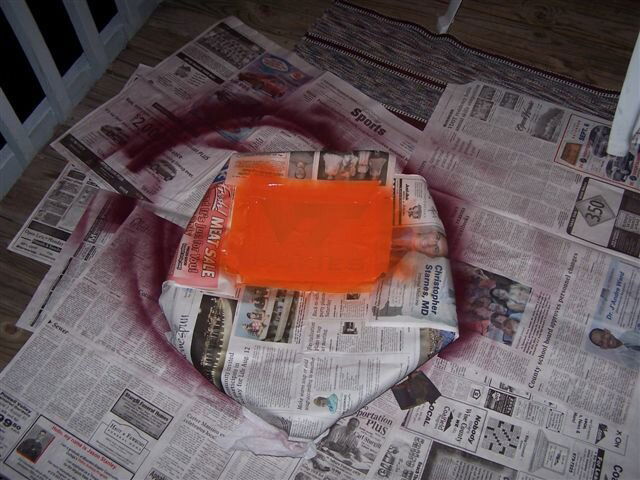

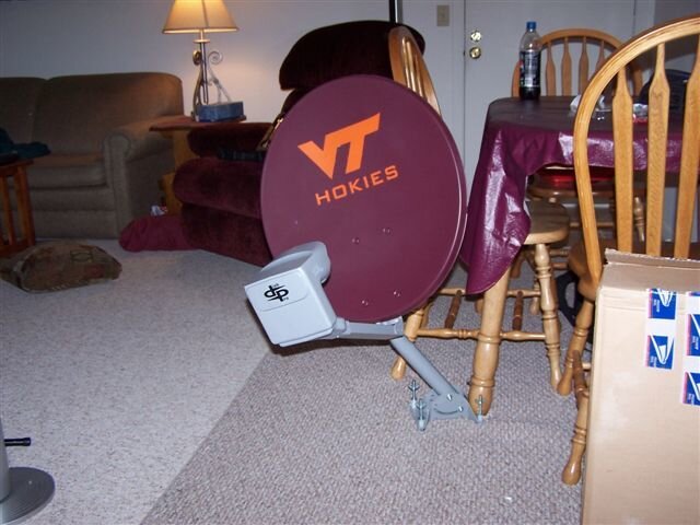

Lakebum: What type of paint did you use on your dish? I'm thinking about painting over the dish logo and putting up a VT logo. Did you do any prep work to the dish prior to painting?
I just used high gloss metal spray paint. No prep required. When doing a logo you have to think backwards. So for my dish I painted the whole middle of the Dish Orange and let it dry. Then I took a cutout of the "T" and stuck it to the dish in the place that I wanted the T. Then I sprayed The whole dish white - which left the orange T in place because I had the T covered.
Like this?
I just retired the 500 and painted up a 1000 last week for some ESPN Game Day in HD :D I guess ESPN is on 110 so that wasnt necessary.. but why not be prepared..I might need the ESPN2 or something.. I dont have any pics of the 1000 yet but I just used the same design. Painted the dish maroon... utilized photoshop for the VT logo and hokies... printed it on sticky back paper... cut the design out with an exacto, stuck it to the dish, sprayed it orange.. thats all.
