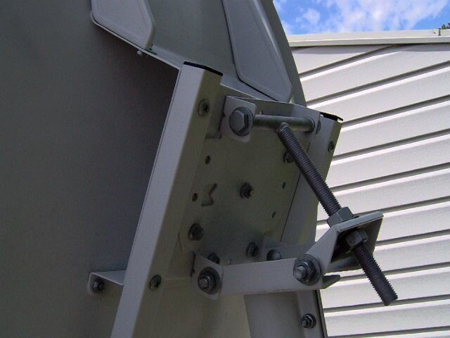

Would someone mind taking some closeup pics of the back of the T-90 dish? The top supports on the back are missing from my dish and I'd like to manufactor new supports for them.

The pics on that thread doesn't show the back of the dish. Also, the sandbag is blocking the support that I need to see/measure. I unfortunatly don't have camera to show what is missing on mine.
The top support is not needed. It was a pain in the ass to set that part up and then I found out its not needed

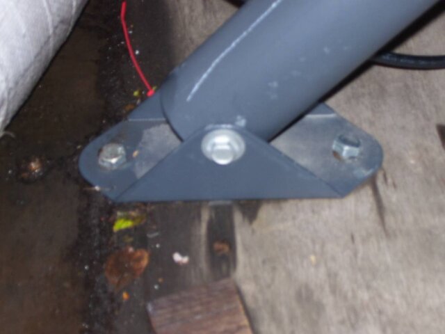

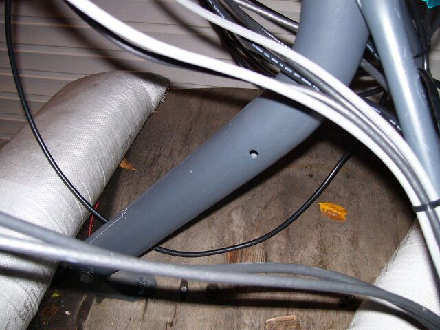

pics
1st you can kinda see those top brackets...like i say they're not needed
2nd pic is the foot...dimensions are
7" long
2 1/2"wide (mast is 2 1/2")
14" from bottom to the hole on the mast
18" to the elbow
both sides of mast are same so its 18", then elbow, then 18"

As far as the mast, I have the two parts shown on pic #2 (mast and foot). The mount also comes with two side support arms (have two for one dish; missing for the other T-90 i have) that connects to a seperate flat bar. That bar should mount to the roof, along with the foot shown in pic 2. Its that bar that I am missing.
Essentially, I won't need the mount bar if I am mounting to a pole, but I will when I place the dish on the roof (which I'd like to do before it gets too cold out)
