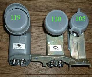

On the picture of the assembly I saw, there was a DP dual sitting out by itself, then it looked like 2 of them were in a bracket together. From the angle, I could only see 2 ports, from the 119 LNB, the ports for the FSS LNB must be on the other side, behind the metal bracket.
So I could connect the 105 LNB directly to the receiver.

I have a 121 superdish. On mine, the 119 is the "center" LNB with the 121 LNB to the left under the shroud. The 110 LNB is on the "arm" that sticks out to the side. I was under the impression that with the 105 superdish, it was the 105 LNB that got mounted off to the side on the arm and the 110 and 119 LNBs were under the shroud.
I've attached a picture below to show what webbydude is talking about. The 119 is a dual DP, 110 is a dual DP, and the 105 is a single FSS. Once completely assembled the shroud covers the 110 and 105 LNB's.

Sorry I dont have a pic at the moment, but the 121 superdish is a bit different. The 119 and 121 LNB's are so close together that they had to design a special LNB with a shared feedhorn. On the 121 LNB's only the 110 is a dual, the 119 and 121 are both single feed LNB's.
the pic that dishworks 222 has is of a SD type 1 dish. Channel master makes a Type 2 superdish. So there are 4 different superdishes a type 1 - 105 / type 2 - 121 / type 2 - 105 / type 2 - 121. The type2 105 dish has a 119 dp dual off to the side, a dbs dp stacked lnb with a feedhorn that has a pointy piece of plastic in front, and a fss dp stacked lnb with a wide feedhorn.
