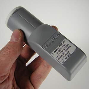

GEOSATpro KU LNBFs do have the 0 degree centering line molded into the top of the case, but not a square head.
In post #10 above, is a picture of the dual output SatAV LNBF.
It appears to be flat on top, back by the connectors.
I only have the original single-output models, which are sort of round, from end to end.
Pictures of both on this SatAV page.
edit:
My point was, if the SatAV dual-output LNBF actually is flat on top, then the OP could purchase those and be happy. - :up
Dual outputs is an extra bonus.
Yeah, that's what I'm talking about, GEOSATpro SL2 has flat top so it can be easily used for us that need a lot of skew.
The only thing missing on your LNB is that is not Universal, just Standard Linear KU.
We used to import an Universal version of the SL1 for North America market, but it sold about as good as Creamsicles in Antarctica.... Currently the Universal UL1 verion is OEM for European distribution only.
BTW.... The SL1 also has a flat horizontal 90 degree surface on the bottom.
Sorry, I didn't put two and two together on the observation. My bad! Thank you Anole!
Both the SL2 and the SL1 have flat horizontal surfaces at 90 degrees to the 0 degree line.
