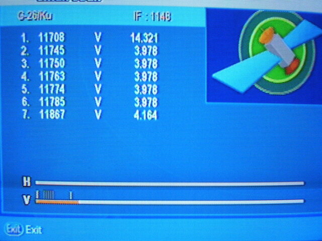

its the LNB that converts it depending on the correct LNB LO. If you've ever had a Pansat receiver when you blind scan it shows the IF frequency in the corner as it scans.
The receiver deals with the IF (L Band) frequency regardless. That is why if you have the wrong LNB LO you can still pick up channels (just at the "wrong" frequencies)
Ok that explains it, so when the pansat is doing its blind scan, its scanning in the Lband frequency and then converts the frequency based on the LNB LO, that gives it the proper band frequency (ka, KU ect) So, you can say that all satellite transmissions are in the Lband or in their retrospective bands.
Ok that explains it, so when the pansat is doing its blind scan, its scanning in the Lband frequency and then converts the frequency based on the LNB LO, that gives it the proper band frequency (ka, KU ect) .
correct. It scans the L-Band (as shown in the top of the pic below) and then shows the converted frequency
