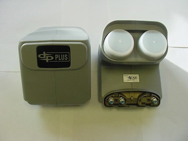

It looks like you have a Legacy Quad, which will not work with either the DP34 or DPP44.
Here's a couple of pictures I copied from "The DishStore" website at http://www.dishstore.net/index.php?cPath=40
Notice on the back it has a larger D and P to represent DishPro and the DishPro Plus also has a large D & P; both on a black background.
I could not find the backside of a Quad, either Legacy or DishPro, but I suspect the Legacy Quad only has a tag or plate that has Dish Network and then some specs, while the DishPro Quad is similar to the DishPro Twin above.:confused:
Maybe someone can confirm this.

It does look like you have a legacy quad, and as stated will not work with the 44. You will have to purchase a DP twin or 2 DP duals to get the job done.
